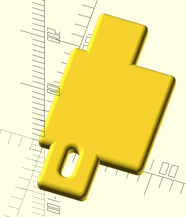

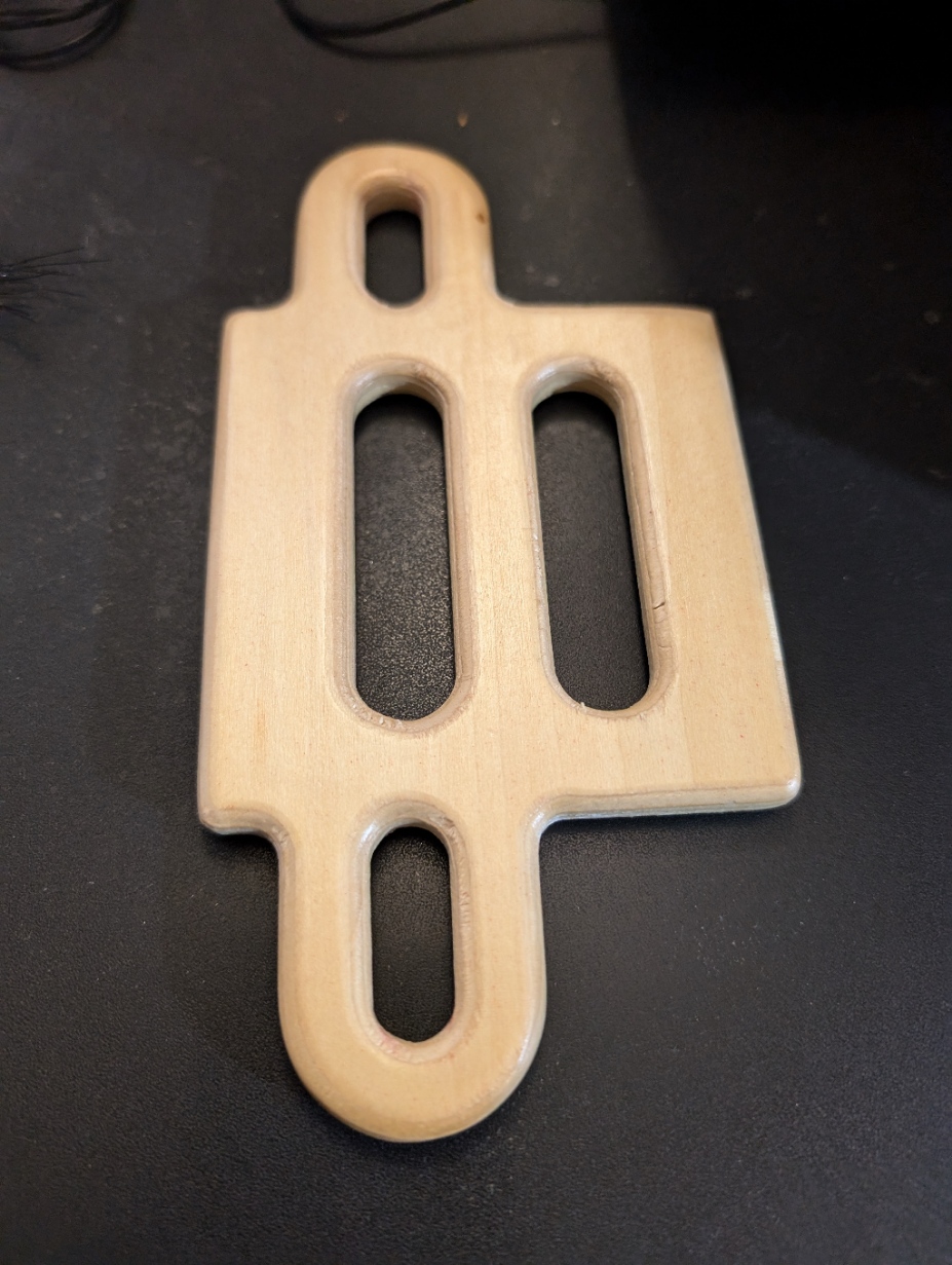

I am trying to create the following part but I am stuck on how you would create the inner bevels.  Any suggestions?
The first pic is what I am trying to make.

If it is a shape with  rounded chamfers that you want, like you show
below, then again Minkowski, but with a sphere. draw the shape smaller
by the radius of the sphere , holes, bigger by radius all around edge.
e.g., if it was a 50mm square, and 5mm thick, sphere would be d=5, and
square would be 2.5mm less on each side.

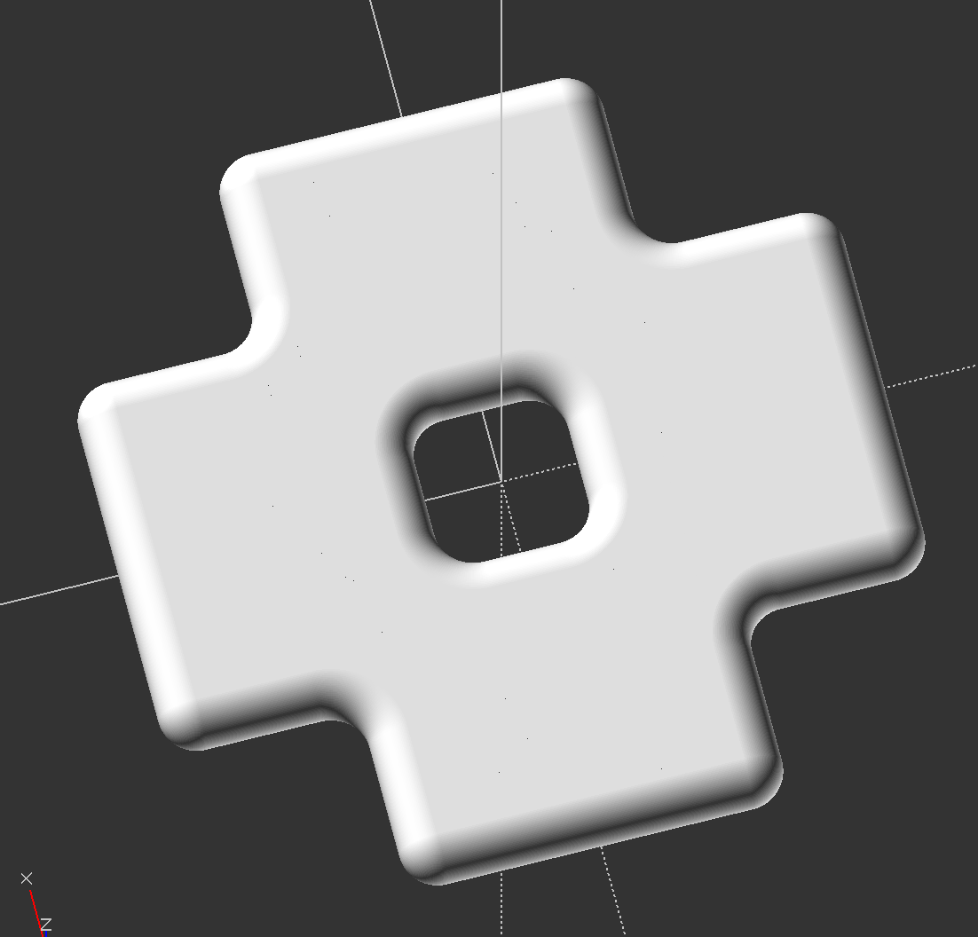

Thu, Aug 15, 2024 10:11 PM
It's definitely a work in progress but it is getting there.

The trick to getting those inner corners is that the minkowki'd shape should have rounded inner-corners. If you start from 2d, it's easy to get those (and compensate for the added width from minkowski at the same time) by offsetting your original shape inward by the same radius. Example:
$fs = .2;
$fa = 2;
thickness = 10.0001;
radius = 5;
module shape() difference() {
square([100, 50], center = true);
square([50, 100], center = true);
square(20, center = true);
minkowski() {
linear_extrude(thickness - radius * 2, center = true) offset(-radius) shape();
sphere(radius);
If you ALSO want the sharpest part of those corners to be rounded like the photo, just offset it outward a little first. The back-and-forth offsetting technique is great for rounding internal and external corners (depending on the order) in 2d shapes. Example:

There has been a lot of detailed discussion, but little in the way of general discussion of the problem.
There are three basic approaches:
Create a 2D shape with holes, extrude it, and somehow (probably with Minkowski) round the corners.
Create a 3D shape, and a shape that you want removed, and difference the two.
Create the entire shape as a polyhedron, with the rounding designed in.
Minkowski can be really slow, so I generally don’t consider it. Also, it might be tricky to restrict its effect to the edges that you want rounded.
Creating a polyhedron is very very powerful and can be very very hard.  I think BOSL2 might have the tools required to create a polyhedron like this, but I’m not familiar enough to be sure. Maybe Adrian can chime in there.
I would personally think in terms of the second option, subtracting the unwanted shape from the original shape.
Constructing the negative shape can be complex, but is generally straightforward even if tedious. For your oval slots, start with two cylinders joined by a cube.
