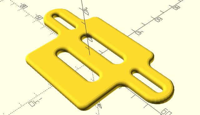

Minkowski isn't nearly as slow as it used to be. For reference, the one I showed took 30 seconds to render (using a recent nightly build running on an M1 Mac). I've done this kind of job using complicated negative shapes constructed using cylinders, spheres, rotate_extrude, etc., but not only are methods using hull(), offset(), and (when necessary) minkowski easier to read, but the extra rendering time is nothing compared to the extra design time to make it the old fashioned way.
With the method I showed, you can develop your shape in 2d (with instant previewing) until all of the dimensions are correct, then wait to add (or to activate) the minkowski part until you think everything else is finished.

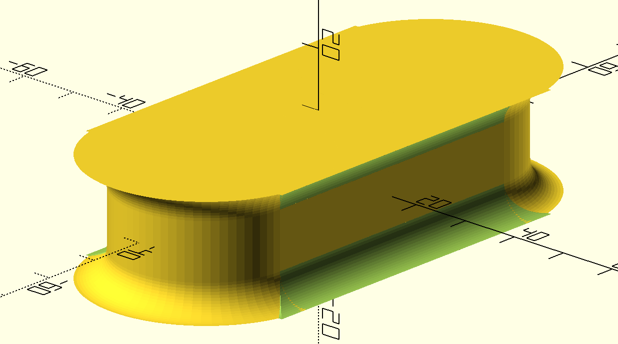

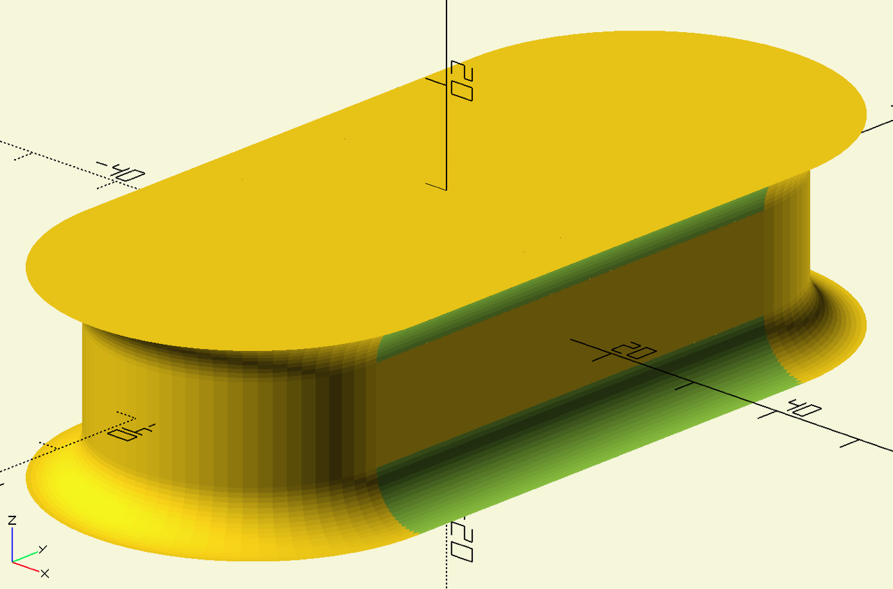

My previous example, is additive, i.e, have a basic shape and add on
fillets, etc. That means, if you are wanting to deal with the overall
size, which is generally true, than the radius has to be taken off the
outside edges, and added to internal edges.
For shapes such as have been shown, then simple maths suffices, but more
complex shapes offset can be used. But Minkowski can be slow, as you
say, certainly at high resolution and complex profiles. The rounded
chamfers are the problem.  For more basic shapes, boxes, etc., then I
generate a profile strip and difference with the edges. A question of
finding the best solution for a particular problem, one size does not
fit all, so to speak.
You can generate a profile, the negative of a sphere, and generate
'holes' in shapes such that when differenced will leave a rounded edge.
I've attached a bit of code. The advantage is that no maths is needed to
subtract the radius. The disadvantage is that Minkowski is much slower
with the complex profile,  overall it is cumbersome, and often it breaks
the mesh when differencing.

Yes, the size issue is interesting.  I think what you said earlier about
reducing my size by the radius seems to be working.  Originally my part was
created with Bols2 using the 3d library.  I could not find a way to get the
inner rounded edges.  I have now switched to Bols2 2D and the Minkowski as
suggested but wow is it ever slow.  I increased my facets to 90 and my part
has been compiling for at least 30 minutes.  I want to do a test print of
the first few layers to make sure the size is right.  Interesting that you
suggested using two cylinders and a cube for the inside.  I did the same
using 2 circles and a square in 2d then extruding.
My part is almost complete.  I would like to share the code to see what
others would suggest in the future.  I always welcome a better way.  Is
anyone interested in seeing it?
 on fillets, etc. That means, if you are wanting to deal with the
 overall size, which is generally true, than the radius has to be
 taken off the outside edges, and added to internal edges.
 but more complex shapes offset can be used. But Minkowski can be
 slow, as you say, certainly at high resolution and complex
 profiles. The rounded chamfers are the problem.  For more basic
 shapes, boxes, etc., then I generate a profile strip and
 difference with the edges. A question of finding the best solution
 for a particular problem, one size does not fit all, so to speak.
 edge. I've attached a bit of code. The advantage is that no maths
 is needed to subtract the radius. The disadvantage is that
 Minkowski is much slower with the complex profile,  overall it is
 cumbersome, and often it breaks the mesh when differencing.
 The way in which I believe most folk think wrt rounding edges, is
 that you start off with square edges, and remove the sharp edges.
 Bare openscad can not do that easily. However there are plenty of
 other software tools that can. In reality, it is often more
 expedient  to mechanically finish the object, files, emery-cloth,
 whatever. Possibly a woodworker would think differently, since
 they often glue on mouldings.

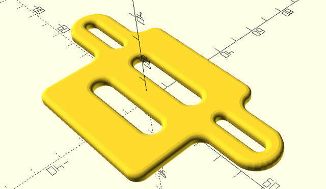

You might want to take a look at https://learn.cadhub.xyz/docs/round-anything/api-reference/#polyround
The library can round a path with square corners with variable radii. For this, you add the radius as the z coordinate in a 3vec. It can then extrude this path with a radius at the end. For the outer component you can use a positive radius for the under and top side. You can then make the inner shapes the same way and subtract them. However, you can then make the radii of the ends negative, which leaves a nice round shape.
The library could use some love. If your path contains undef it will hang ... :-( (Surprised OpenSCAD does not run the rendering in a background thread?) This is the function of the val() routine, to check this.
The quickly hacked together code.
use <lib/Round-Anything/polyround.scad>
$fn=50;
function val(p) = [for(i=p) assert( ! (is_undef(i.x) || is_undef(i.y)|| is_undef(i.y)))];
rect=[60,60];
round=[140,20];
a = 20;
     -rect.x/2            rect.x/2
        a----------------b            rect.y/2
  m-----n                c-----d      round.y
l+                                + e
k-----j                g-----f      0
i----------------h            -rect.y/2
                0
l = -rect.x/2;
r = -l;
t = rect.y/2;
b = -t;
path = [
[l,  t,  5], // a
[r,  t,  5], // b
[r,  round.y,  5], // c
[round.x/2-round.y,  round.y,  5], // d
[round.x/2,          round.y/2,  round.y], // e
[round.x/2-round.y,  0,  round.y], // f
[r,  0,  5], // g
[r,  b,  5], // h
[l,  b,  5], // i
[l,  0,  5], // j
[-round.x/2+round.y,  0,  5], // k
[-round.x/2,  round.y/2,  round.y], // l
[-round.x/2+round.y,  round.y,  round.y], // m
[l,  round.y, 5], // n
function exclude( w, h ) = let(
adj = h/2,
path = [
[-w/2,0,adj],
[-w/2+adj,h/2,adj],
[w/2-adj,h/2,adj],
[w/2,0,adj],
[w/2-adj,-h/2,adj],
[-w/2+adj,-h/2,adj],
) path;
x=val(path);
polyRoundExtrude(path,r1=2, r2=2);
translate([-round.x/2+30,10,0]) polyRoundExtrude(exclude(25,5),r1=-2, r2=-2);
translate([round.x/2-30,10,0]) polyRoundExtrude(exclude(25,5),r1=-2, r2=-2);
translate([0,10,0]) polyRoundExtrude(exclude(40,8),r1=-2, r2=-2);
translate([0,-10,0]) polyRoundExtrude(exclude(40,8),r1=-2, r2=-2);
On 16 Aug 2024, at 15:45, Raymond West via Discuss discuss@lists.openscad.org wrote:

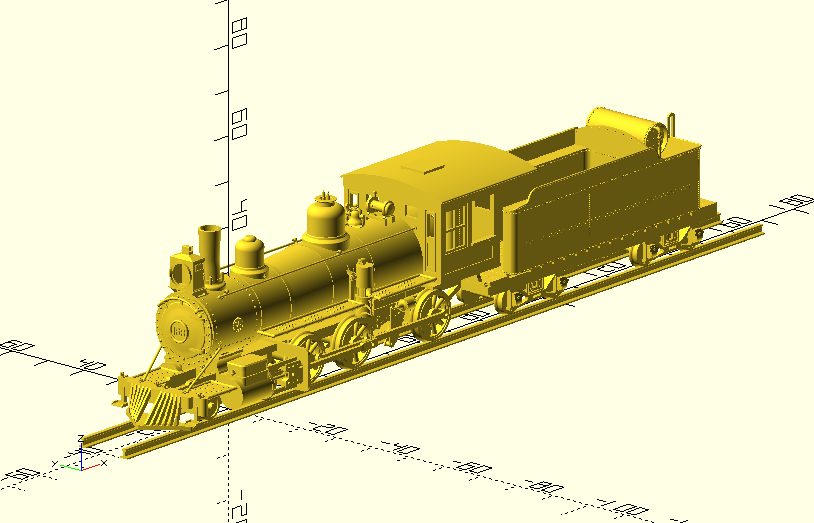

Oh, I love Round-Anything's polyRound() module...
I modeled a complete steam locomotive with it, using it 83 times to make
the rounded shapes 1880's steam locomotive designers so loved:

With BOSL2 you can make an interior rounding mask using negative radius roundings. For example: cuboid([30,50,20], rounding=-5); ycopies(50) cyl(d=30,h=20,rounding=-5);  I do note that there seems to be a slight imperfection to the mask, though. - Revar > On Aug 16, 2024, at 5:46 AM, Michael Zimbaro via Discuss <discuss@lists.openscad.org> wrote: > > Yes, the size issue is interesting. I think what you said earlier about reducing my size by the radius seems to be working. Originally my part was created with Bols2 using the 3d library. I could not find a way to get the inner rounded edges. I have now switched to Bols2 2D and the Minkowski as suggested but wow is it ever slow. I increased my facets to 90 and my part has been compiling for at least 30 minutes. I want to do a test print of the first few layers to make sure the size is right. Interesting that you suggested using two cylinders and a cube for the inside. I did the same using 2 circles and a square in 2d then extruding. > > My part is almost complete. I would like to share the code to see what others would suggest in the future. I always welcome a better way. Is anyone interested in seeing it? > > On Fri, Aug 16, 2024 at 8:19 AM Raymond West via Discuss <discuss@lists.openscad.org <mailto:discuss@lists.openscad.org>> wrote: >> My previous example, is additive, i.e, have a basic shape and add on fillets, etc. That means, if you are wanting to deal with the overall size, which is generally true, than the radius has to be taken off the outside edges, and added to internal edges. >> >> For shapes such as have been shown, then simple maths suffices, but more complex shapes offset can be used. But Minkowski can be slow, as you say, certainly at high resolution and complex profiles. The rounded chamfers are the problem. For more basic shapes, boxes, etc., then I generate a profile strip and difference with the edges. A question of finding the best solution for a particular problem, one size does not fit all, so to speak. >> >> You can generate a profile, the negative of a sphere, and generate 'holes' in shapes such that when differenced will leave a rounded edge. I've attached a bit of code. The advantage is that no maths is needed to subtract the radius. The disadvantage is that Minkowski is much slower with the complex profile, overall it is cumbersome, and often it breaks the mesh when differencing. >> >> The way in which I believe most folk think wrt rounding edges, is that you start off with square edges, and remove the sharp edges. Bare openscad can not do that easily. However there are plenty of other software tools that can. In reality, it is often more expedient to mechanically finish the object, files, emery-cloth, whatever. Possibly a woodworker would think differently, since they often glue on mouldings. >> >> d=10; >> $fn=80; >> module profile(){ >> rotate_extrude(){ >> difference(){ >> translate([-d/2,0]) >> square(d); >> translate([0.01+d/2,d/2]) >> circle(d=d); >> translate([-d-d,0]) //cut off lhs >> square(d+d); >> } >> } >> } >> >> // profile(); >> >> module shape(){ >> linear_extrude(0.001){ >> difference(){ >> square (100); >> translate([25,25]) square(50); >> } >> } >> } >> module stamp(){ >> minkowski(){ >> shape(); >> profile(); >> } >> } >> >> stamp(); >> >> >> >> On 15/08/2024 23:49, Jordan Brown via Discuss wrote: >>> There has been a lot of detailed discussion, but little in the way of general discussion of the problem. >>> >>> There are three basic approaches: >>> Create a 2D shape with holes, extrude it, and somehow (probably with Minkowski) round the corners. >>> Create a 3D shape, and a shape that you want removed, and difference the two. >>> Create the entire shape as a polyhedron, with the rounding designed in. >>> Minkowski can be really slow, so I generally don’t consider it. Also, it might be tricky to restrict its effect to the edges that you want rounded. >>> >>> Creating a polyhedron is very very powerful and can be very very hard. I think BOSL2 might have the tools required to create a polyhedron like this, but I’m not familiar enough to be sure. Maybe Adrian can chime in there. >>> >>> I would personally think in terms of the second option, subtracting the unwanted shape from the original shape. >>> >>> Constructing the negative shape can be complex, but is generally straightforward even if tedious. For your oval slots, start with two cylinders joined by a cube. >>> >>> I’m on my iPad so can’t experiment, but something like >>> >>> difference() { >>> cube([50,50,10], center=true); >>> translate([-10,0,0]) cylinder(h=11, d=10, center=true); >>> translate([10,0,0]) cylinder(h=11, d=10, center=true); >>> cube([20,10,11], center=true); >>> } >>> >>> That gets you a straight-sided slot. Sculpt it as desired by subtracting stuff from the negative piece. Note, for instance, that a cylinder is a rotationally-extruded square, so if you want round edges at the ends you might take a square, subtract a circle along one edge, and rotationally extrude that. Similarly, the cube in the middle is an extruded square, so take a square, subtract circles on each side, and extrude that. However you construct it, when you have your negative “die”, subtract it from the main object. Always remember to make the negative object a little thicker than the original, so that it protrudes from both sides. >>> >>> If there is interest, I’ll write up a demo snippet in a few days when I get back to my desktop computer. >>> >>> >>> _______________________________________________ >>> OpenSCAD mailing list >>> To unsubscribe send an email to discuss-leave@lists.openscad.org <mailto:discuss-leave@lists.openscad.org> >> _______________________________________________ >> OpenSCAD mailing list >> To unsubscribe send an email to discuss-leave@lists.openscad.org <mailto:discuss-leave@lists.openscad.org> > _______________________________________________ > OpenSCAD mailing list > To unsubscribe send an email to discuss-leave@lists.openscad.org
Sat, Aug 17, 2024 8:49 AM
Actually, the imperfection was user error.  I forgot to specify edges="Y" in the cuboid():
$fn=72;
cuboid([30,50,20], edges="Y", rounding=-5);
  • Revar
<Screenshot 2024-08-17 at 1.10.44 AM.png>

On 16 Aug 2024, at 23:27, Glenn Butcher via Discuss discuss@lists.openscad.org wrote:
I modeled a complete steam locomotive with it, using it 83 times to make the rounded shapes 1880's steam locomotive designers so loved:
<integration-_2024-06-24.png>
<PastedGraphic-1.png>
$fn=50;
rect=[60,60];
round=[140,20];
a = 20;
      -rect.x/2            rect.x/2
l+                                + e
   k-----j                g-----f      0
                 0
l = -rect.x/2;
r = -l;
t = rect.y/2;
b = -t;
path = [
[l,  t,  5], // a
[r,  t,  5], // b
[r,  0,  5], // g
[r,  b,  5], // h
[l,  b,  5], // i
[l,  0,  5], // j
adj = h/2,
path = [
[-w/2,0,adj],
[-w/2+adj,h/2,adj],
[w/2-adj,h/2,adj],
[w/2,0,adj],
[w/2-adj,-h/2,adj],
) path;
x=val(path);
On 16 Aug 2024, at 15:45, Raymond West via Discuss discuss@lists.openscad.org mailto:discuss@lists.openscad.org wrote:

[image: PastedGraphic-1.png]
you can set $fn =20 for testing, see if it looks OK. Minkowski is then
fairly quick. When you have it looking right, then set $fn to 100, say, for
the final stl, and come back after lunch.
If it is only an stl that you want, it used to be you could feed the scad
file into AngelCad, and it used to produce an stl quite quickly. I'm not
sure if openscad has caught up wrt speed, or even if AngelCAD accepts
minkowski.  Freecad can also import scad files and render. It allows
individual edges to be selected for filleting. It tends to export back to
openscad as a large polyhedron, you lose the individual cubes and
cylinders, etc.  fwiw, bevels are better for printing, not round-overs.

d=10;
$fn=80;
module profile(){
rotate_extrude(){
translate([-d/2,0])
square(d);
circle(d=d);
square(d+d);
//  profile();
module shape(){
square (100);
module stamp(){
minkowski(){
shape();
profile();
stamp();
