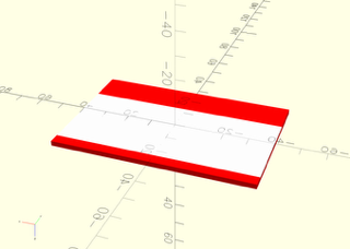

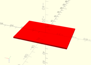

I am using OpenSCAD 2026.02.13 on a Mac.
I am designing a name tag similar to the familiar “Hello my name is” ones to be 3D printed. I've reduced the code to show the anomaly. The white color bar is designed to be printed on the bottom (the printer build plate).
white_height = 0.6;
b = [80,55,2];
top_bar = 15;
bottom_bar = 5;
eps = 0.001;
module base()
translate([0,0,b.z / 2])
cube(b, center=true);
module bar()
translate([0,(bottom_bar - top_bar) / 2, white_height / 2 - eps])
cube([b.x + 1, b.y - bottom_bar - top_bar + 1, white_height], center=true);
color("white")
intersection()
base();
bar();
color("red")
base();
bar();
When previewed, the white color does not show up. When rendered, it does and the exported .3mf file prints as desired.

Tue, May 12, 2026 5:33 PM
Hi Mark,
It is not an anomaly. f5 render was meant to be quicker, (it is if you
use f6 as cgal, for a large file, not so much if you use manifold). It
is two different rendering engines. f5 using OpenGL, afaik, was for
quick preview, since cgal is very thorough and therefore slow. In any
case, you can only export an f6 render. Also, booleans and colours are
'interesting'.

Tue, May 12, 2026 5:42 PM
The result of the intersection is that volume that is in both the base
and the bar.  Since the small slice of the bar that extends below Z=0 is
not in the base, it's not included, negating part of the advantage of
that +epsilon slice.
In theory, you've then got a white piece that exactly matches the cutout
from the red piece.
The previewer simply hates coincident faces, even if they are faces that
have been cut away.  The bottom (cut away) red face of the base is
coincident with the (intersected) white bottom of the bar.  It doesn't
particularly surprise me that something bad happens.
I say "in theory", because the intersection itself is black magic; I
don't know how it actually works.
Slapping a render() in front of either the intersection() or the
difference(), or both, makes the problem go away.
My experiments with multi-color models with invisibly coincident faces
suggest that liberally applying render(), inside the color(), is helpful.
