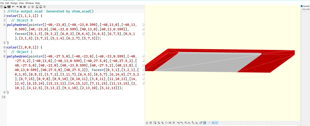

Hi Jordan,
 I did not notice the wedged shape of the white slab. I do not see that
the difference in the two renders as anomalies, but I see it as an
anomaly, if the expectation is that the white shape would be cubic, (but
when using numbers near the limits, of fp accuracy in openscad/whatever,
who knows?)
I translated the openscad code into my software, and it works exactly I
would expect, no wedge. I think, the error in openscad, is due to it not
sensibly handling vertices, with small differences. If you difference a
shape, and intersect the shape, there is no guarantee that the vertices
match at the common face. Altering the eps, in the original openscad
code, alters the direction of the angle. I may export the stl from
openscad, and try and see what the mesh is doing.
I've attached the output of my cad as a ply file, also my code (with the
scad commented out), just to show the numbers are the same.(but syntax
different.)

I haven't tried the code, but if it is an epsilon issue, your epsilon is
too small. I use 0.05.

When you do the intersection the eps bit is removed because it is
outside the other shape. All the bottom surfaces are then coincident.
is too small. I use 0.05.
It is an epsilon issue.  It is not that the epsilon is too small.  Set
it to 0.5 and see that the problem remains.
The issue is exactly as nophead says:  the intersection removes the
"epsilon" slice, making the two faces coincident.
