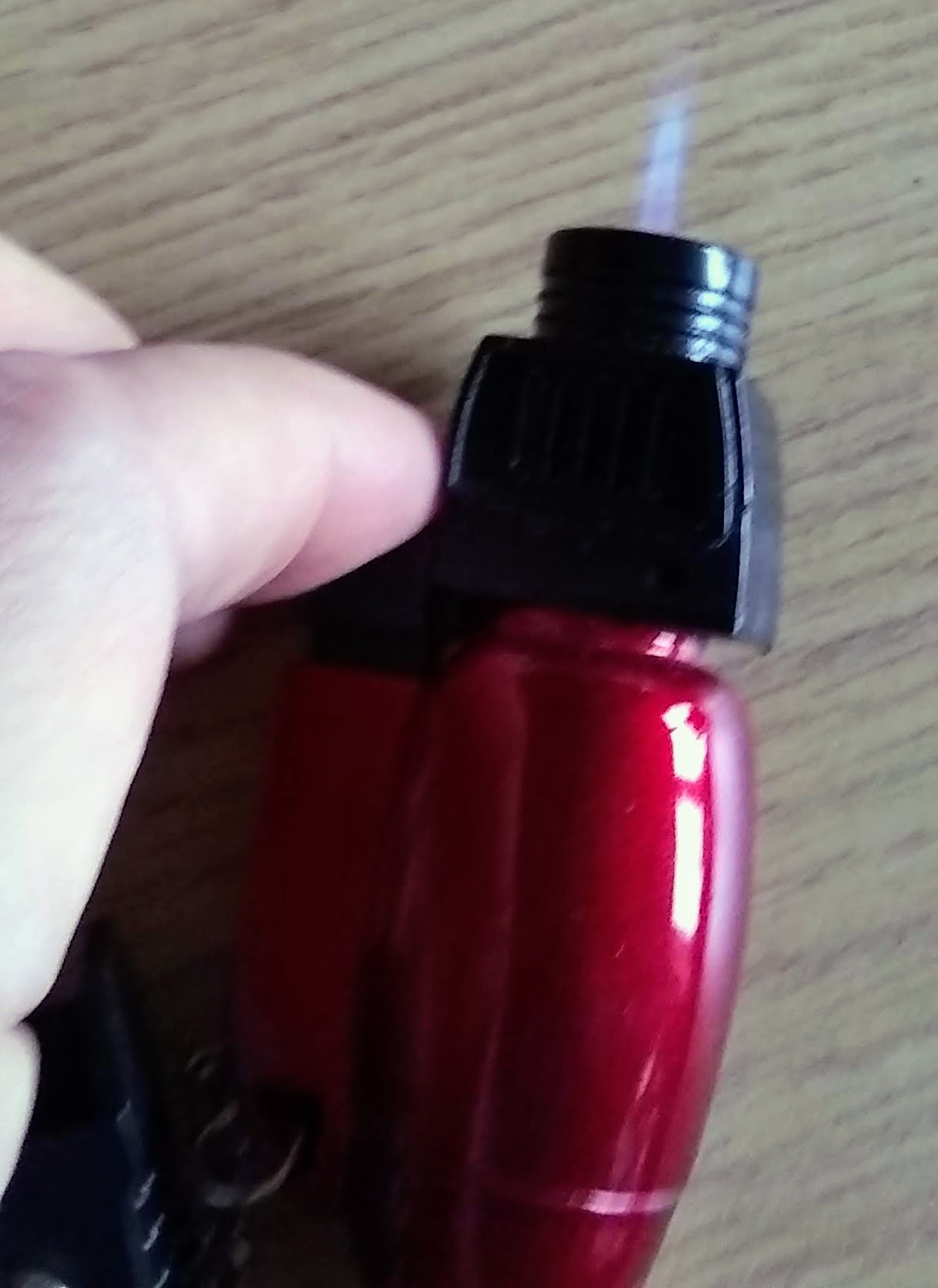

I use this tiny blowtorch:
[image: IMG_20210705_105737372.jpg]
Plastic has a high specific heat capacity, so if you run it over the part
quickly it doesn't do any damage but the tiny hairs have so little mass
they instantly vaporise.

Not sure if you know, but hair like strings can be removed easily with a
flame.
I thought you were going to show a tiny flame-thrower next to your nozzle.
