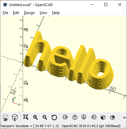

Tue, Feb 18, 2020 6:54 PM
On 2/18/2020 5:02 AM, adrianv wrote:
But if you really want to pursue V-groove text, it seems like what's needed is the modify the text with offset().
Ah!  You're right!
John, here's something for you to play with.
res = 2;    // Levels per unit height
slope=0.2;  // Units out per vertical unit
size=20;    // Height of font
height=10;  // Height of extruded letters
levels = height * res;
for (i=[0:levels-1]) {
    linear_extrude(height=(height-i/res))
        offset((i/res)*slope)
        text("hello", size=size);
On 2/18/2020 5:02 AM, adrianv wrote: > But if you really want to pursue V-groove text, it seems like what's needed is the modify the text with offset(). Ah!  You're right! John, here's something for you to play with. res = 2; // Levels per unit height slope=0.2; // Units out per vertical unit size=20; // Height of font height=10; // Height of extruded letters levels = height * res; for (i=[0:levels-1]) { linear_extrude(height=(height-i/res)) offset((i/res)*slope) text("hello", size=size); }

Tue, Feb 18, 2020 7:29 PM

Tue, Feb 18, 2020 7:39 PM
On 18 Feb 2020 at 13:10, Lee A wrote:
I have wanted to play with something similar. The issue is this will be
read from the bottom, so each letter has to be flipped over. If you just
rotate the slope goes the wrong way. So how do you make the letter
appear backwards?
Just add a rotate() before the text.
rotate([180,0,0])
On 18 Feb 2020 at 13:10, Lee A wrote: > I have wanted to play with something similar. The issue is this will be > read from the bottom, so each letter has to be flipped over. If you just > rotate the slope goes the wrong way. So how do you make the letter > appear backwards? Just add a rotate() before the text. res = 2; // Levels per unit height slope=0.2; // Units out per vertical unit size=20; // Height of font height=10; // Height of extruded letters levels = height * res; for (i=[0:levels-1]) { linear_extrude(height=(height-i/res)) offset((i/res)*slope) rotate([180,0,0]) text("hello", size=size); }
