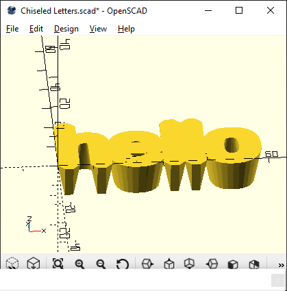

I have wanted to play with something similar. The issue is this will be
read from the bottom, so each letter has to be flipped over. If you just
rotate the slope goes the wrong way. So how do you make the letter
appear backwards?
Just add a rotate() before the text.
res = 2;    // Levels per unit height
slope=0.2;  // Units out per vertical unit
size=20;    // Height of font
height=10;  // Height of extruded letters
levels = height * res;
for (i=[0:levels-1]) {
linear_extrude(height=(height-i/res))
offset((i/res)*slope)
rotate([180,0,0])
text("hello", size=size);

On 2/18/2020 12:01 PM, A. Craig West wrote:
I usually scale by -1 in the appropriate dimension for things like this
The manual specifically warns against negative scales.
https://en.wikibooks.org/wiki/OpenSCAD_User_Manual/Transformations#scale
Note: Do not use negative scale values. Negative scale values appear
to work for previews, but they lead to unpredictable errors when
rendering through CGAL. Use the mirror() function instead.
And indeed, sticking a "mirror" on the front does the right thing.
mirror([0,0,1]) {
Although the shape produced is the same, I'd prefer this to rotating the
text, for two reasons:
1)  The result is readable.  Yes, you'd then want to rotate it to put it
on the bottom, but you could also use it on the top or some other
surface, with more obvious transformations.
2)  text() yields a 2D object.  Rotating a 2D object around X or Y, so
that it comes out of the Z=0 plane, seems ... wrong.  It seems like it
yields an object that is in some sense no longer 2D.  Yes, it ends up
back at Z=0, but it seems like an incorrect operation to perform on a 2D
object.

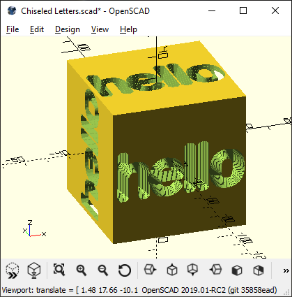

Here's an example of using this pattern on all sides of a cube:
slope=0.15;  // Units out per vertical unit
epsilon = 0.01;
module engrave(t) {
    mirror([0,0,1]) {
                text(t, size=size, halign="center", valign="center");
    cube(60, center=true);
    translate([0,0,30+epsilon]) engrave("hello");
    translate([0,30+epsilon,0]) rotate([-90,0,0]) engrave("hello");
    translate([0,-(30+epsilon),0]) rotate([90,0,0]) engrave("hello");
    translate([30+epsilon,0,0]) rotate([0,90,0]) engrave("hello");
    translate([-(30+epsilon),0,0]) rotate([0,-90,0]) engrave("hello");
    translate([0,0,-(30+epsilon)]) rotate([180,0,0]) engrave("hello");
Note:  that was very slow to display in preview, and took almost 17
minutes to render.  I haven't tried to figure out exactly why.
