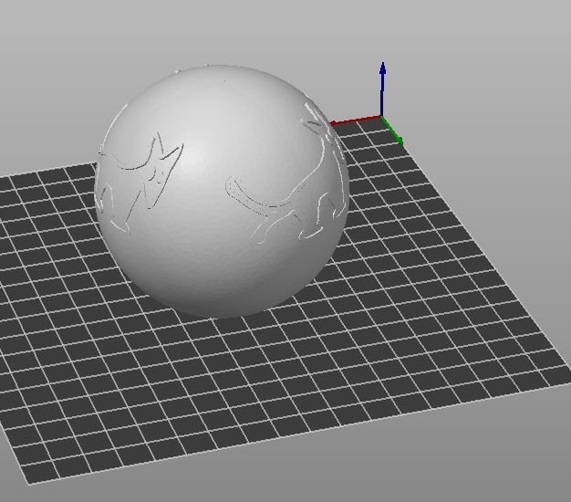

I would like to design a lithophane sphere with several graphic elements
on it.
I have not yet found a solution in Openscad that would support drawing
images onto a spherical surface.
Which library can be used to solve this?
Either by using one image once, or by using one image several times
(rotated by 120 degrees), or by using several images at 120 degrees or
randomly placed.
A tutorial on solving such a task would also be good.
Thanks!

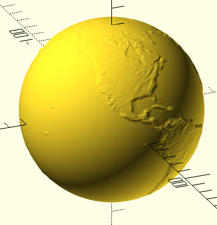

In the BOSL2 library, you can put a texture on a hemicircle using rotate_sweep().  You can convert an image to a heightmap texture using https://github.com/BelfrySCAD/BOSL2/blob/master/scripts/img2tex.py https://github.com/BelfrySCAD/BOSL2/blob/master/scripts/img2.py
For example:
And then in your scadfile:
include <worldmap.scad>
hemi = [for (phi=[90:-1:-90]) polar_to_xy(50,phi)];
rotate_sweep(hemi, closed=false, texture=worldmap, tex_reps=[1,1]);
Resulting in:

It looks nice, but that is because the world map was based on a sphere
to start with. For an original  flat image (a photographic lithphane,
say) it would need to be distorted into a shape that looked right on a
spherical surface, and if that were done it would only 'look right' from
one viewpoint. Of course, it may be not a necessity for it to look right
as a few distinct lithophanes, but maybe as an embossed pattern. Maybe
we are trying to solve an xy problem - again. However, it is feasible
with BOS2L to map images to a spherical surface, as you've shown.

Unfortunately, it doesn't quite do what I want. :(
The goal is 3 separate images placed 120 degrees apart. See the attached files.
The script you specified stretches the image to entire surface.
Unfortunately, it doesn't quite do what I want. :( The goal is 3 separate images placed 120 degrees apart. See the attached files. The script you specified stretches the image to entire surface.

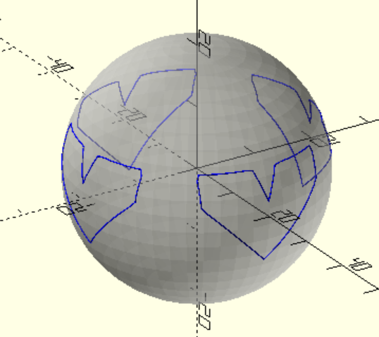

Is this what you are looking for?

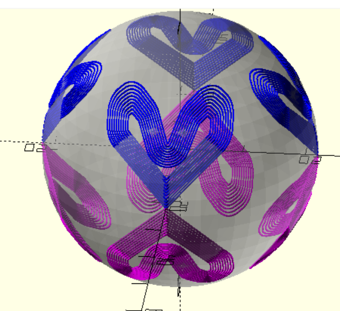

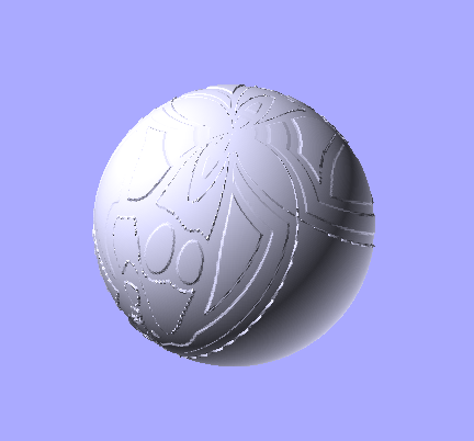

May be something like this would be more interesting:
This is done finding the intersecting lines between a sphere a solid
you can download the file from here:
https://github.com/sprabhakar2006/openSCAD/blob/main/sphere_with_art.scad
May be something like this would be more interesting: This is done finding the intersecting lines between a sphere a solid you can download the file from here: https://github.com/sprabhakar2006/openSCAD/blob/main/sphere_with_art.scad [image: image.png]
