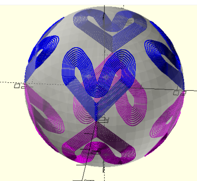

May be something like this would be more interesting:
This is done finding the intersecting lines between a sphere a solid
you can download the file from here:
https://github.com/sprabhakar2006/openSCAD/blob/main/sphere_with_art.scad

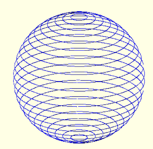

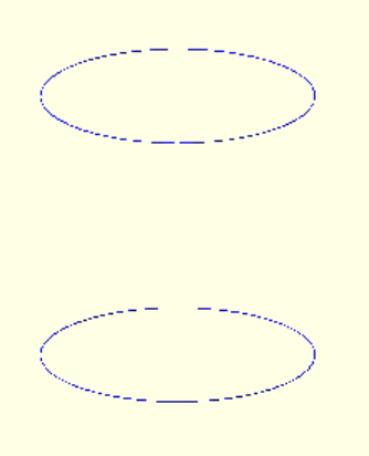

coming to the point of finding intersection line:
  • 1st step is to create shapes with defined coordinate points in space and
    not through openscad primitives.
  • once the shapes are defined with points in space, then there are a lot of
    possibilities to manipulate these points.
example:
a cylinder is 2 circle placed one above another
a sphere is multiple circles with varying diameters which are placed one
above another and so on.

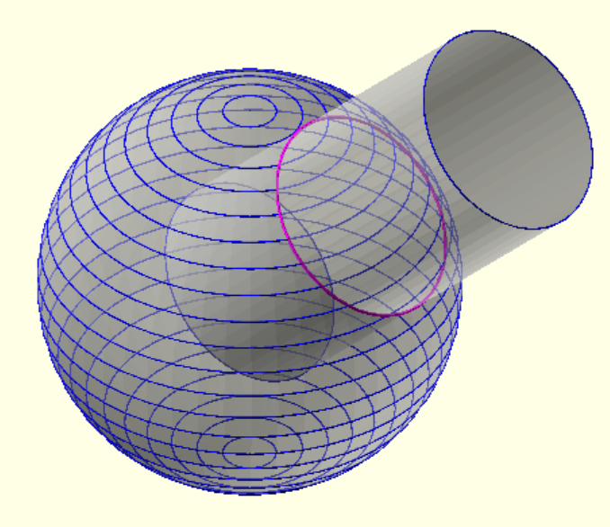

now to find intersection line between 2 solids say 's1' and 'c1' (for
sphere and cylinder respectively)
there is a function:
ip_sol2sol(s1,c1)  => see magenta line in below fig.
I have written a lot of documentation on these processes and functions
which you can find here (In case you are interested):
https://github.com/sprabhakar2006/openSCAD/blob/main/explanation%20of%20approaches/examples_of_various_functions.pdf

Sun, Mar 31, 2024 1:57 PM
I have made a youtube video as to how to project a sketch on to a surface
https://youtu.be/UvUdfEuQWQc
