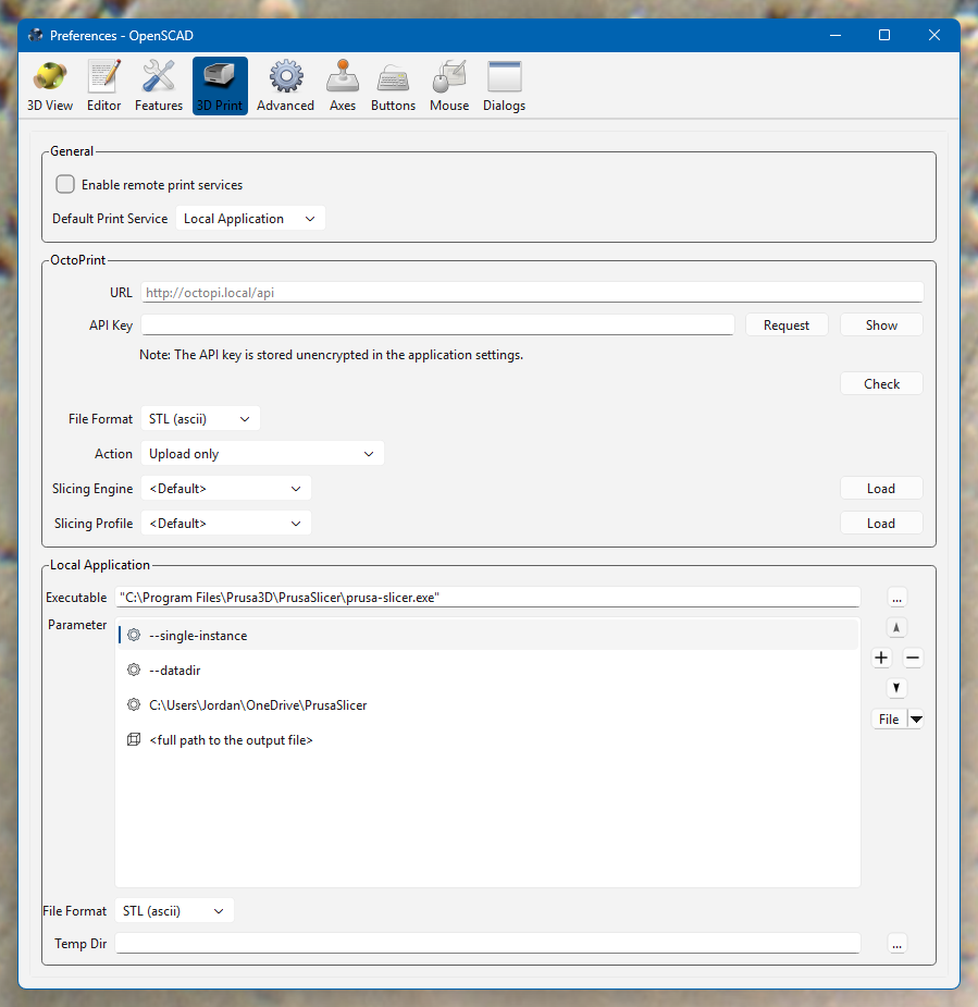

It's Design / 3D Print.  You configure what it does with Edit /
Preferences / 3D Print.
That lets you configure a connection to OctoPrint (a local 3D print
server) or a couple of commercial services, or a local application.
Using a local application requires that you know how to invoke the local
application to get the results you want (hence my original question).
Here's my configuration:

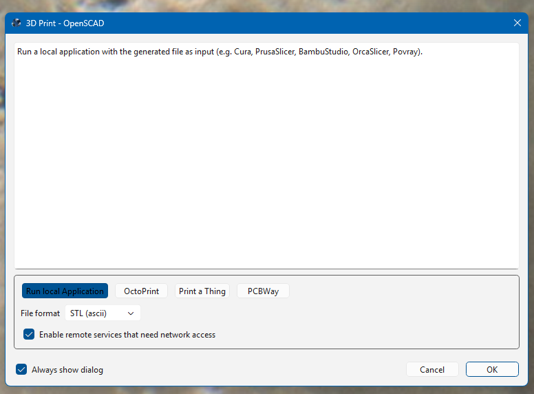

When you punch F8 it pops a dialog that confirms what you want to do and
allows you to select other options:
Unchecking that "Always show dialog" checkbox bypasses this dialog in
the future; you can restore it at Edit/Preferences/Dialogs.
Note:  checking the "Enable remote services" box in the confirmation
dialog appears to have immediate effect; checking it in the Preferences
dialog seems to require restarting the application to get them to appear
in the menu.
