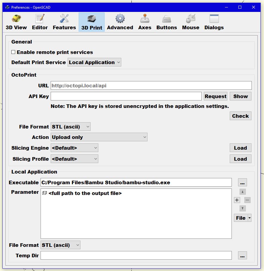

I took a look at the preferences but I'm unsure of how to configure it.
I tell it to use Bambu Studio, which opens when I hit F8, but it's
blank. I think I need to configure parameters and mayb more stuff.

Wed, Mar 4, 2026 12:02 PM
Larry, I use bambu labs slicer, so I attached a snapshot of my setup for F8. Now its just f5 to f8 in sequence and it works like a charm. Hope this helps.
On 2026-03-04 09:18, larry via Discuss wrote:
No idea. I was specifically not commenting on the OpenSCAD F8 thing,
just the slicers.
Cheers, Ken
bats059@gmail.com
https://vk7krj.com
Larry, I use bambu labs slicer, so I attached a snapshot of my setup for F8. Now its just f5 to f8 in sequence and it works like a charm. Hope this helps. On 2026-03-04 09:18, larry via Discuss wrote: > No idea. I was specifically not commenting on the OpenSCAD F8 thing, > just the slicers. > > I took a look at the preferences but I'm unsure of how to configure it. > I tell it to use Bambu Studio, which opens when I hit F8, but it's > blank. I think I need to configure parameters and mayb more stuff. > _______________________________________________ > OpenSCAD mailing list > To unsubscribe send an email to discuss-leave@lists.openscad.org -- Cheers, Ken bats059@gmail.com https://vk7krj.com https://vk7krj.com/running.html ---------------------------------------- A baby can be defined as an ego with a noise at one end and a smell at the other. Your job as parents is to teach them to control all three. My job as a grandad is to tell you how you are doing it all wrong!

Wed, Mar 4, 2026 8:46 PM
I've tried the F8 workflow some weeks ago, but it didn't really suit my
needs mostly because of the file naming, Beside this it wasn't as
versatile as the  F7 workflow I've been using for the last years. It is
(on Windows):
  1. F6 then F7 to open the export dialog. Now input or choose your
    STL-name, which lets you either overwrite a given file or create a
    new one.
  2. Press again F7 to reopen the export dialog which will show the same
    folder. Now you right click on the STL and chose "open" or "open
    with". "Open" will start your default application for this file type
    (which can be defined as Prusaslicer), "Open with" lets you choose
    between all applications that have registered for this file type.
    E.g. other slicers like Anycubic, Kisslicer, Simplify3D and so on.
  3. After slicing (and saving your gcode - or dismissing the design) you
    quit your slicer, find yourself within the export dialog and press
    ESC to return to OpenSCAD.
For me this has proven to be a fast and versatile workflow.
Am 03.03.2026 um 00:29 schrieb Torsten Paul via Discuss:
On 03.03.26 00:26, Jordan Brown via Discuss wrote:
Does anybody have a workflow - configuration plus procedures - that
lets a second F8 update the same Prusaslicer project with a new model
file?
--single-instance
I wish there would be a --clear-build-plate too, I never got around
asking for it. Or maybe I have not found it yet. Currently I just
clear the build plate myself before exporting again.
I've tried the F8 workflow some weeks ago, but it didn't really suit my needs mostly because of the file naming, Beside this it wasn't as versatile as the  F7 workflow I've been using for the last years. It is (on Windows): 1. F6 then F7 to open the export dialog. Now input or choose your STL-name, which lets you either overwrite a given file or create a new one. 2. Press again F7 to reopen the export dialog which will show the same folder. Now you right click on the STL and chose "open" or "open with". "Open" will start your default application for this file type (which can be defined as Prusaslicer), "Open with" lets you choose between all applications that have registered for this file type. E.g. other slicers like Anycubic, Kisslicer, Simplify3D and so on. 3. After slicing (and saving your gcode - or dismissing the design) you quit your slicer, find yourself within the export dialog and press ESC to return to OpenSCAD. For me this has proven to be a fast and versatile workflow. Am 03.03.2026 um 00:29 schrieb Torsten Paul via Discuss: > On 03.03.26 00:26, Jordan Brown via Discuss wrote: >> Does anybody have a workflow - configuration plus procedures - that >> lets a second F8 update the same Prusaslicer project with a new model >> file? > > --single-instance > > I wish there would be a --clear-build-plate too, I never got around > asking for it. Or maybe I have not found it yet. Currently I just > clear the build plate myself before exporting again. > > ciao, >   Torsten. > _______________________________________________ > OpenSCAD mailing list > To unsubscribe send an email to discuss-leave@lists.openscad.org
