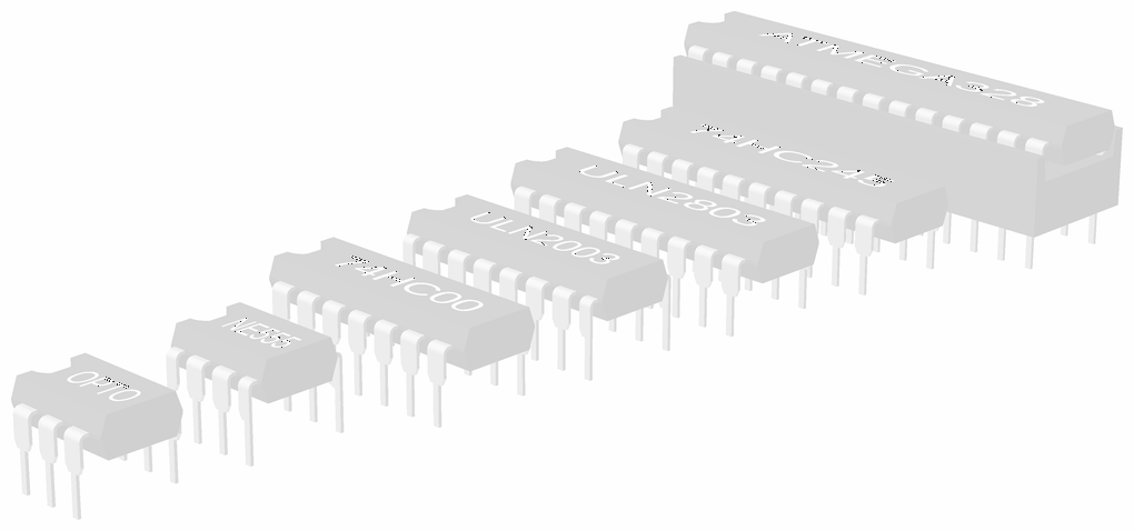

Most of my tests seem a bit faster with the RC. Text renders slightly
differently.
[image: dip_diff.png]
differently.
Differently re performance, or graphically?
nophead wrote > Most of my tests seem a bit faster with the RC. Text renders slightly > differently. Differently re performance, or graphically? ----- OpenSCAD Admin - email* me if you need anything, or if I've done something stupid... * on the Forum, click on my MichaelAtOz label, there is a link to email me. Unless specifically shown otherwise above, my contribution is in the Public Domain; to the extent possible under law, I have waived all copyright and related or neighbouring rights to this work. Obviously inclusion of works of previous authors is not included in the above. -- Sent from: http://forum.openscad.org/
Thu, Dec 10, 2020 12:06 PM
Graphically. A few pixels around the edges differ as shown in the picture I
posted. Not really a problem but I am curious why it is the case. I get
similar differences in pixels around the edges of everything when I move to
a different PC but with the same PC images are generally identical.

HL
Hans L
Thu, Dec 10, 2020 5:31 PM
Probably due to a slight difference in the way sizing is applied to text
now, from here:
https://github.com/openscad/openscad/pull/3263
Previously it relied on Freetype's funky (and very limited) fixed-point
number format, now it scales the vertex positions with double precision
floating point multiplication, after getting the glyph paths from Freetype.
