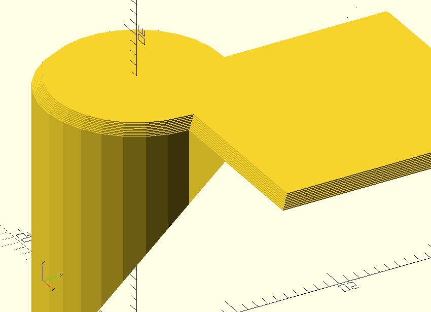

I've been experimenting with these simple bevel modules.
module myshape(){
   cylinder(d=18,h=25);
   cube(25);
//bevelall()myshape();
below()myshape();
beveltop()myshape();
module beveltop(bh=1,ht=25){  // bh = bevel height, ht = height to top
of bevel
   translate([0,0,ht])
     for (j=[0:0.1:bh-0.1]){
      translate([0,0,j])
          linear_extrude(0.1)
          offset(delta=-1*j)
          projection(cut=false)
          translate([0,0,-ht])
module below(bh=1,ht=25){
     intersection(){translate([0,0,-10000+ht])
     cube([10000,10000,20000],true);
    children();}

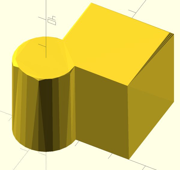

There are problems with manifold rendering in particular, but also with
some others. The only way to resolve the issue, afaik, is to close down
openscad, and restart. In f5 render it bevels the top of myshape, as
expected, in f6, it messes up. Once it is messed up, flushing
cache/whatever has no effect. Translating the modules, or changing $fn,
or sizes still gives the same distortions, (but in different location or
resolution). Anyway, I've come across similar problems before with
rendering, so I expect I'll have to live with it, unless recent builds
have specifically addressed this type of issue - my version is
2024.02.19, so maybe time to update again.  Images attached below, good
and bad
Perhaps someone can play with the code, load and run manifold, see if
you get the first image. If you get something like the second, then what
do you do to get the first, other than restarting?

I got the broken one with manifold enabled. To fix it I disabled manifold
and restarted OpenSCAD and then got a correct render with CGAL.

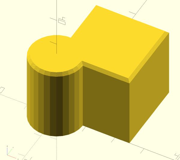

Sorry to spoil the fun!
ch=1; // chamfer
cylinder(d=18, h=25-ch);
cube([25, 25, 25-ch]);
translate([0, 0, 25-ch])
cylinder(ch, 9, 9-ch);
translate([25/2, 25/2, 25-ch])
linear_extrude(1, scale=[0.9, 0.9])
square(25, center=true);
No grainy patterns. Can be turned in any direction without parts disappearing. No messing up.
nop head wrote: > I got the broken one with manifold enabled. To fix it I disabled manifold > and restarted OpenSCAD and then got a correct render with CGAL. > > Version 2024.01.26 (git 358af340c) > > On Mon, 2 Dec 2024 at 19:16, Raymond West via Discuss < > discuss@lists.openscad.org> wrote: > > > I've been experimenting with these simple bevel modules. > > > > module myshape(){ > > cylinder(d=18,h=25); > > cube(25); > > } > > > > //bevelall()myshape(); > > > > below()myshape(); > > beveltop()myshape(); > > > > module beveltop(bh=1,ht=25){ // bh = bevel height, ht = height to top of > > bevel > > translate(\[0,0,ht\]) > > for (j=\[0:0.1:bh-0.1\]){ > > translate(\[0,0,j\]) > > linear_extrude(0.1) > > offset(delta=-1\*j) > > projection(cut=false) > > translate(\[0,0,-ht\]) > > children(); > > } > > } > > > > module below(bh=1,ht=25){ > > intersection(){translate(\[0,0,-10000+ht\]) > > cube(\[10000,10000,20000\],true); > > children();} > > } > > > > There are problems with manifold rendering in particular, but also with > > some others. The only way to resolve the issue, afaik, is to close down > > openscad, and restart. In f5 render it bevels the top of myshape, as > > expected, in f6, it messes up. Once it is messed up, flushing > > cache/whatever has no effect. Translating the modules, or changing $fn, or > > sizes still gives the same distortions, (but in different location or > > resolution). Anyway, I've come across similar problems before with > > rendering, so I expect I'll have to live with it, unless recent builds have > > specifically addressed this type of issue - my version is 2024.02.19, so > > maybe time to update again. Images attached below, good and bad > > > > Perhaps someone can play with the code, load and run manifold, see if you > > get the first image. If you get something like the second, then what do you > > do to get the first, other than restarting? > > > > --- > > > > OpenSCAD mailing list > > To unsubscribe send an email to discuss-leave@lists.openscad.org Sorry to spoil the fun! `ch=1; // chamfer` `cylinder(d=18, h=25-ch);` `cube([25, 25, 25-ch]);` `translate([0, 0, 25-ch])` `cylinder(ch, 9, 9-ch);` `translate([25/2, 25/2, 25-ch])` `linear_extrude(1, scale=[0.9, 0.9])` `square(25, center=true);` No grainy patterns. Can be turned in any direction without parts disappearing. No messing up.

Which version are you using? I don't get any issue with the latest master.
Manifold was using single precision floating point and can cause issue for
this kind of models, but it was changed a few months ago.
On 12/3/24 15:31, nop head via Discuss wrote:
Regardless of the code, why does Manifold get the wrong result?

I am using a version from January so, yes it is due to the massive cube in the below module. Removing a zero fixes it. module below(bh=1,ht=25){ intersection(){translate([0,0,-1000+ht]) cube([1000,1000,2000],true); children();} } On Tue, 3 Dec 2024 at 07:42, Chun Kit LAM via Discuss < discuss@lists.openscad.org> wrote: > Which version are you using? I don't get any issue with the latest master. > Manifold was using single precision floating point and can cause issue for > this kind of models, but it was changed a few months ago. > On 12/3/24 15:31, nop head via Discuss wrote: > > Regardless of the code, why does Manifold get the wrong result? > > On Tue, 3 Dec 2024 at 01:45, Caddiy via Discuss < > discuss@lists.openscad.org> wrote: > >> Hey! >> >> With offset() you even get nicely chamfered rounded corners! >> >> $fn=100; >> >> ch=1; // chamfer height = width >> >> sqx=5; // side x >> >> sqy=10; // side y >> >> linear_extrude(+ch, scale=[(1-2/sqx), (1-2/sqy)]) >> >> offset(2) >> >> square([sqx, sqy], center=true); >> >> BTW is this exercise just about experimenting with simple bevel modules >> or does it have a deeper purpose? >> >> >> _______________________________________________ >> OpenSCAD mailing list >> To unsubscribe send an email to discuss-leave@lists.openscad.org >> > > _______________________________________________ > OpenSCAD mailing list > To unsubscribe send an email to discuss-leave@lists.openscad.org > > _______________________________________________ > OpenSCAD mailing list > To unsubscribe send an email to discuss-leave@lists.openscad.org >
CK

Why not update? It is already about a year old, and manifold changed a lot.
