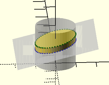

Fri, Oct 14, 2022 2:25 AM
As per me the following should be a very clean solution:
  1. find intersection points between a cylinder (or whatever shape) and
    titled surface
    2.copy the intersection points by whatever distance you want the thickness
    of the pie
  2. create a polyhedron from these 2 set of points.
I have written the code in jupyter notebook and is attached here in case
you want to experiment.
[image: Screenshot 2022-10-14 at 7.44.38 AM.png]
you need to change the file pathname and location.
you would also need dependencies.scad to visualise the points, or otherwise
remove the lines in the code where "points" function is referred
