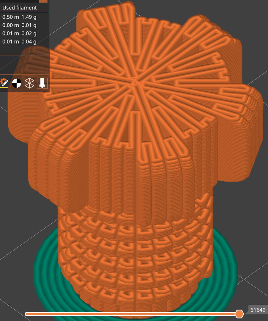

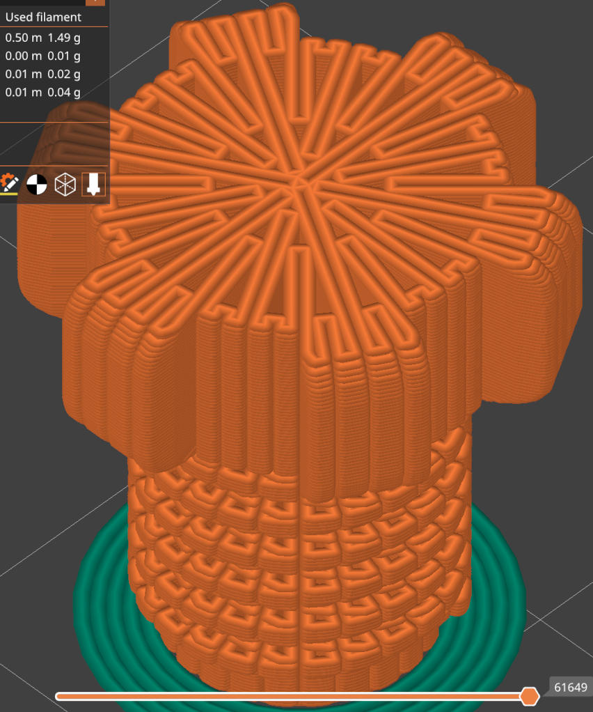

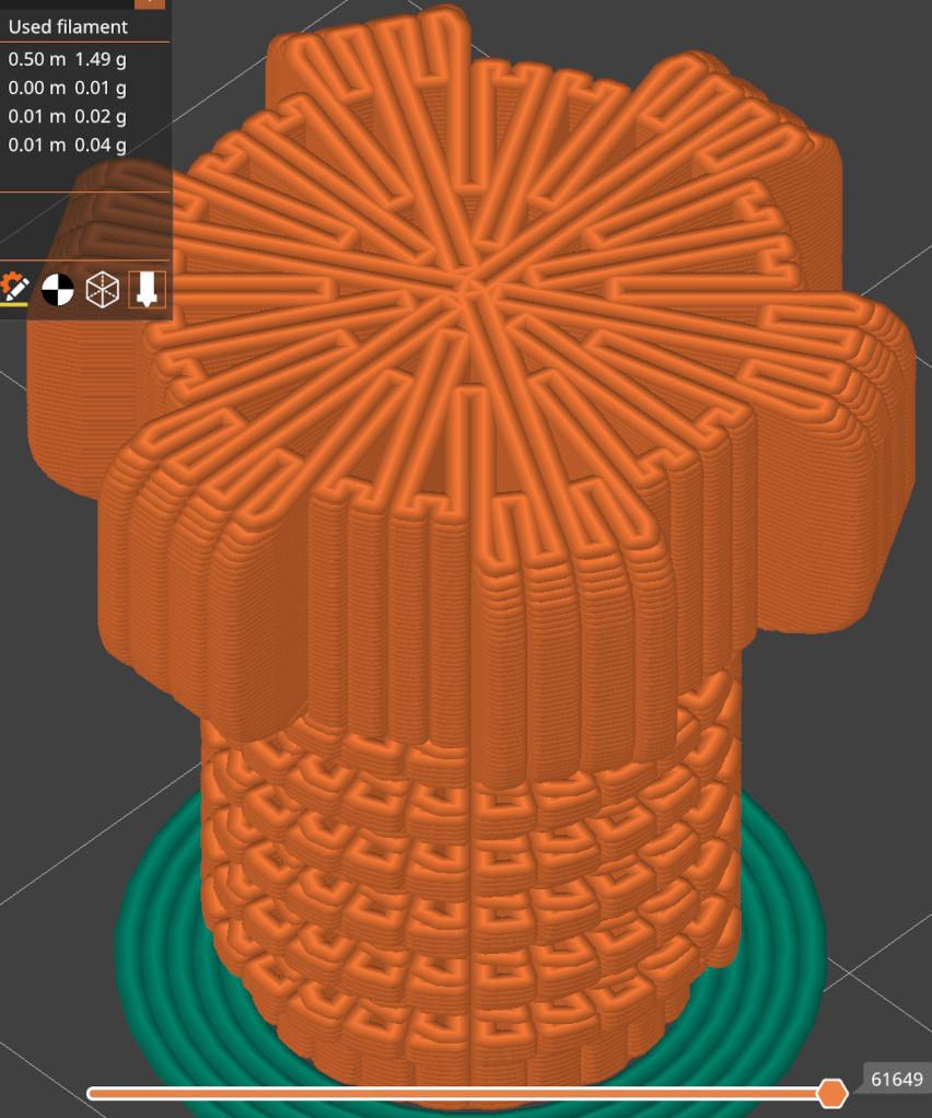

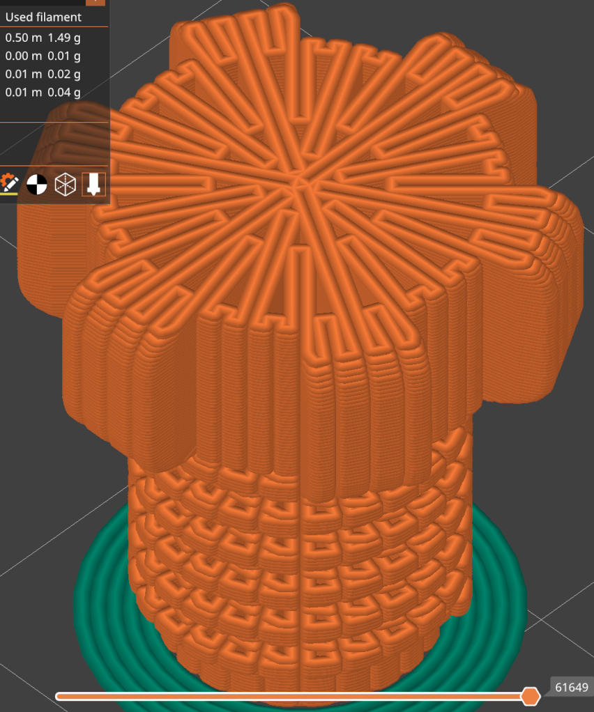

I often place cuts of 0.001mm in my models to direct the extrusion path of
perimeters in and out of a model's interior instead of the default
behaviour of just going around the outer circumference.  There are
parameters for resolution and closing gaps that must be set to enable the
fine cuts to work.

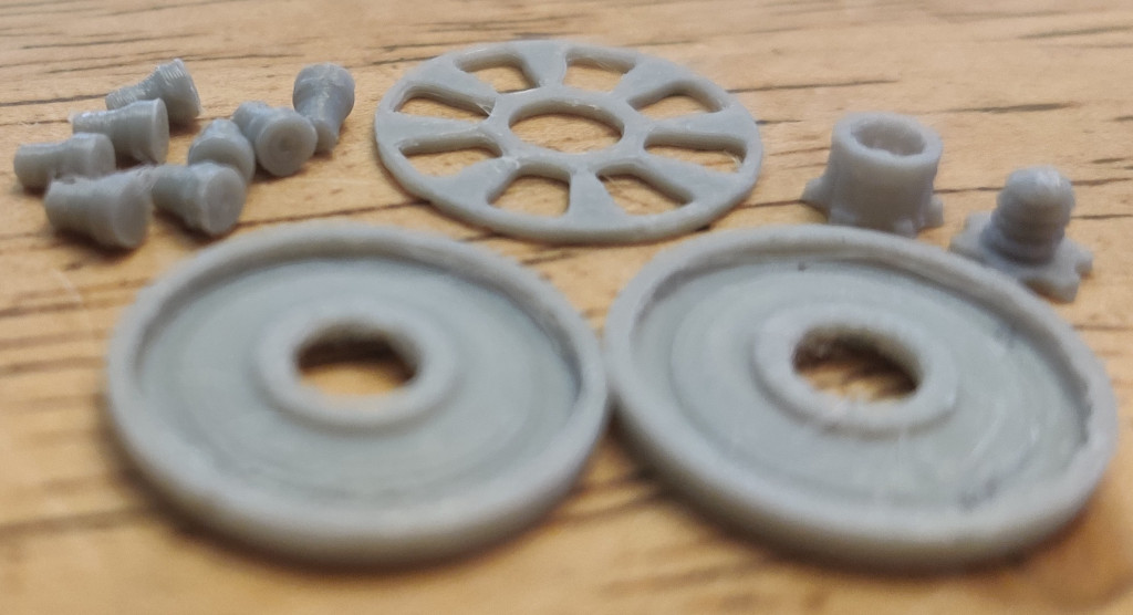

Here's a threaded fastener greatly strengthened with radial cuts sliced in
vase mode.
[image: vasecoresliced.jpg]

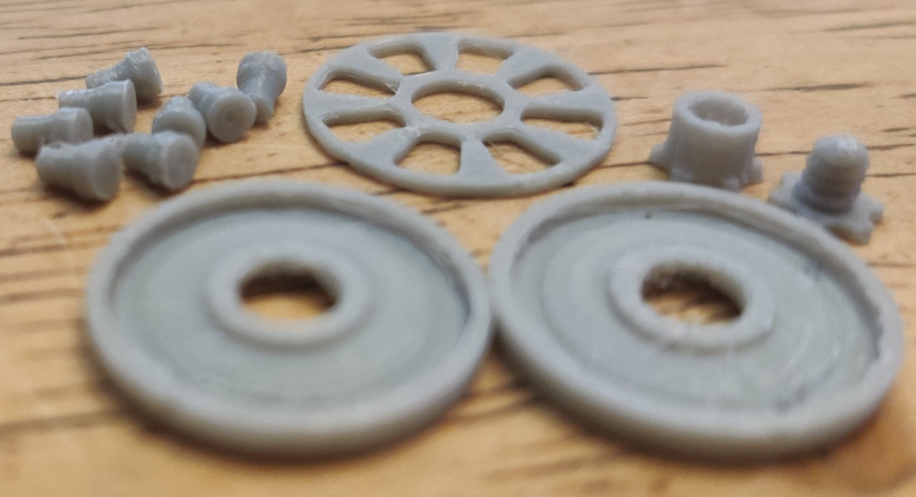

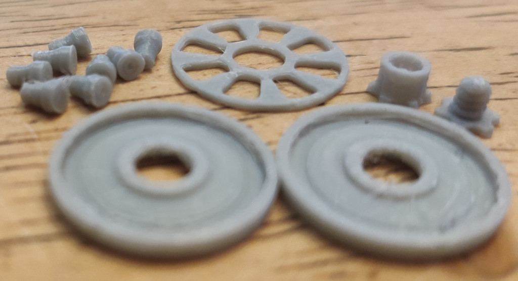

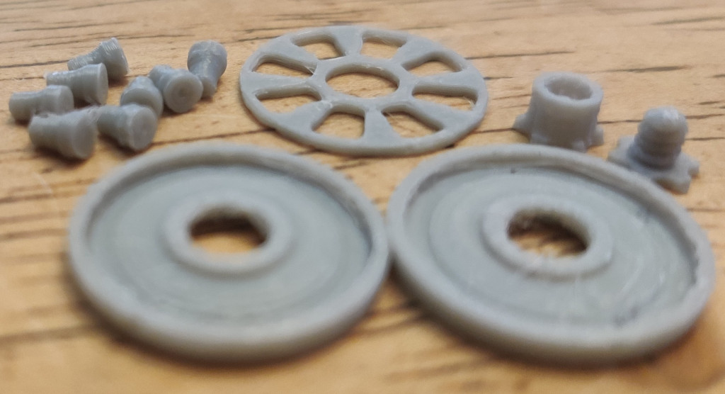

Here are the parts for a cartridge axial roller bearing 16 mm diameter by 4
mm diameter thickness.  The threaded fastener with a 2.5 mm diameter was
printed on a cheap fdm printer with a 0.4 mm nozzle using this technique.
[image: arb 4mm parts.jpg]

Ah.  Vase Mode.  Now that makes sense.
Does it help with "regular" prints?

Yes, controlling extrusion paths can improve many issues such as overhangs,
bridges, bed adhesion and warping, surface quality, precision of exteriors
and interior holes, achieving greater strength with fewer perimeters and
less infill, etc.
