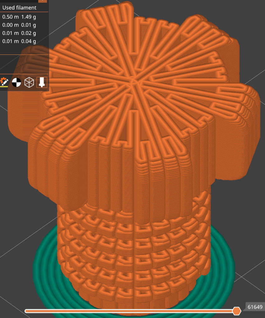

Here's a threaded fastener greatly strengthened with radial cuts sliced
in vase mode.

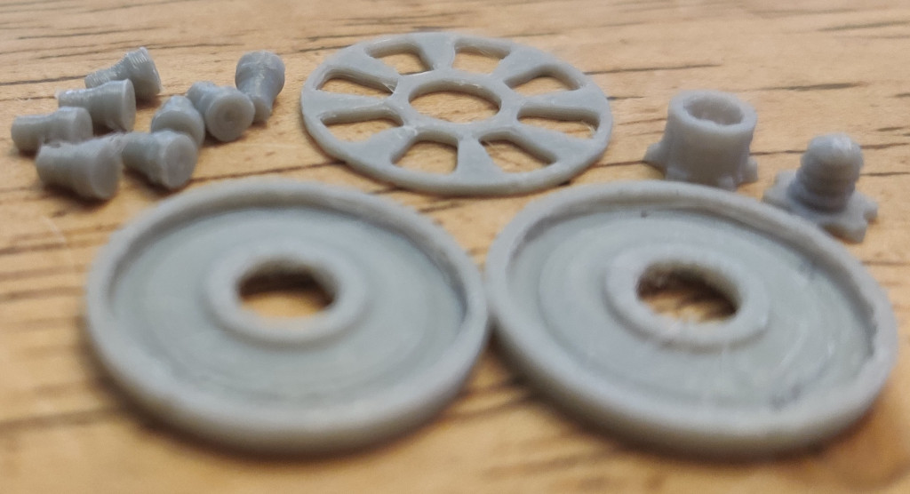

Here are the parts for a cartridge axial roller bearing 16 mm diameter by
4 mm diameter thickness.  The threaded fastener with a 2.5 mm diameter was
printed on a cheap fdm printer with a 0.4 mm nozzle using this technique.

I often place cuts of 0.001mm in my models to direct the extrusion path
of perimeters in and out of a model's interior instead of the default
behaviour of just going around the outer circumference.  There are
parameters for resolution and closing gaps that must be set to enable the
fine cuts to work.
