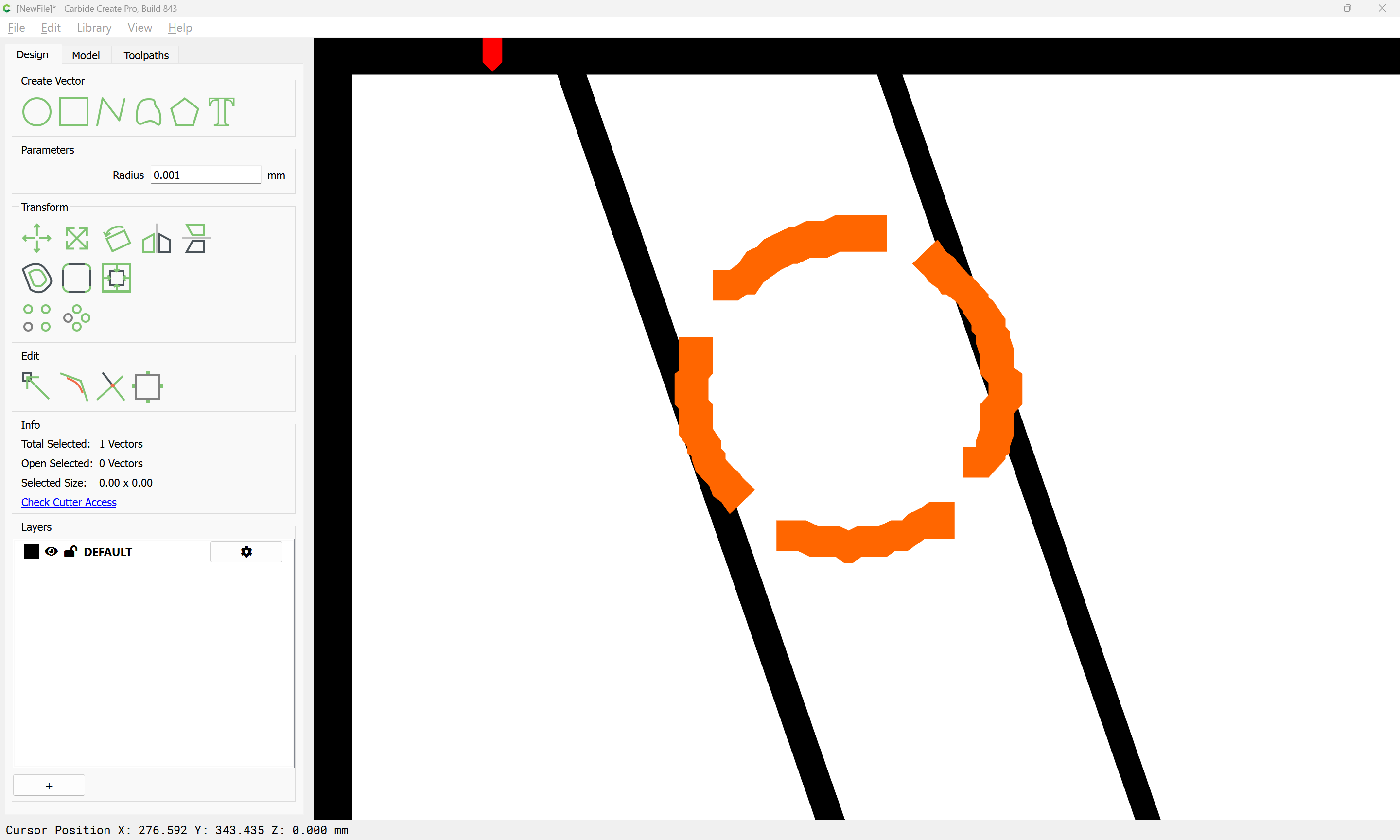

There looks to be ~0.002mm of gap in the first region I checked:
Thanks for looking into that. That probably explains things. Affinity Designer is designed for creating print materials and that small gap probably doesn’t matter for that.
It’s probably an artifact of the way I created the .SVG file. While developing it, I noticed a couple of larger gaps and was able to edit them out. 0.0002 mm might be so small that I can’t see it even with maximum zoom in Affinity Designer.
I’m not an expert with Affinity Designer, but I’ll play with it some more to see if there is a way to remove these gaps.
William<Screenshot 2026-04-16 152528.png>_______________________________________________
I did some more checking and I think I may have found the issue. Was the file you found the gap in black.svg? That file has text that was generated in Affinity Designer. The other three (red, white, blue) were all drawing. Affinity Designer has an option to fill holes. I went into black.svg and made sure the letters were converted to curves and then did a fill holes on those curves. It seems like that has cleared things up.
I’ve attached an archive with the updated black.svg and an updated OpenScad file (removing the hull()) and when I import the output into Bambu Slicer is doesn’t appear to have the inclusions.

That gap would absolutely matter for printing, precluding any sort of automated trapping from working.
It would be appropriate to clone the geometry in question and export the cloned geometry of each region to ensure each instance is consistent.
In my experience, fluctuations in geometry that are much smaller than
0.050 mm are basically ignored by most slicers.
