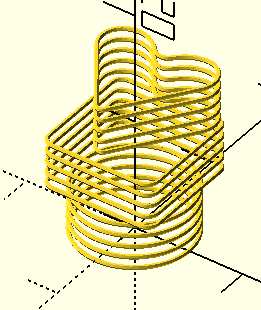

Adrian: Thank you! Imagine I am creating a series of cookies.  Some are of Santa. Some are of reindeer.  Some are Christmas tree ornaments. So there are three different cookie generators, one for Santas, one for reindeer, and one for ornaments.  Each generator creates a series of sizes, so each generator might create 5 different objects, for a total of 15. How would I do this?  Create each object in each generator and stuff the 15 into some data structure, and then pass the data structure into the recursive routine?  The part of your suggestion that has me stuck is the "it does one object at a time".  They are not all generated from one piece of code, but from three, and I don't see how to store them for processing by the recursion. On 2/11/2022 9:30 PM, Adrian Mariano wrote: > I don't know if it's "nice", but it OpenSCAD the way to do that is > with recursion. You write a function to generate the positions of all > the objects. It does one object at a time and the state information > (x, y, which objects are left, and the list of positions determined) > is passed to a recursive call. When there are no objects left you > return the list of positions. > > On Fri, Feb 11, 2022 at 9:23 PM jon <jon@jonbondy.com> wrote: >> I am generating perhaps 100 2D objects with varying sizes and shapes >> (they are not all the same width as depth). I want to place the objects >> in a fairly tightly packed array for printing, with perhaps 2 mm between >> each object. I know the 2D bounding box of each item. In a "regular" >> programming language I would have X and Y variables which I incremented >> as I added each object. Is there a nice way to do this in OpenSCAD? >> _______________________________________________ >> OpenSCAD mailing list >> To unsubscribe send an email to discuss-leave@lists.openscad.org > _______________________________________________ > OpenSCAD mailing list > To unsubscribe send an email to discuss-leave@lists.openscad.org
Sat, Feb 12, 2022 5:23 PM
does this come close to what you are thinking?[image: Screenshot 2022-02-12
at 10.51.29 PM.png]

does this come close to what you are thinking?[image: Screenshot 2022-02-12 at 10.51.29 PM.png] On Sat, 12 Feb 2022 at 08:55, jon <jon@jonbondy.com> wrote: > Adrian: > > Thank you! > > Imagine I am creating a series of cookies. Some are of Santa. Some are > of reindeer. Some are Christmas tree ornaments. So there are three > different cookie generators, one for Santas, one for reindeer, and one > for ornaments. Each generator creates a series of sizes, so each > generator might create 5 different objects, for a total of 15. > > How would I do this? Create each object in each generator and stuff the > 15 into some data structure, and then pass the data structure into the > recursive routine? The part of your suggestion that has me stuck is the > "it does one object at a time". They are not all generated from one > piece of code, but from three, and I don't see how to store them for > processing by the recursion. > > > On 2/11/2022 9:30 PM, Adrian Mariano wrote: > > I don't know if it's "nice", but it OpenSCAD the way to do that is > > with recursion. You write a function to generate the positions of all > > the objects. It does one object at a time and the state information > > (x, y, which objects are left, and the list of positions determined) > > is passed to a recursive call. When there are no objects left you > > return the list of positions. > > > > On Fri, Feb 11, 2022 at 9:23 PM jon <jon@jonbondy.com> wrote: > >> I am generating perhaps 100 2D objects with varying sizes and shapes > >> (they are not all the same width as depth). I want to place the objects > >> in a fairly tightly packed array for printing, with perhaps 2 mm between > >> each object. I know the 2D bounding box of each item. In a "regular" > >> programming language I would have X and Y variables which I incremented > >> as I added each object. Is there a nice way to do this in OpenSCAD? > >> _______________________________________________ > >> OpenSCAD mailing list > >> To unsubscribe send an email to discuss-leave@lists.openscad.org > > _______________________________________________ > > OpenSCAD mailing list > > To unsubscribe send an email to discuss-leave@lists.openscad.org > _______________________________________________ > OpenSCAD mailing list > To unsubscribe send an email to discuss-leave@lists.openscad.org >
Sat, Feb 12, 2022 6:29 PM
Thanks, Sanjeev, but no.  It's more like putting a bunch of cookies of
various sizes on a cookie sheet.
Adrian pointed out that if I can create each cookie as a separate STL,
then I can use my slicer to solve the problem, so I am automating the
STL generation using scripts at the OS level.

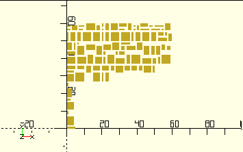

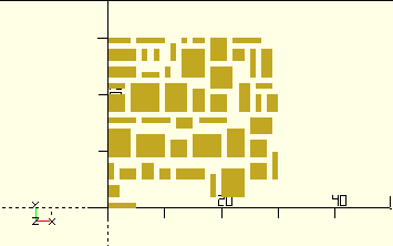

Sat, Feb 12, 2022 8:36 PM
Here's an implementation.  Given a list of sizes, returns a list of
positions.  Note that the algorithm is quite stupid; it lines objects up
across a row, and when it runs out of space it moves up to the next
row.  There is no attempt to reorganize pieces so that they will fit
better, use "wasted" space when a tall object is next to a short object,
et cetera.  Doing something smarter is ... hard.  See
https://en.wikipedia.org/wiki/Packing_problems .
// Given an array of [x,y] sizes, the maximum dimensions of the array,
// and the gap (in both X and Y), return a list of positions.
// pos, height, and i are used for recursion; the original caller does
// not supply them.
// pos is the proposed position of the next object.
// height is the maximum height of objects on the current row.
// i is index of the next item to process.

Just for fun, and to see if I could do it, and to see how well it works,
I put together something that does 2-D fitting.  Given an area, it finds
a place for the first block.  (The origin, duh.)  Then given the
remaining area, it finds a place for the next block.  And so on.
It gets appreciably better density than the row-based variant - it will
pretty reliably pack 50 of those one-to-five-unit objects into a 30x30
area with a 1-unit gap, where the previous one was only good for about
36.  Behavior is random, because the list of blocks to be placed is
random.  Of course, for any given list the result is the same.  Note
again that if all of the blocks are the maximum size of 5x5, a 30x30
area can only hold 25.
It uses a "first fit" scheme; a "best fit" scheme might yield better
results.
For 50 entries, it executes in 2-3 seconds on my machine.  Its free
lists can get quite large - for 50 objects, typical is around 5-6
thousand entries.  One could imagine deduplicating the free lists; that
might improve performance.  Also, I didn't try to optimize for tail
recursion.

And here's the test program that exercises it...
// Note that the fit functions don't know anything about gaps.
// We simulate them  here by putting a gap to the top and right of
// each block, and making the area be one gap larger than it needs
// to be.
function irand (min, max) = floor(rands(min, max+1, 1)[0]);
gap = 1;
area = [30,30];
sizes = [ for(i=[1:50]) [irand(1,5), irand(1,5)] ];
junk = echo(sizes=sizes) 0;
sizes_with_gaps = [ for (b = sizes) b + [gap,gap] ];
pos = fit(sizes_with_gaps, area + [gap,gap]);
assert(len(sizes) == len(pos));
echo(pos=pos);
for (i = [0:len(sizes)-1]) {
    translate(pos[i])
        square(sizes[i]);
Fitting 100 objects into a 60x60 area got really slow; at the end it was
taking several seconds per block and had nearly 250k entries on its free
list.  But it did complete, in 2m31s:
Why it clusters that way is left as an exercise for the reader.
