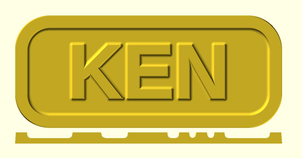

Yes, they may have to fillet the sharp recesses of the K and N, if it's
for sand casting. If it were up to me I'd investment cast, and burn out
the plastic, no need to worry about fillets and draft then..

 I made it parametric, with customizer, and did a quick test print. -

Yes, they may have to fillet the sharp recesses of the K and N, if it's for sand casting. If it were up to me I'd investment cast, and burn out the plastic, no need to worry about fillets and draft then.. On 04/05/2024 01:04, Sanjeev Prabhakar wrote: > Normally if you are casting, sharp corners will always create problem. > > Draft and fillets needs to be provided to avoid scoring, sticking and > metal filling issues. > > For one off castings maybe fine though. > > Regards > > > > On Sat, 4 May, 2024, 1:07 am Raymond West via Discuss, > <discuss@lists.openscad.org> wrote: > > I made it parametric, with customizer, and did a quick test print. - > > > On 03/05/2024 10:33, Raymond West via Discuss wrote: >> >> Thanks Revar, >> >> Just what I needed.  I realise now that I created a sort of x y >> problem for myself, having always used a sphere for rounding >> edges with Minkowski, I'd completely forgotten that other solids >> were possible, never mind hull for corner rounded squares. 🙁 >> >> Best wishes, >> >> Ray >> >> > _______________________________________________ > OpenSCAD mailing list > To unsubscribe send an email to discuss-leave@lists.openscad.org >
Sat, May 4, 2024 1:14 PM
A minor inset of the letters using offset(r=), before they get minkowski()’d may fillet the recesses enough for sand casting.
-Revar

Sat, May 4, 2024 4:25 PM
It may be there is a specific font for casting, but hopefully whoever is
doing the casting will give some feedback. However, this is good enough
if I were casting it. If they need more draft, and bigger fillet, It
will be easy enough to print another pattern, (it only took about 90
minutes)

Here's a profile across the centre. below the plate. Everything can be
changed, draft angle, fillet radius, font, text, size etc. It takes
about five minutes to render, - a few Minkowski's and increased
resolution for the curves.
I've attached the scad code below. It was neat and understandable from
Revar, now it works as I want it, but there is a 'style clash' 😳. You
can pull out the parts for tapered or really any profiled text .

One way to get a similar effect is to union a bunch of linear extrusions
with different offsets.
Here's an example.
linear = function (offset, i, steps) offset*(i-1)/(steps-1);
trig = function (offset, i, steps) offset*(1-cos(90*(i-1)/(steps-1)));

Doesn't the experimental roof option allow one to make text with
tapered walls? I have never tried it as I have never needed it yet.
On Sat, 4 May 2024 at 22:18, Jordan Brown via Discuss <
On 5/4/2024 12:29 PM, Curt McDowell via Discuss wrote:
It sounds like you're asking for offset() functionality to be integrated
into extrusion so the that offset can also be varied as a parameter. That's
even more general than integrating a general transform() functionality into
a path extrude. Most general of all would be passing an arbitrary module to
an extrude function.
Yeah, linear extrude with offset would be cool, but the problem is that
it's not nearly as easy as twist and scale.  Points can appear and
disappear during the offset, and so there's no straightforward connection
from one layer to the next.  People have done similar things - I think
often called "skin" - but they are finicky and prone to problems.
Here's an example.
inverselinear = function (offset, i, steps) offset - linear(offset, i, steps);
module offsettext(h, text, steps, offset, size=10, f=linear, font="") {
for (i=[1:steps]) {
this_h = h*i/steps;
this_off = f(offset, i, steps);
linear_extrude(height=this_h)
offset(this_off)
text(text, size=size, font=font);
offsettext(5, "Hello World", 10, offset=-1.2, size=30, f=linear, font="");
I swear that at one point I had a simple variation that would produce
rounded tops, but right now I can't remember what it was and don't find an
example.  But you can replace the function used to try different profiles.
