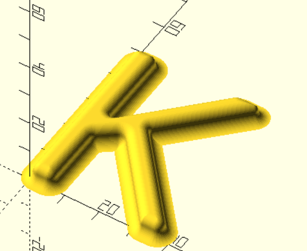

Letters should be like following, to be able to cast well:
Letters should be like following, to be able to cast well: [image: image.png]
Sun, May 5, 2024 1:28 PM
Thanks, you may be correct. I followed the drawing's profile given by
one  of the guys who will be getting it cast - he has plenty of
experience. Any way, simple enough to round all the top edges, if needed
(offset to reduce stroke thickness of letters, and change shape of
trumpet_horn profile) . However, they first will need to find a foundry,
and see what they say when they see this first pattern.

After a bit of mental exercising, I've generated a more useful profile.
It seems to be  able to generate chamfers, and interesting profiles for
other purposes, such as interlocking dovetail/comb/finger type joints.
code attached below, if of interest.
plying with the few values can generate
