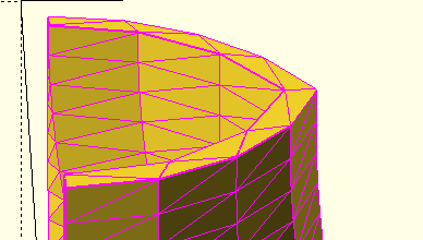

So it seems like I only get the:
DEPRECATED: Using ranges of the form [begin:end] with begin value greater
than the end value is deprecated.
warning under a special case:
and the message appears partway through a bunch of other debug messages
(suggesting it built one structure, and then later hits the error doing the
difference or the later mirror.  Also nothing is drawn because there is a
problem somewhere.
I should mention I DO have loops where start is greater than end, but in
the cases I intend to be that way, I have an index value of -1.  I have
also recoded things so the other case [start: end] always uses [start: 1:
end] when end is intended to be >  start.
arches2(16);
mirror([0,0,1]) {
arches2(16,true); //subtract a SOLID version
mirror([0,0,1]) {
arches2(16);

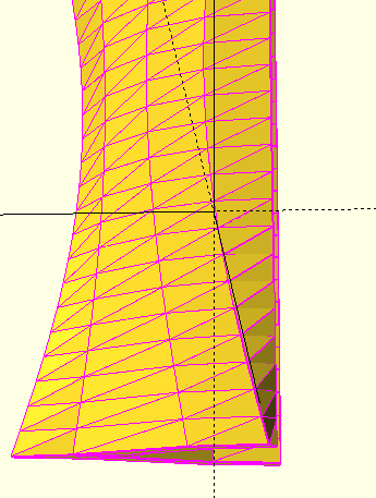

If I do arches2(16)  I can render the object and it looks fine.  Likewise
when I preview -> thrown together that I don't see any purple / pink facets
only purple pink edges.
If I union arches2(16) with a cube I get the: "ERROR: CGAL error in
CGAL_Nef_polyhedron3(): CGAL ERROR: assertion violation! Expr: e_below !=
SHalfedge_handle() File:
/opt/mxe/usr/x86_64-w64-mingw32.static.posix/include/CGAL/Nef_3/SNC_FM_decorator.h
Line: 426" message
I also get that message (twice) if I simply do this:
arches2(16,2);
mirror([0,0,1]) {
arches2(16,2);
arches2(16) does a skin over a bunch of 16 vertex polygons (that you can
roughly view as being horsehoes, wishbones, arches).  The second numeric
argument represents a thickness (it has a default value), a boolean
argument (default false) determines if the object is "solid" (that is not
horseshoe shaped but a convex polygon with no concavity, also with fewer
vertices)
So I'm confused how to approach debugging this.

So I was taking your idea of doing less.  Instead of 105 transition steps I
did 15.
If I union it with a cube it only works if they don't touch at all, if they
do touch it seems to blow up and render nothing.
If I take the more simple version and do Preview -> Thrown together I don't
see any pink / purple facets (but the edges are all pink purple) the one
thing that strikes me as very odd is that each arch should be planar.  I
would intuitively expect no triangles on the ends yet all the vertices on
the ends are part of triangles.  Of course, it might also do those
triangles if all the vertexes are planar, I just don't know.

I don't think you should see purple edges. Do they meet or is there a hole
through which you can see the purple interior?
