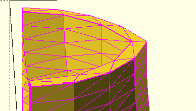

Is the base of the whole arch structure (left side) supposed to be coplanar?
It doesn't look coplanar in your image.
Can you reduce the transition steps to 2 or 1 (I'm not sure how you are
counting so I don't know what is the minimum sensible option here).  The
point is to really push things to the minimal example that triggers your
problem, so that you can really inspect the example carefully---for example
look at every vertex coordinate in your polyhedron and every face list by
hand and see if you notice anything odd.
Are you generating this by using the skin() module from
list-comprehension-demos?
DanS wrote
So I was taking your idea of doing less.  Instead of 105 transition steps
I
did 15.
If I union it with a cube it only works if they don't touch at all, if
they
do touch it seems to blow up and render nothing.
If I take the more simple version and do Preview -> Thrown together I
don't
see any pink / purple facets (but the edges are all pink purple) the one
thing that strikes me as very odd is that each arch should be planar.  I
would intuitively expect no triangles on the ends yet all the vertices on
the ends are part of triangles.  Of course, it might also do those
triangles if all the vertexes are planar, I just don't know.

If there is a hole I don't seem to be able to see into it.  I think what
you are implying is that each of the "edges" I see is actually a
rectangular hole.  That is possible but I can't prove or disprove it.
I'm trying to do the interpolations with the case that each arch segment is
also on an arched pathway.  Maybe I'll see if I can get an error on
interpolated arches on a straight line path, might be easier for me to view
in preview.

ERROR: CGAL error
Any CGAL error is almost guaranteed to be either bad polygon/polyhedron, or
import() of a bad .stl file.
In Thrown-together any purple is bad.
It is difficult to debug without seeing your code.

Yes, skin is from list comprehension.  Or at least I believe so.
Each arch is supposed to be coplanar.
I created a new function (that I felt would help me view things) by not
centering each arch on top of a path that is itself an arch.  When I do
that I can render a union with a cube.  This is starting to suggest the
problem comes about when putting each arch on a path that is itself an arch
(but I thought I tested and cleared that earlier :( ).
Even in this case (where I can render a union with the cube, preview ->
thrown together shows pink purple edges)
Nop / MichaelAtOz:
I only see the pink/purple color in throw together either on the edges or
if I am already inside of something (that is the viewpoint is partway
inside the arch)
MichaelAtOz:
I can show the code to people but it isn't pretty and rightfully people
have said in the past "I don't want to debug that"

I think he posted the code before and it was several hundred lines and
pretty chaotic.  That's why I'm pushing for simplifications instead.
For curiosity I was able to get pink "edges" by leaving a small gap.  One
of the octahedra has gaps along four of its edges (not all) and this shows
up as pink "edges" in the thrown together view.
vertices = [[0,0,-1],  //0
[0,0,1],    // 1
[1,0,0],    // 2
[0,1,0],    // 3
[-1,0,0],// 4
[0,-1,0], //5
[1,0,.01],    // 6
[0,1,.01],    // 7
[-1,0,.01],//8
[0,-1,.01]]; //9
goodfaces = [[2,5,1], [5,2,0],
[3,2,1], [2,3,0],
[4,3,1], [3,4,0],
[5,4,1], [4,5,0]];
badfaces = [[6,9,1], [5,2,0],
[7,6,1], [2,3,0],
[8,7,1], [3,4,0],
[9,8,1], [4,5,0]];
polyhedron(vertices,faces=goodfaces);
translate([4,0,0]) polyhedron(vertices,faces=badfaces);

So here's the thing that has me real confused now.  I thought that union()
with a cube was guaranteed to not work if things are bad.
If I do the interpolation of arch types (using sin() to make it curved) but
I put all the arches along a linear path (not a path that is part of an
arch), I can union it with a cube and get it to render fine.
Then if I do preview -> thrown together I get the pink / purple (should I
say magenta?) edges.
So if union with a cube only renders if things are good, then that would
imply magenta edges in preview -> thrown together do not necessarily imply
a problem in my version of openscad (I think I have some 2018 release).  I
can easily believe that magenta edges could also (under some cases) be
rectangular holes or rectangular magenta facets.

So here's the thing that has me real confused now. I thought that union() with a cube was guaranteed to not work if things are bad. If I do the interpolation of arch types (using sin() to make it curved) but I put all the arches along a linear path (not a path that is part of an arch), I can union it with a cube and get it to render fine. Then if I do preview -> thrown together I get the pink / purple (should I say magenta?) edges. So if union with a cube only renders if things are good, then that would imply magenta edges in preview -> thrown together do not necessarily imply a problem in my version of openscad (I think I have some 2018 release). I can easily believe that magenta edges could also (under some cases) be rectangular holes or rectangular magenta facets. On Thu, Jul 4, 2019 at 7:52 PM adrianv <avm4@cornell.edu> wrote: > MichaelAtOz wrote > >> ERROR: CGAL error > > > > Any CGAL error is almost guaranteed to be either bad polygon/polyhedron, > > or > > import() of a bad .stl file. > > > > In Thrown-together any purple is bad. > > > > It is difficult to debug without seeing your code. > > I think he posted the code before and it was several hundred lines and > pretty chaotic. That's why I'm pushing for simplifications instead. > > For curiosity I was able to get pink "edges" by leaving a small gap. One > of the octahedra has gaps along four of its edges (not all) and this shows > up as pink "edges" in the thrown together view. > > vertices = [[0,0,-1], //0 > [0,0,1], // 1 > [1,0,0], // 2 > [0,1,0], // 3 > [-1,0,0],// 4 > [0,-1,0], //5 > [1,0,.01], // 6 > [0,1,.01], // 7 > [-1,0,.01],//8 > [0,-1,.01]]; //9 > > > goodfaces = [[2,5,1], [5,2,0], > [3,2,1], [2,3,0], > [4,3,1], [3,4,0], > [5,4,1], [4,5,0]]; > > > badfaces = [[6,9,1], [5,2,0], > [7,6,1], [2,3,0], > [8,7,1], [3,4,0], > [9,8,1], [4,5,0]]; > > polyhedron(vertices,faces=goodfaces); > translate([4,0,0]) polyhedron(vertices,faces=badfaces); > > > > > -- > Sent from: http://forum.openscad.org/ > > _______________________________________________ > OpenSCAD mailing list > Discuss@lists.openscad.org > http://lists.openscad.org/mailman/listinfo/discuss_lists.openscad.org >
