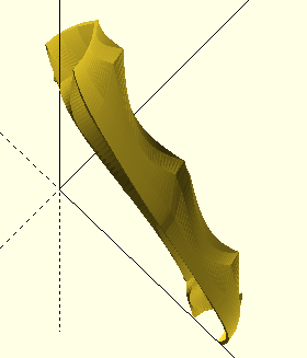

I'm not sure how to use View->Thrown Together properly
If I do render.  I see this:
If right after that I go into View and select Thrown Together  I don't see
anything in the console that indicates work is being done, my object
entirely disappears.  I was expecting that if it will take some time it
might indicate it is calculating.  Likewise, I thought the end result would
be the same drawing but with some facets in a different color (indicating
maybe missing / degenerate vertices caused things to be inside out).  What
is the proper way to use View -> Throw Together

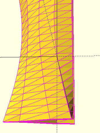

The typical behavior when a polyhedron is invalid is that it works in preview
but fails in render.  Use the "thrown together" option with preview, not
render.  Faces that are incorrectly oriented will appear in purple.
There's an example here, along with other advice on debugging polyhedra:
https://en.wikibooks.org/wiki/OpenSCAD_User_Manual/The_OpenSCAD_Language#Debugging_polyhedra
would

I don't recognize this error specifically, but typically if you get
errors
relating to polyhedra it means you have constructed an invalid polyhedron
with the polyhedron module.  You can select View->Thrown Together in
preview
which will show reversed faces.  But otherwise you just have to work
through
your construction.

The typical behavior when a polyhedron is invalid is that it works in preview but fails in render. Use the "thrown together" option with preview, not render. Faces that are incorrectly oriented will appear in purple. There's an example here, along with other advice on debugging polyhedra: https://en.wikibooks.org/wiki/OpenSCAD_User_Manual/The_OpenSCAD_Language#Debugging_polyhedra DanS wrote > I'm not sure how to use View->Thrown Together properly > > If I do render. I see this: > > [image: image.png] > > If right after that I go into View and select Thrown Together I don't see > anything in the console that indicates work is being done, my object > entirely disappears. I was expecting that if it will take some time it > might indicate it is calculating. Likewise, I thought the end result > would > be the same drawing but with some facets in a different color (indicating > maybe missing / degenerate vertices caused things to be inside out). What > is the proper way to use View -> Throw Together > > On Thu, Jul 4, 2019 at 11:03 AM adrianv &lt; > avm4@ > &gt; wrote: > >> DanS wrote >> > I'm still trying to debug my own code but am frustrated in that I can't >> > see >> > where the problem exists. I get some errors and other messages from >> > OpenScad but unfortunately they don't point to what it was in my code >> that >> > triggered it: >> > >> > ERROR: CGAL error in CGAL_Nef_polyhedron3(): CGAL ERROR: assertion >> > violation! Expr: e_below != SHalfedge_handle() File: >> > >> /opt/mxe/usr/x86_64-w64-mingw32.static.posix/include/CGAL/Nef_3/SNC_FM_decorator.h >> > Line: 426 >> >> I don't recognize this error specifically, but typically if you get >> errors >> relating to polyhedra it means you have constructed an invalid polyhedron >> with the polyhedron module. You can select View->Thrown Together in >> preview >> which will show reversed faces. But otherwise you just have to work >> through >> your construction. >> >> >> > Likewise, I sometimes get this warning: >> > >> > >> > DEPRECATED: Using ranges of the form [begin:end] with begin value >> greater >> > than the end value is deprecated. >> >> Yeah, this one is extremely annoying. There appears to be no way to get >> OpenSCAD to give you more information about this. It can be anywhere in >> your code, or anything that you include. It could be a degenerate case, >> in >> which case you can solve the problem by replacing every occurrence of >> [a:b] >> in your code with [a:1:b]. But if it's a mistake in your code, that will >> just cause the loop to not run---it won't tell you where the problem is. >> >> >> >> >> -- >> Sent from: http://forum.openscad.org/ >> >> _______________________________________________ >> OpenSCAD mailing list >> > Discuss@.openscad >> http://lists.openscad.org/mailman/listinfo/discuss_lists.openscad.org >> > > _______________________________________________ > OpenSCAD mailing list > Discuss@.openscad > http://lists.openscad.org/mailman/listinfo/discuss_lists.openscad.org > > > image.png (27K) > &lt;http://forum.openscad.org/attachment/26707/0/image.png&gt; -- Sent from: http://forum.openscad.org/

When I finally get to view things in preview, it looks like the whole
structure has yellow or black facets with all the edges being purple.  I
find this confusing.  Shouldn't some of the facets be yellow or black and
others be purple.  Why should any of the edges be purple?  I'm not
understanding this.
preview
