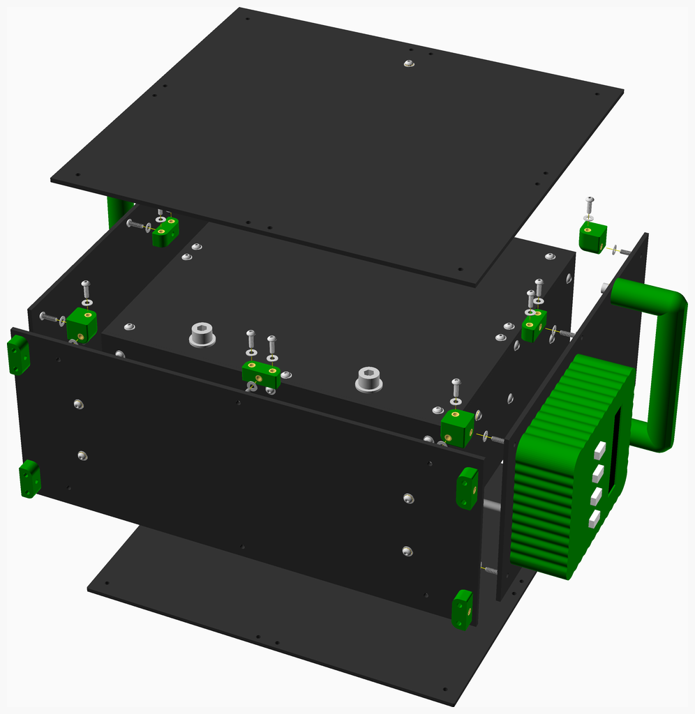

The module that makes the box has an echo statement that shows the internal
dimensions.
ECHO: "Box:", 133, 89, 150
This is because they are usually complicated expressions to fit the
internal components, so it is not obvious what they are. When the box is
small enough I use 3D printed panels. When it is too big for my printer I
use CNC cut DiBond panels with printed bezels and corner profiles. They can
be printed in arbitrarily many pieces and solvent welded together. So I can
make enclosures up to the capacity of my CNC milling machine. I also have a
simpler box in my library that is just sheets and brackets.
That module also echos its internal volume because I made a double walled
filament dryer and needed to estimate the volume of insulations that I
needed. So I subtracted the volume of the inner box. I stuff the gap with
cotton wool, which is a nice to handle insulator.
[image: bbox_assembly.png]
