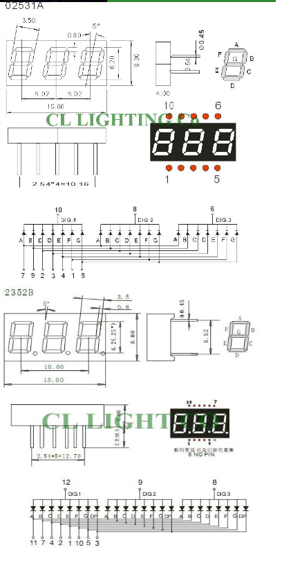

Tue, Oct 26, 2021 2:59 AM
Resizing the 7 segment displays was easy.  I added a new vector for
CL02511A (a fictitious part) with the adjusted data and added the new
vector to 7_segments in vitamins/7_segments.scad.
WT5011BSR = ["WT5011BSR", [12.7, 19, 8.2], [7.2, 12.7, 1.2, 10], [5, 2], [
inch(0.1), inch(0.6), 0.4]];
CL02511A = ["CL02511A", [5., 8, 4], [3.5, 6.2, 0.8, 5], [0, 0], [inch(0.1),
inch(0.), 0.25]];
7_segments = [ WT5011BSR, CL02511A];
use <7_segment.scad>
But the displays are still single-digit units, and I don't think they make
a CL02511A.  The real part is CL02531A, as shown below.
I need to do more coding to make multi-digit units without space between
the digits and adjust the pin placement so pins can be distributed
correctly over the combined unit rather than placed on each digit.  This
might just be a move of the pin code from module 7_segment_digit to module
7_segment_digits, with an additional piece of data indicating where to put
the first pin.
