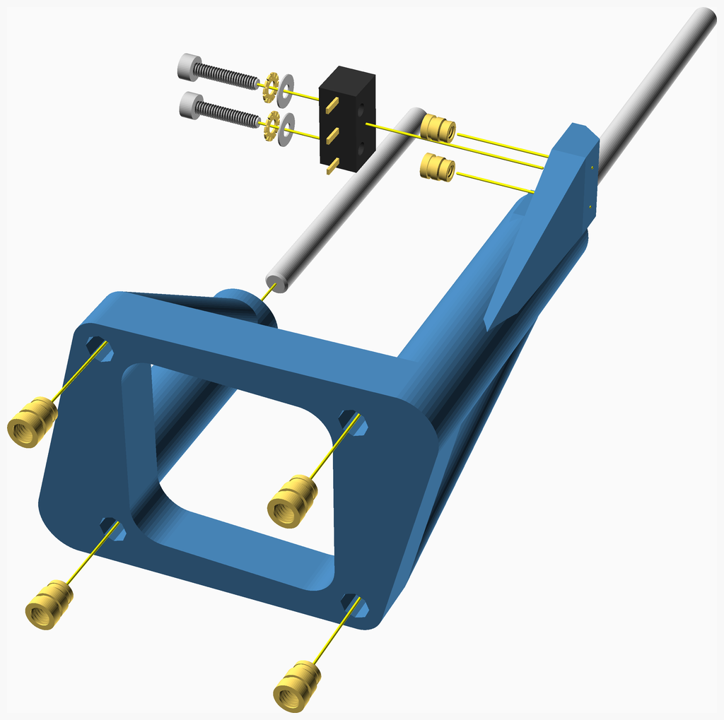

My library does pretty much all of those goals apart from
  • 2d Drawings with labels and measures
I make my 2D parts with a CNC mill, so I don't need dimensioned drawings.
Just DXF files.
  • animated movement showing the assembly process and movement within the
    final assembly
I have exploded views defined by a variable that can be between 0 and 1, so
setting it to 1 - $t would show parts coming together although I haven't
done that. I have lines between the exploded position and the final
position as in a conventional exploded view.
[image: dock_assembly.png]
I have also made animations of parts of a machine moving by making the axis
position a function of $t.
https://www.youtube.com/watch?v=aO12JR44Ets&t=8s

- animated movement showing the assembly process and movement within
the final assembly
so setting it to 1 - $t would show parts coming together although I haven't
the axis position a function of $t.

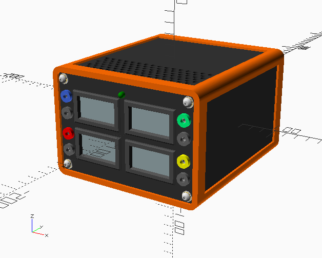

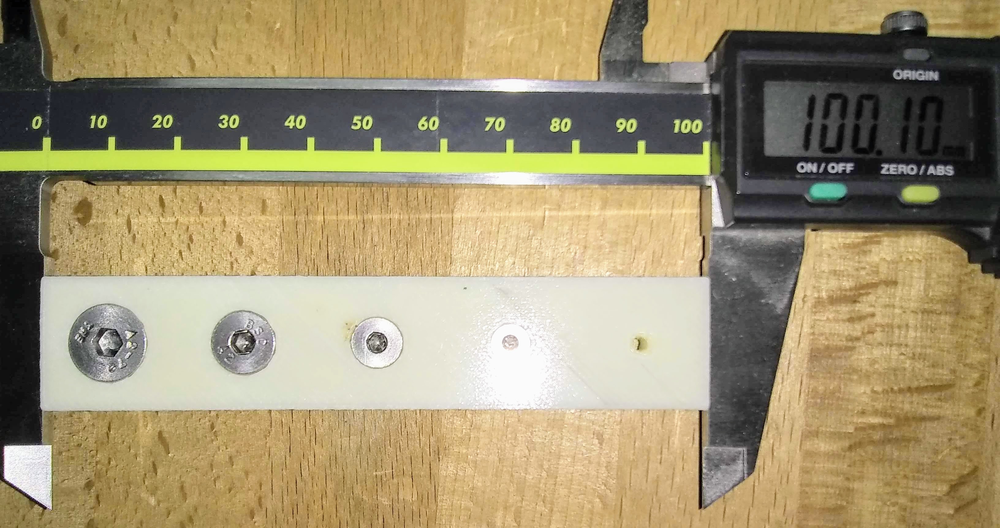

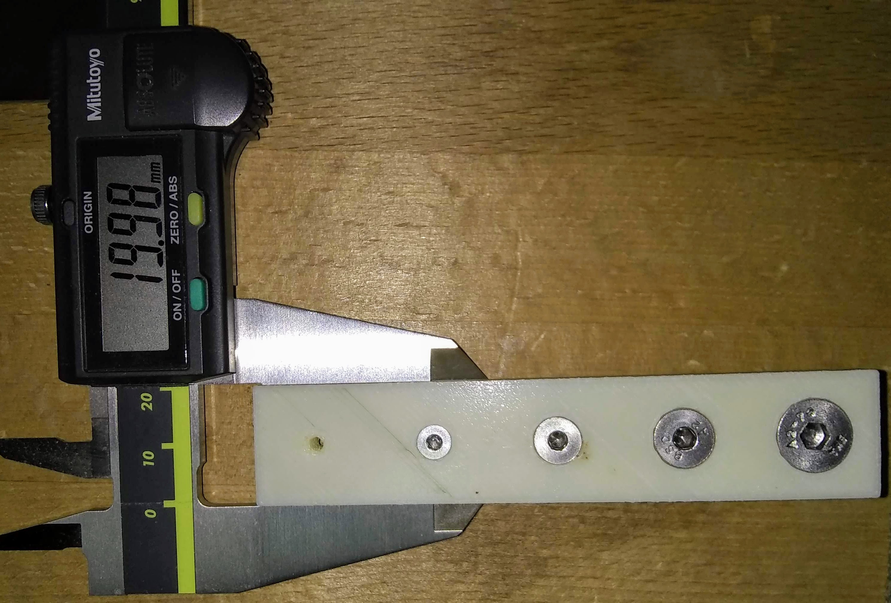

I never put scaling factors in my OpenSCAD code. I just calibrate my
printers and slicer setting to print things the correct size. I recently
checked my Mendel90 printer that was last calibrated around 10 years ago.
[image: IMG_20210323_212659826.jpg][image: IMG_20210323_212544674.jpg]
Most of my project dimensions are expressions that involve the size of its
components. If it has more than one file then yes I put them in a common
file that is included.
A simple example I am working on at the moment has lines like these:
psu = ATX300;
box_type = box(screw = M4_dome_screw, wall = 2, sheets = DiBond, top_sheet
= DiBond, base_sheet = DiBond, size = []);
clearance = 2;
front_depth = 50;
box = concat(box_type, [psu_length(psu) + 2 * (clearance +
box_wall(box_type)),
psu_height(psu) + 2 * (clearance +
box_intrusion(box_type)),
psu_width(psu) + front_depth]);
meter = DSN_VC288;
meter_spacing = 2.5;
function meter_pos(i) = let(s = pmeter_bezel(meter)) [(i % 2 ? -1 : 1) *
(s.x / 2 + meter_spacing), (i < 2 ? -1 : 1) * (s.y / 2 + meter_spacing)];
module meter_positions()
for(i = [0 : 3])
translate(meter_pos(i))
module output_positions()
for(i = [0 : 3])
let($colours = [["blue", "royalblue"], [ "green", "springgreen"],
["red", "red"], ["yellow", "yellow"]][i],
$value = ["120","330","500","120"][i]
translate(meter_pos(i) + [(i % 2 ? -1 : 1) * (pmeter_bezel(meter).x
/ 2 + jack_4mm_flange_radius() + meter_spacing), 0])
jack_pitch = 15;
led = LED5mm;
led_x = 0;
led_y = -35;
When I do F5 OpenSCAD tells me my box is 133 x 89 x 150, so I know it will
be printable.
This project has only two files at the moment. lab_atx2.scad and shunt.scad.
For big mult-project files like a 3D printer I might include a
positions.scad to place the internal assemblies but most of my projects are
only one or two files.
