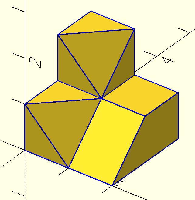

I was able to further obfuscate my solution. Gemini figured out the (1 +
sqrt(3)) / 3) part to remove one translate(). Then I figured out how to
remove three more translate()s, having had to /guess/ the sqrt(2):
     union() { cube([2, 1, 1]); cube([1, 1, 2]); }
     translate(2 * [sqrt(2), (1 + sqrt(3)) / 3, (1 + sqrt(3)) / 3])
         rotate([0, atan(sqrt(2)), 45]) cube(4, center=true);
     cube([2, 2, 1]);
     translate([1, 0, 1]) rotate([0, 45, 0]) cube(3);
-Curt

just with the points list:
a=[[0,0,0],[1,0,0],[1,0,0],[2,0,0],[2,2,0],[0,2,0]];
b=[[0,0,1],[0,0,1],[1,1,1],[2,1,1],[2,2,1],[0,2,1]];
c=[[0,1,1],[1,1,1],[1,1,1],[1,2,1],[0,2,1]];
d=[[0,1,2],[0,1,2],[1,2,2],[1,2,2],[0,2,2]];
s1=[a,b];
s2=[c,d];
color("blue") for(p=[s1,s2,cpo(s1),cpo(s2)]) for(p1=p) p_line3dc(p1,.02);
for(p=[s1,s2]) swp(p);

[image: Screenshot 2026-01-23 at 6.39.23 AM.png]
