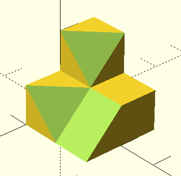

Why not use the old hull() trick?
s = 50;
p = [for(x=[-s, s], y=[-s, s], z=[-s, s]) if(!(x==50&&y==50&&z==50))
[x,y,z]];
hull()  polyhedron(p, [[0,1,2,3,4,5,6]]);
Am 22.01.2026 um 10:44 schrieb Curt McDowell via Discuss:
Here's my entry. Although it's vanilla code, it's just about as
readable as a polyhedron()!
         translate([-1, 0, 0]) cube([2, 1, 1]);
         translate([-1, 0, 1]) cube(1);
     translate([1, 1, 1] * 2 / 3)
         rotate([0, atan(sqrt(2)), 45])
             translate([-2, -2, 0]) cube(4);
     translate([-1, 1, 0]) cube([2, 1, 1]);
     translate([0, 0, 1]) rotate([0, 45, 0]) cube(3);
s = 50;
[x,y,z]];
Indeed, but whether that's more or less understandable than the
straightforward polyhedron is unclear.  It's also kind of an abuse of
polyhedron(), which will eventually bit us if we ever want to have
polyhedron() check its inputs for validity.
