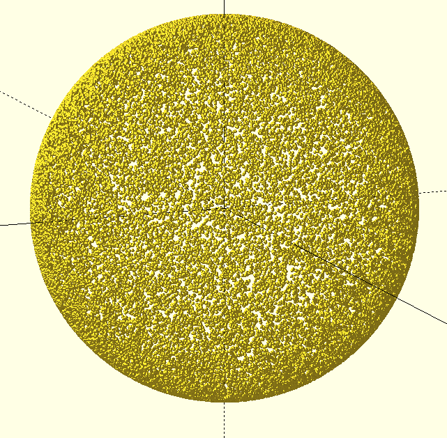

The question: what can you get with 45 deg rotations around the x, y and z
axes?  It turns out this is an infinite group and so it's possible you can
get arbitrarily close to the [1,1,1] vector you were looking for.  I leave
the task of finding the best approximator to the [1,1,1] angle using a
product of N 45 deg angles as an exercise...
I tried to draw a picture of the available points with a simple monte carlo
scheme:
include<BOSL2/std.scad>
module drawpt(p,max,count=0)
move(p) sphere(r=.01);
dir=rand_int(1,3,1)[0];
if (count<max)
drawpt(  dir==0 ? zrot(45,p)
: dir==1 ? xrot(45,p)
: /dir==2/  yrot(45,p),max,count+1);
for(i=[1:20])
drawpt(RIGHT,2000);
Note as an aside, is there no way to increase allowed recursion depth?  If
I set the max much higher it fails with "recursion detected" (like I didn't
know).
The image:

The question: what can you get with 45 deg rotations around the x, y and z axes? It turns out this is an infinite group and so it's possible you can get arbitrarily close to the [1,1,1] vector you were looking for. I leave the task of finding the best approximator to the [1,1,1] angle using a product of N 45 deg angles as an exercise... I tried to draw a picture of the available points with a simple monte carlo scheme: include<BOSL2/std.scad> module drawpt(p,max,count=0) { move(p) sphere(r=.01); dir=rand_int(1,3,1)[0]; if (count<max) drawpt( dir==0 ? zrot(45,p) : dir==1 ? xrot(45,p) : /*dir==2*/ yrot(45,p),max,count+1); } for(i=[1:20]) drawpt(RIGHT,2000); Note as an aside, is there no way to increase allowed recursion depth? If I set the max much higher it fails with "recursion detected" (like I didn't know). The image: [image: image.png] On Thu, Jan 22, 2026 at 1:38 PM Jordan Brown <openscad@jordan.maileater.net> wrote: > On 1/22/2026 9:48 AM, Adrian Mariano via Discuss wrote: > > Jordan, BOSL2 will help you avoid that trig and decrease the required > thinking as shown below. :) > > > Thanks, and I agree that's more obvious, but it's still unsatisfying that > it's not a sequence of 45° rotates. It probably *can't* be such a > sequence, but it *should* be. > >
Thu, Jan 22, 2026 7:34 PM
and z axes?
An additional constraint:  my probably-wrong intuition says you should
be able to do it with no more than three rotations, zero or one in each
of the axes.  (-45 rotations are OK.)  That's a fairly small number;
maybe I'll put it together.
At least one of the limits, maybe the only limit, is based on the
compiled-in C++ stack size.  OpenSCAD recursion translates into C++
recursion, so that's a hard limit.  (But:  I don't know about the APIs
involved here, but at least some thread APIs let you specify the stack
size for newly created threads, so that might allow for customization.)
