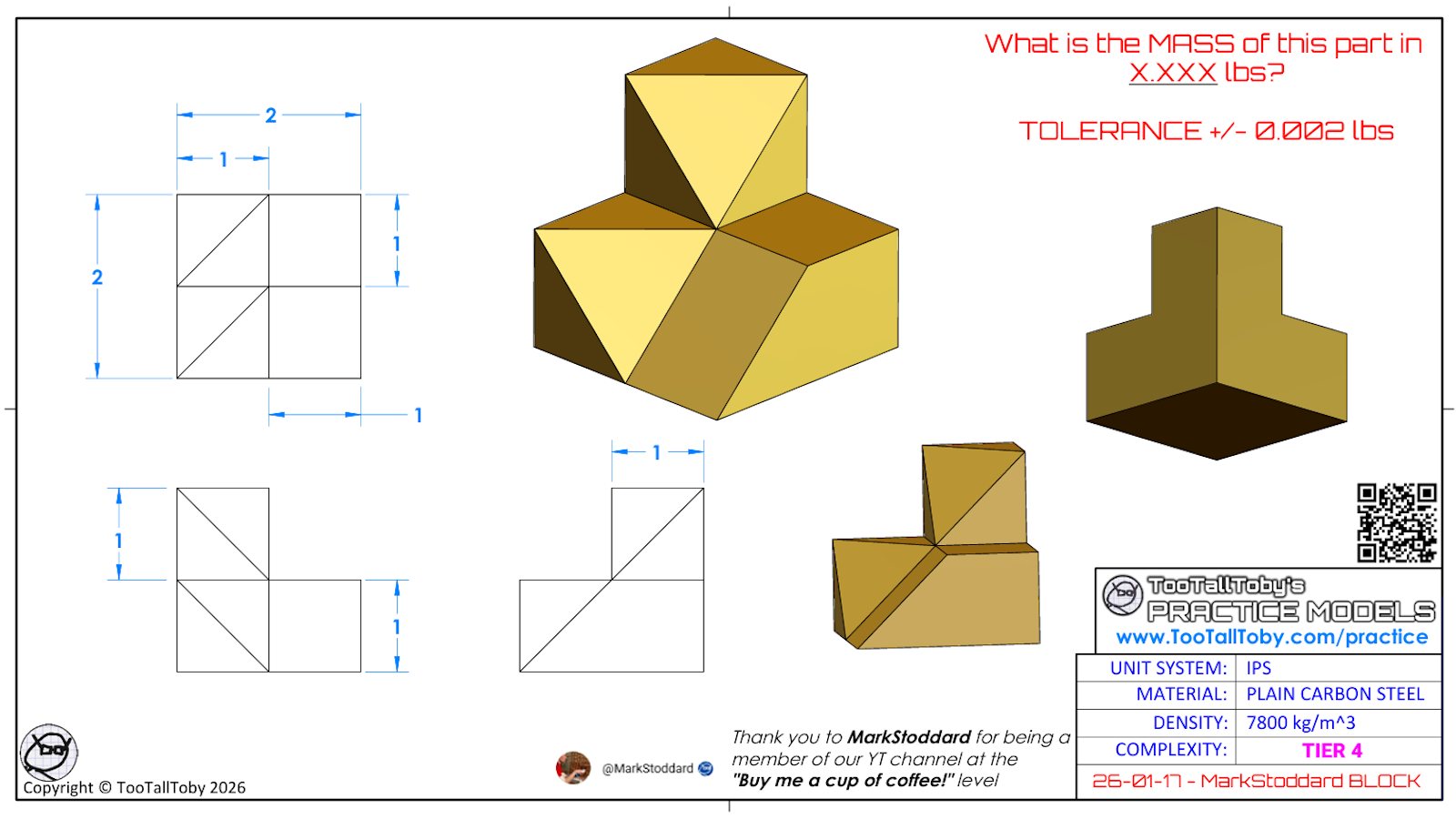

This was recently put up on Reddit:
https://old.reddit.com/r/FreeCAD/comments/1qibk1y/fun_freecad_model_to_try_to_build/
I believe I got it in Block/OpenSCAD, ~20 minutes:
https://www.blockscad3d.com/community/projects/2052961
click on a "Create" button to make an STL to check (or see the attached .scad file).
Is there a simpler/better way to make this?
Maybe using BOSL2?

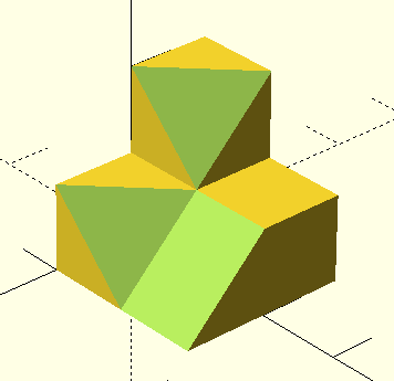

Here's my entry. Although it's vanilla code, it's just about as readable
as a polyhedron()!
         translate([-1, 0, 0]) cube([2, 1, 1]);
         translate([-1, 0, 1]) cube(1);
     translate([1, 1, 1] * 2 / 3)
         rotate([0, atan(sqrt(2)), 45])
             translate([-2, -2, 0]) cube(4);
     translate([-1, 1, 0]) cube([2, 1, 1]);
     translate([0, 0, 1]) rotate([0, 45, 0]) cube(3);
as a polyhedron()!
We have a winner!
On Thu, Jan 22, 2026 at 3:44 AM Curt McDowell via Discuss <
as a polyhedron()!

Thu, Jan 22, 2026 5:31 PM
Here's a geometric answer.  I'm deeply dissatisfied by the need to
resort to trig.  Intuitively, it seems like you should be able to
construct that figure using a series of 45° rotates, but I wasn't able
to.  Note also that this violates the sometimes-rule of avoiding
coincident faces.  I found constructing the polyhedron to be
significantly easier.  This required actual thinking; the polyhedron was
just a bit tedious.
module truncatedCube() {
cube();
translate([1,0,0])
rotate([0,-atan2(1/2,sqrt(2)/2),-45])
translate([0,-1,0]) cube(2);
module diagonalHalfCube() {
cube();
rotate([45,0,0]) translate([-1,0,0]) cube(3);
truncatedCube();
translate([0,1,1]) truncatedCube();
translate([0,1,0]) cube();
translate([1,1,0]) cube();
translate([1,0,0]) diagonalHalfCube();

Jordan, BOSL2 will help you avoid that trig and decrease the required
thinking as shown below.  :)    I think I like my second BOSL2 solution the
best.  To me it seems the most comprehensible.
include<BOSL2/std.scad>
cube();
translate([1,0,0])
rot(from=[1,0,0],to=[1,-1,1])
cube();
truncatedCube();
