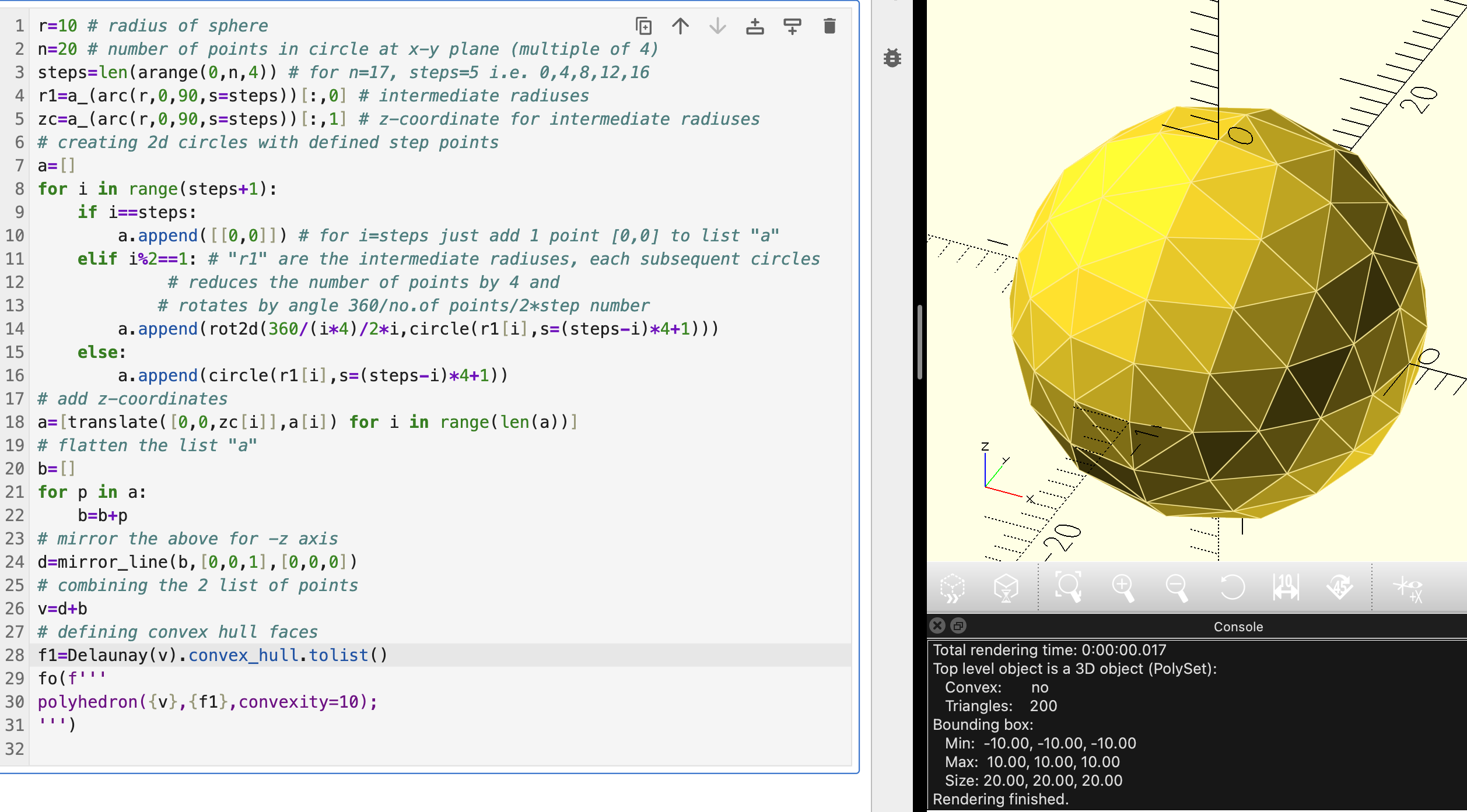

Fri, Jul 3, 2026 1:36 AM

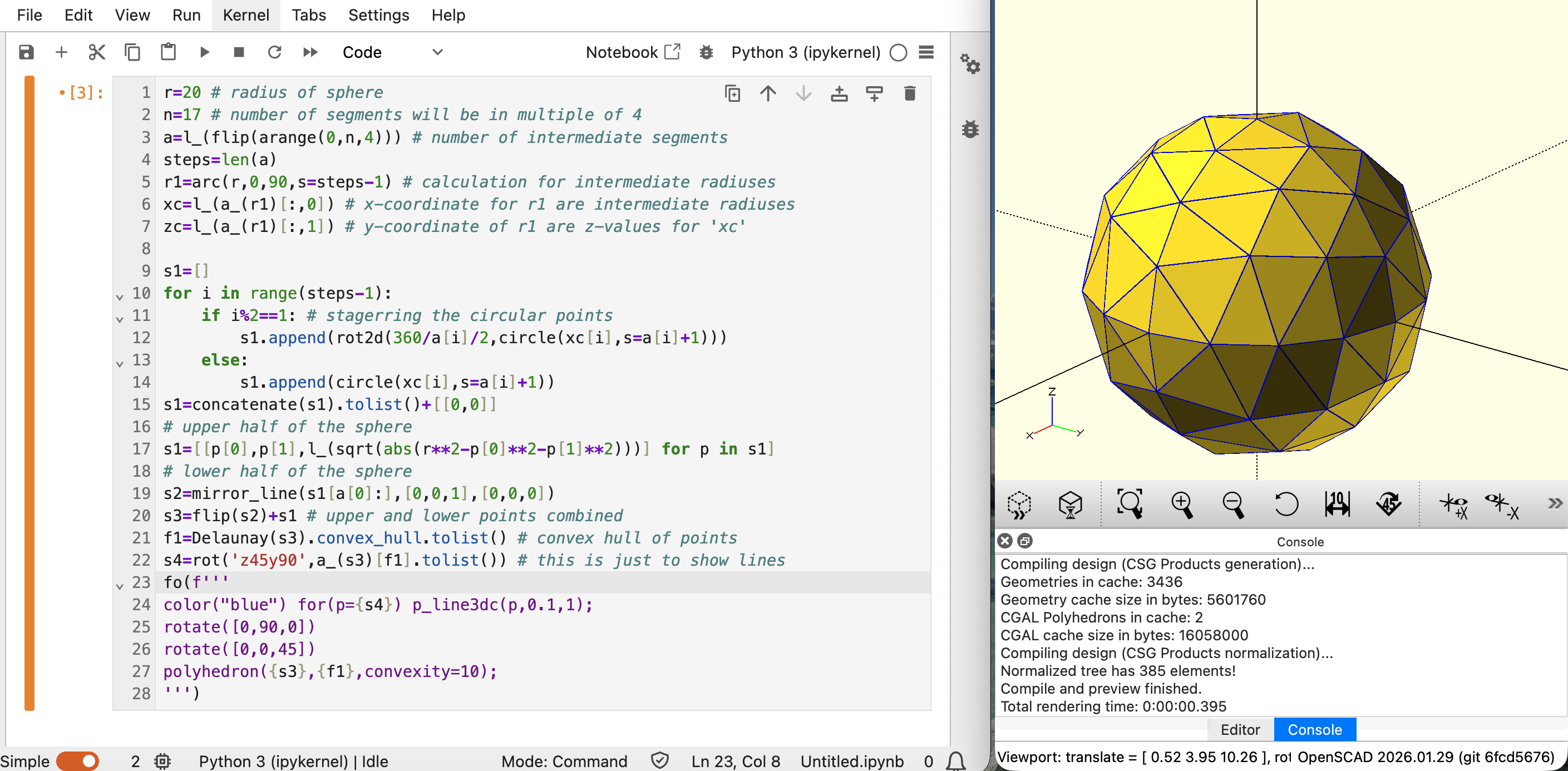

Thanks Revar
I adjusted the sphere
My revised logic is below:
[image: Screenshot 2026-07-03 at 7.00.52 AM.png]
On Thu, 2 Jul 2026 at 23:22, Revar Desmera via Discuss <
Maybe it's just the orientation of your screenshot, but those triangle
faces look oddly proportioned.  For reference, here's what the BOSL2 code
generates.  We're fairly sure this is the optimal vertex placement, because
the faces on the complete sphere look identical from the Top, Left, and
Front views.

Hi Raymond
According to me the regular sphere is good enough with simpler logic as
shared by Len.
The discussion seems to be more on aesthetics. The sphere shared by Revar
is definitely great to look at.

On 03/07/2026 02:36, Sanjeev Prabhakar via Discuss wrote:
Thanks Revar

Hi Raymond According to me the regular sphere is good enough with simpler logic as shared by Len. The discussion seems to be more on aesthetics. The sphere shared by Revar is definitely great to look at. On Fri, 3 Jul 2026 at 14:02, Raymond West via Discuss < discuss@lists.openscad.org> wrote: > Here is some results for a manifold sphere. > The bounding box is correct, unless the sphere is rotated, of course. The > surface area is a pretty good indicator of profile accuracy. 32 segments is > generally good enough. It only creates spheres with segments a multiple of > four, similar to the circle I mentioned b4 > > segments: 4.000000 > bounding box: 10.000000 -10.000000 10.000000 > volume: 1333.333374 surface area: 692.820312 > > segments: 6.000000 > bounding box: 10.000000 -10.000000 10.000000 > volume: 2942.808350 surface area: 1041.774780 > > segments: 8.000000 > bounding box: 10.000000 -10.000000 10.000000 > volume: 2942.808350 surface area: 1041.774780 > > segments: 10.000000 > bounding box: 10.000000 -10.000000 10.000000 > volume: 3577.351807 surface area: 1154.198242 > > segments: 12.000000 > bounding box: 10.000000 -10.000000 10.000000 > volume: 3577.351807 surface area: 1154.198242 > > segments: 14.000000 > bounding box: 10.000000 -10.000000 10.000000 > volume: 3830.314453 surface area: 1197.276611 > > segments: 16.000000 > bounding box: 10.000000 -10.000000 10.000000 > volume: 3830.314453 surface area: 1197.276611 > > segments: 18.000000 > bounding box: 10.000000 -10.000000 10.000000 > volume: 3954.620605 surface area: 1218.078247 > > segments: 20.000000 > bounding box: 10.000000 -10.000000 10.000000 > volume: 3954.620605 surface area: 1218.078247 > > segments: 22.000000 > bounding box: 10.000000 -10.000000 10.000000 > volume: 4024.326904 surface area: 1229.642944 > > segments: 24.000000 > bounding box: 10.000000 -10.000000 10.000000 > volume: 4024.326904 surface area: 1229.642944 > > segments: 26.000000 > bounding box: 10.000000 -10.000000 10.000000 > volume: 4067.120850 surface area: 1236.705933 > > segments: 28.000000 > bounding box: 10.000000 -10.000000 10.000000 > volume: 4067.120850 surface area: 1236.705933 > > segments: 30.000000 > bounding box: 10.000000 -10.000000 10.000000 > volume: 4095.216309 surface area: 1241.327393 > > segments: 32.000000 > bounding box: 10.000000 -10.000000 10.000000 > volume: 4095.216309 surface area: 1241.327393 > > segments: 34.000000 > bounding box: 10.000000 -10.000000 10.000000 > volume: 4114.624512 surface area: 1244.512817 > > segments: 36.000000 > bounding box: 10.000000 -10.000000 10.000000 > volume: 4114.624512 surface area: 1244.512817 > > segments: 38.000000 > bounding box: 10.000000 -10.000000 10.000000 > volume: 4128.575195 surface area: 1246.801636 > > segments: 40.000000 > bounding box: 10.000000 -10.000000 10.000000 > volume: 4128.575195 surface area: 1246.801636 > > segments: 42.000000 > bounding box: 10.000000 -10.000000 10.000000 > volume: 4138.948730 surface area: 1248.498901 > > segments: 44.000000 > bounding box: 10.000000 -10.000000 10.000000 > volume: 4138.948730 surface area: 1248.498901 > > segments: 46.000000 > bounding box: 10.000000 -10.000000 10.000000 > volume: 4146.874512 surface area: 1249.793701 > > segments: 48.000000 > bounding box: 10.000000 -10.000000 10.000000 > volume: 4146.874512 surface area: 1249.793701 > > segments: 50.000000 > bounding box: 10.000000 -10.000000 10.000000 > volume: 4153.025391 surface area: 1250.806641 > > segments: 52.000000 > bounding box: 10.000000 -10.000000 10.000000 > volume: 4153.025391 surface area: 1250.806641 > > segments: 54.000000 > bounding box: 10.000000 -10.000000 10.000000 > volume: 4157.926758 surface area: 1251.600708 > > segments: 56.000000 > bounding box: 10.000000 -10.000000 10.000000 > volume: 4157.926758 surface area: 1251.600708 > > segments: 58.000000 > bounding box: 10.000000 -10.000000 10.000000 > volume: 4161.892578 surface area: 1252.246948 > > segments: 60.000000 > bounding box: 10.000000 -10.000000 10.000000 > volume: 4161.892578 surface area: 1252.246948 > > segments: 62.000000 > bounding box: 10.000000 -10.000000 10.000000 > volume: 4165.128906 surface area: 1252.781250 > > segments: 64.000000 > bounding box: 10.000000 -10.000000 10.000000 > volume: 4165.128906 surface area: 1252.781250 > > segments: 66.000000 > bounding box: 10.000000 -10.000000 10.000000 > volume: 4167.810547 surface area: 1253.215942 > > segments: 68.000000 > bounding box: 10.000000 -10.000000 10.000000 > volume: 4167.810547 surface area: 1253.215942 > > segments: 70.000000 > bounding box: 10.000000 -10.000000 10.000000 > volume: 4170.080566 surface area: 1253.582153 > > segments: 72.000000 > bounding box: 10.000000 -10.000000 10.000000 > volume: 4170.080566 surface area: 1253.582153 > > segments: 74.000000 > bounding box: 10.000000 -10.000000 10.000000 > volume: 4171.985840 surface area: 1253.897949 > > segments: 76.000000 > bounding box: 10.000000 -10.000000 10.000000 > volume: 4171.985840 surface area: 1253.897949 > > segments: 78.000000 > bounding box: 10.000000 -10.000000 10.000000 > volume: 4173.656250 surface area: 1254.170044 > > segments: 80.000000 > bounding box: 10.000000 -10.000000 10.000000 > volume: 4173.656250 surface area: 1254.170044 > > segments: 82.000000 > bounding box: 10.000000 -10.000000 10.000000 > volume: 4175.043945 surface area: 1254.399292 > > segments: 84.000000 > bounding box: 10.000000 -10.000000 10.000000 > volume: 4175.043945 surface area: 1254.399292 > > segments: 86.000000 > bounding box: 10.000000 -10.000000 10.000000 > volume: 4176.277344 surface area: 1254.590698 > > segments: 88.000000 > bounding box: 10.000000 -10.000000 10.000000 > volume: 4176.277344 surface area: 1254.590698 > > segments: 90.000000 > bounding box: 10.000000 -10.000000 10.000000 > volume: 4177.318359 surface area: 1254.764648 > > segments: 92.000000 > bounding box: 10.000000 -10.000000 10.000000 > volume: 4177.318359 surface area: 1254.764648 > > segments: 94.000000 > bounding box: 10.000000 -10.000000 10.000000 > volume: 4178.274902 surface area: 1254.919678 > > segments: 96.000000 > bounding box: 10.000000 -10.000000 10.000000 > volume: 4178.274902 surface area: 1254.919678 > > segments: 98.000000 > bounding box: 10.000000 -10.000000 10.000000 > volume: 4179.082031 surface area: 1255.048096 > > segments: 100.000000 > bounding box: 10.000000 -10.000000 10.000000 > volume: 4179.082031 surface area: 1255.048096 > > segments: 1000.000000 > bounding box: 10.000000 -10.000000 10.000000 > volume: 4188.216309 surface area: 1256.570679 > > but then... > segments: 10000.000000 > bounding box: 10.000000 -10.000000 10.000000 > volume: 2048.000000 surface area: 787.910950 > > > probably because some vertices are calculated in the same position/tris > are zero/whatever. > > > > > On 03/07/2026 02:36, Sanjeev Prabhakar via Discuss wrote: > > Thanks Revar > I adjusted the sphere > My revised logic is below: > [image: Screenshot 2026-07-03 at 7.00.52 AM.png] > > On Thu, 2 Jul 2026 at 23:22, Revar Desmera via Discuss < > discuss@lists.openscad.org> wrote: > >> >> Maybe it's just the orientation of your screenshot, but those triangle >> faces look oddly proportioned. For reference, here's what the BOSL2 code >> generates. We're fairly sure this is the optimal vertex placement, because >> the faces on the complete sphere look identical from the Top, Left, and >> Front views. > > > _______________________________________________ > OpenSCAD mailing list > To unsubscribe send an email to discuss-leave@lists.openscad.org > > _______________________________________________ > OpenSCAD mailing list > To unsubscribe send an email to discuss-leave@lists.openscad.org

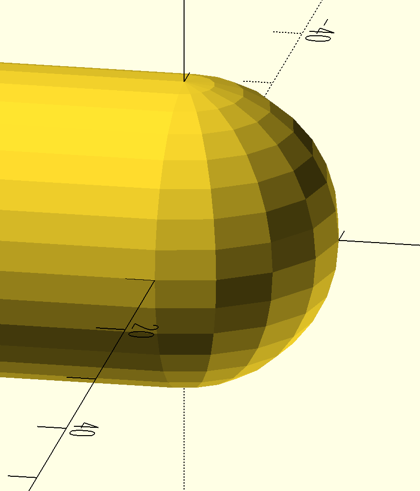

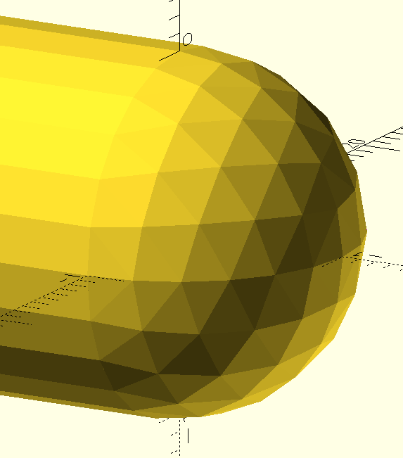

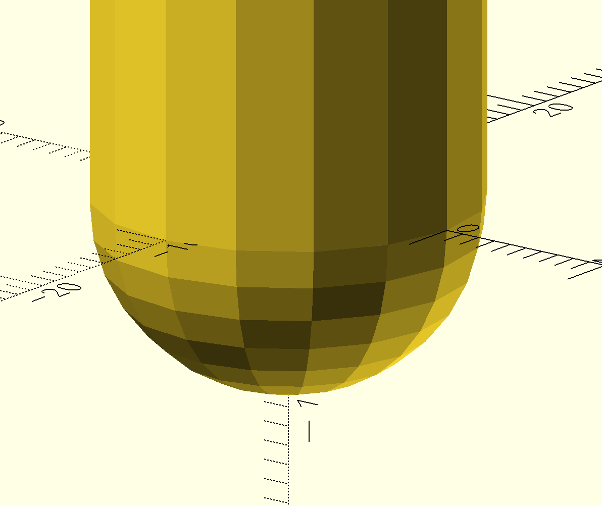

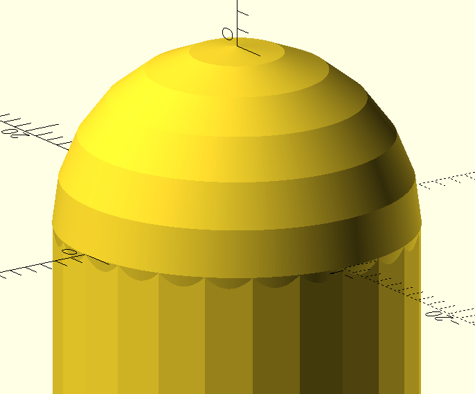

I guess there's always the question of what matters in terms of small
artifacts, and how high the facet count will be.  But the octahedron sphere
mates neatly with a cylinder along any axis, which is not true for the
other spheres.  For the sphere made by rotate_extrude applied to a
semicircle we get this:
The native sphere:
The octa sphere:
I suppose also the dual of the octa sphere mates neatly with a cylinder
along any axis.  It's kinda weird looking: you get this in BOSL2 if you ask
for a sphere that circumscribes rather than inscribing the ideal sphere:

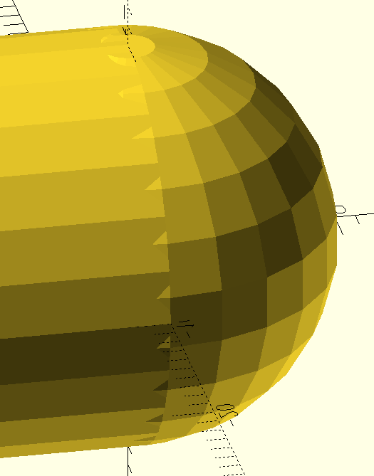

Adrian,
I can match my sphere to cylinders, I just need to be mindful of the $fn
that I choose for both:
[image: Screenshot 2026-07-04 at 11.44.21.png]
[image: Screenshot 2026-07-04 at 11.48.04.png]

Sat, Jul 4, 2026 5:09 PM
Ah, sorry, you're right.  I neglected to specify $fn correctly to the
rotate_extrude.

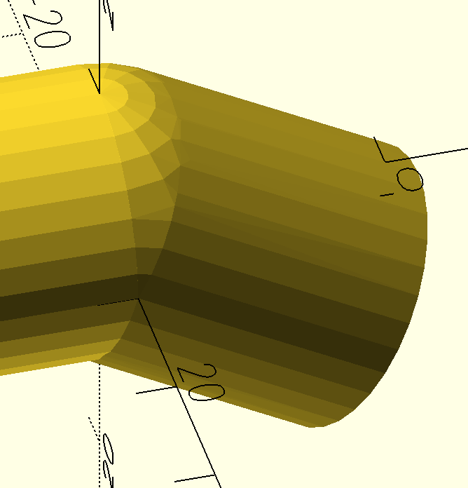

Sun, Jul 5, 2026 10:37 AM

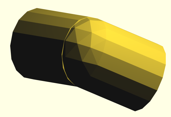

What happens if you add another cylinder at a different angle? Depending
on the number of segments and the angle, it may all match up nicely, (90
degree is OK for manifold) but, afaik, there is no general solution,
unless near enough is good enough. (angle= 120 deg for image below)
On 04/07/2026 18:09, Adrian Mariano via Discuss wrote:
