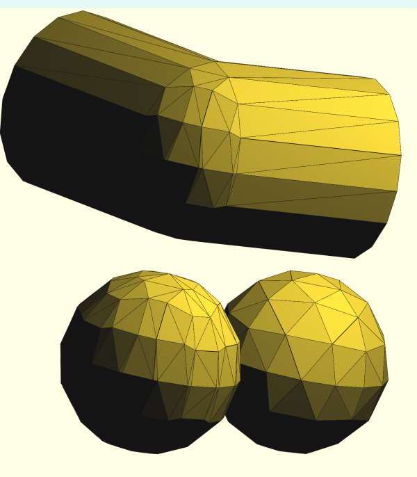

When I use rotate_extruded spheres, and then hull() each sphere-cylinder
combination, I get a "reasonably" good transition:
[image: Screenshot 2026-07-05 at 06.15.28.png]
However, I agree with Raymond. Since OpenSCAD approximates arcs with
segments, I doubt that there is a general solution.  We could "What if..."
this to death.

What i was trying to say, without using some sort of
blending/hull/whatever for a coarsely segmented sphere and cylinders,
you cannot get the edges to match. For manifold spheres, you can get a
match for 90 deg. I'm not sure if there is any other construction of a
sphere that allows, say, 45 deg angles as well, without other manipulation.
Hulling is OK, but it distorts the facets of the sphere, but depending
on the ultimate objective of using faceted cylinders, then that may not
matter.

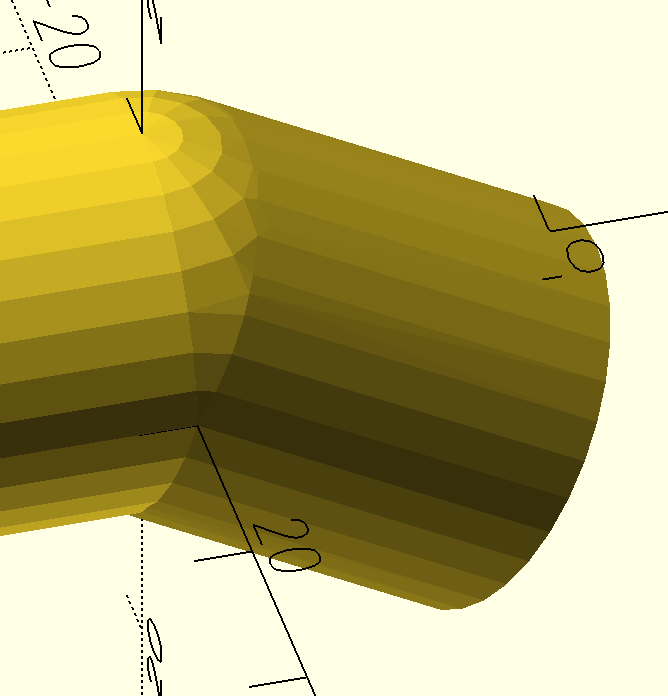

What happens if you add another cylinder at a different angle? Depending on the number of segments and the angle, it may all match up nicely, (90 degree is OK for manifold) but, afaik, there is no general solution, unless near enough is good enough.  (angle= 120 deg for image below)
It’s not a sphere, but I think you can always precisely fill the gap using an appropriate less-than-360° rotational extrusion of an appropriate semicircle.
