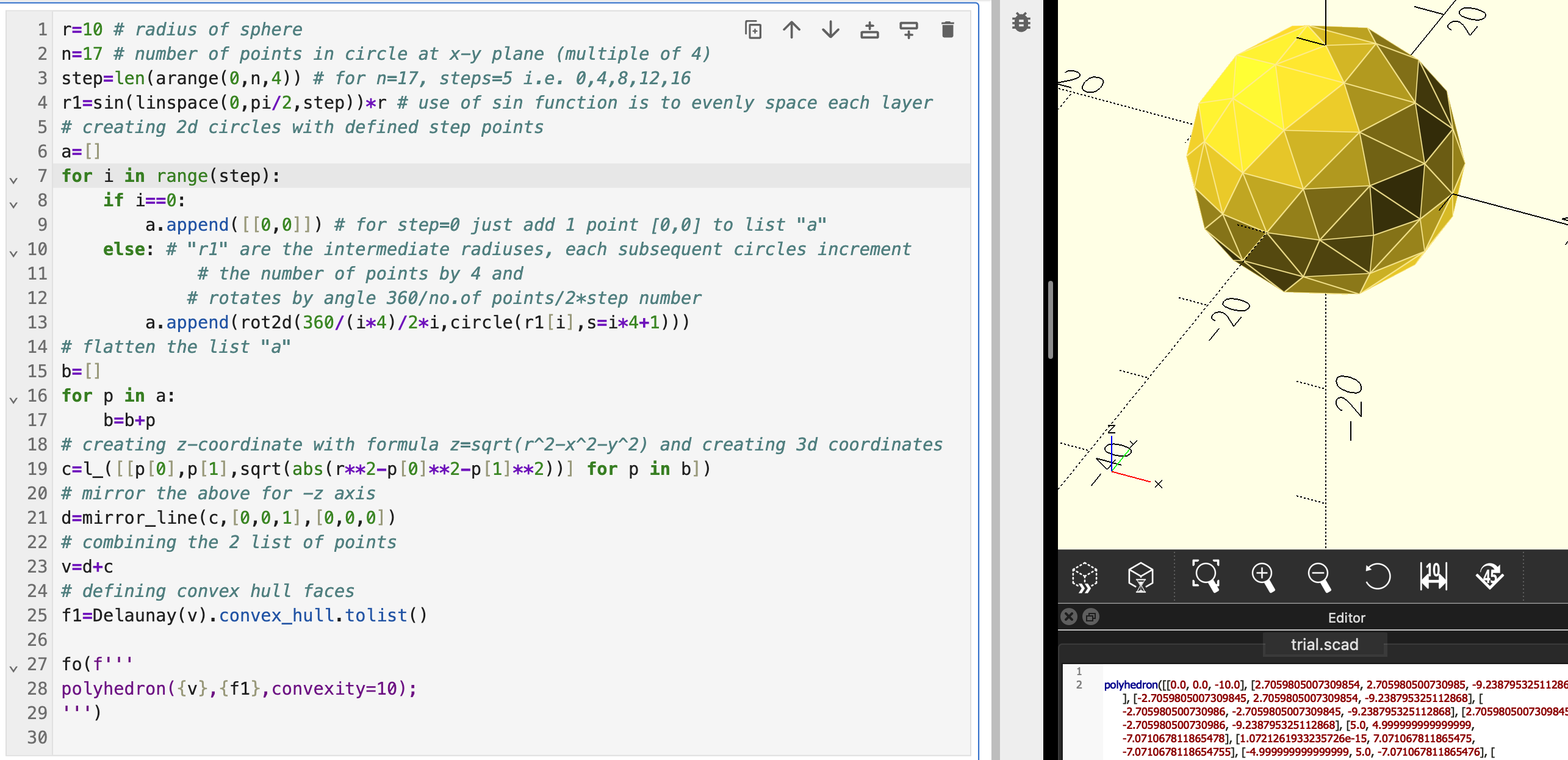

Here is the logic which works according to me:
[image: Screenshot 2026-07-02 at 10.40.52 PM.png]

Here is the logic which works according to me: [image: Screenshot 2026-07-02 at 10.40.52 PM.png] On Thu, 2 Jul 2026 at 19:24, Revar Desmera via Discuss < discuss@lists.openscad.org> wrote: > > > > On Jul 2, 2026, at 4:54 AM, Adrian Mariano via Discuss < > discuss@lists.openscad.org> wrote: > > > > Revar, it doesn't look like _make_octa_sphere depends deeply on library > code---really just one cumsum call. > > > > cumsum(), zrot(), zflip(), select(), flatten(), quantup(), segs()... > Yeah, okay, not as bad as I first thought. When I skimmed the code, I > kind of assumed it was going to end up using vnf_tri_array() and > vnf_merge(). I forgot I optimized those out before. > > For those who just want the conceptual framework for how to do octa > spheres, it boils down to: > > 1) Calculate how many vertices the sphere should have around the equator > (segs). This must be modulo 4, as we are going to triangulate one > spherical triangle and copy it 8 times (4 quadrants, top and bottom). > 2) subdivs = segs / 4 > 3) Assuming that the three corners of the spherical triangle are on the X+ > axis, the Y+ axis, and the Z+ axis, subdivide the three edges of the > spherical triangle by rotating a vector from each of the corner points > toward its neighbor corner by 90/subdiv degree steps. You now have all the > edge vertices. > 4) Take pairs of edges, and iterate their "rows" of vertices, so that you > get a related vertex from both edges. > 5) Get the axis of the greater circle that the two edge vertices are on. > (cross product) > 6) Subdivide that greater circle by the appropriate number of interior > vertices for that "row" by rotating between the edge vertices on the > greater circle axis. slerp() may have been involved. > 7) Do this for every possible pair of edges. This gets you three sets of > interior points that are slightly off from each other. > 8) Average the three sets of interior point vectors and normalize them. > You now have all the vertices for each subdivided octa "face". > 9) Copy this triangle (excluding duplicate vertices) rotating them by 0, > 90, 180, and 270 degrees. > 10) Copy this full set of "top" vertices, flipping across the XY plane to > get the "bottom"vertices. (excluding duplicate vertices again) > 11) Calculate faces between the vertices. > > At least, that's how I remember it working. > > - Revar > _______________________________________________ > OpenSCAD mailing list > To unsubscribe send an email to discuss-leave@lists.openscad.org
Thu, Jul 2, 2026 5:52 PM
Maybe it's just the orientation of your screenshot, but those triangle faces look oddly proportioned.  For reference, here's what the BOSL2 code generates.  We're fairly sure this is the optimal vertex placement, because the faces on the complete sphere look identical from the Top, Left, and Front views.
  • Revar

  8. Average the three sets of interior point vectors and normalize them.  You now have all the vertices for each subdivided octa "face".
  9. Copy this triangle (excluding duplicate vertices) rotating them by 0, 90, 180, and 270 degrees.
  10. Copy this full set of "top" vertices, flipping across the XY plane to get the "bottom"vertices.  (excluding duplicate vertices again)
  11. Calculate faces between the vertices.

Maybe it's just the orientation of your screenshot, but those triangle faces look oddly proportioned. For reference, here's what the BOSL2 code generates. We're fairly sure this is the optimal vertex placement, because the faces on the complete sphere look identical from the Top, Left, and Front views.   - Revar > On Jul 2, 2026, at 10:13 AM, Sanjeev Prabhakar <sprabhakar2006@gmail.com> wrote: > > Here is the logic which works according to me: > <Screenshot 2026-07-02 at 10.40.52 PM.png> > > On Thu, 2 Jul 2026 at 19:24, Revar Desmera via Discuss <discuss@lists.openscad.org <mailto:discuss@lists.openscad.org>> wrote: >> >> >> > On Jul 2, 2026, at 4:54 AM, Adrian Mariano via Discuss <discuss@lists.openscad.org <mailto:discuss@lists.openscad.org>> wrote: >> > >> > Revar, it doesn't look like _make_octa_sphere depends deeply on library code---really just one cumsum call. >> > >> >> cumsum(), zrot(), zflip(), select(), flatten(), quantup(), segs()... >> Yeah, okay, not as bad as I first thought. When I skimmed the code, I kind of assumed it was going to end up using vnf_tri_array() and vnf_merge(). I forgot I optimized those out before. >> >> For those who just want the conceptual framework for how to do octa spheres, it boils down to: >> >> 1) Calculate how many vertices the sphere should have around the equator (segs). This must be modulo 4, as we are going to triangulate one spherical triangle and copy it 8 times (4 quadrants, top and bottom). >> 2) subdivs = segs / 4 >> 3) Assuming that the three corners of the spherical triangle are on the X+ axis, the Y+ axis, and the Z+ axis, subdivide the three edges of the spherical triangle by rotating a vector from each of the corner points toward its neighbor corner by 90/subdiv degree steps. You now have all the edge vertices. >> 4) Take pairs of edges, and iterate their "rows" of vertices, so that you get a related vertex from both edges. >> 5) Get the axis of the greater circle that the two edge vertices are on. (cross product) >> 6) Subdivide that greater circle by the appropriate number of interior vertices for that "row" by rotating between the edge vertices on the greater circle axis. slerp() may have been involved. >> 7) Do this for every possible pair of edges. This gets you three sets of interior points that are slightly off from each other. >> 8) Average the three sets of interior point vectors and normalize them. You now have all the vertices for each subdivided octa "face". >> 9) Copy this triangle (excluding duplicate vertices) rotating them by 0, 90, 180, and 270 degrees. >> 10) Copy this full set of "top" vertices, flipping across the XY plane to get the "bottom"vertices. (excluding duplicate vertices again) >> 11) Calculate faces between the vertices. >> >> At least, that's how I remember it working. >> >> - Revar >> _______________________________________________ >> OpenSCAD mailing list >> To unsubscribe send an email to discuss-leave@lists.openscad.org <mailto:discuss-leave@lists.openscad.org>

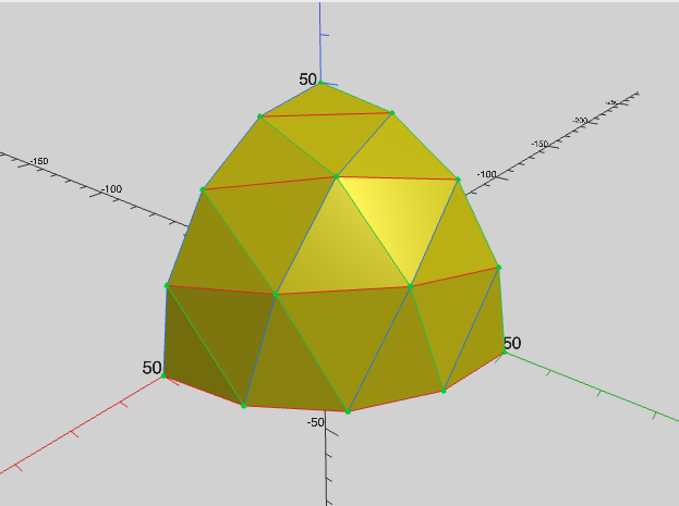

On 7/2/2026 8:40 AM, larry via Discuss wrote:
sphere(101);
Bounding box:
Min:  -101.00, -100.45, -100.45
Max:  101.00, 100.45, 100.45
Size: 202.00, 200.89, 200.89
Rendering finished.
This is because for those particular parameters the +Y and -Y poles are
truncated.  With default $fa/$fs/$fn, you get a 30-gon, which is not a
multiple of 4.
I think that centering problems can only happen in the X axis, that in
Y and Z everything is always symmetric.  It happens when the circle has
an odd number of sides.
X-axis centering is easy to see for "circles" with small odd numbers of
sides:
Here's a three-sided circle with a radius of 1.  Note that it protrudes
a great deal more +X than -X, and so in a sense is not centered.
The effect is not as pronounced for a five-sided circle, but it's still
there:
You can also see the Y-axis truncation in both figures.  The theoretical
circle extends further than the top and bottom vertexes.

Thu, Jul 2, 2026 8:15 PM
On 7/2/2026 9:01 AM, larry via Discuss wrote:
 OpenSCAD built-in spheres always have their +Z and -Z poles
truncated.
 If $fn is a multiple of 2 but not a multiple of 4, they also have
their +Y and -Y poles truncated.
 If $fn is not even a multiple of 2, it also has its -X pole
truncated.  (And the +Y/-Y poles are truncated differently.)
Yes, and if I want to see what the actual size and position of a sphere
(for example) is, I set $fn to 360.
Which gets you correct positions on X and Y, but so does $fn=4.  It's
the multiple-of-4 part that gets X and Y correct.
The Z positions are still slightly off, no matter the $fn, because they
are always off, sigh.
