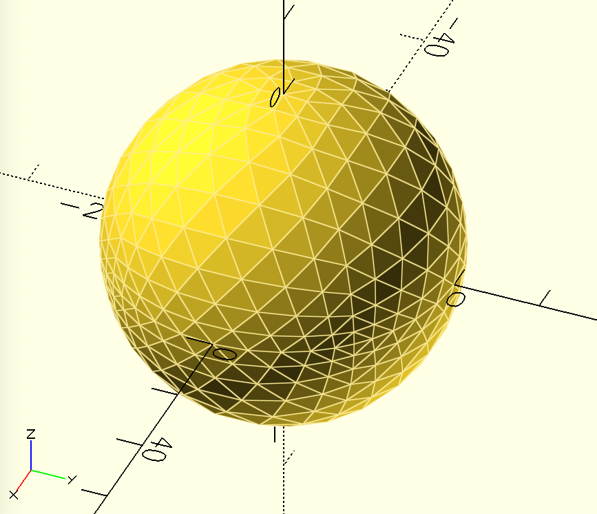

Interestingly, it appears that Manifold actually implements a proper Octa sphere in C++. - Revar > On Jul 1, 2026, at 4:37 PM, Revar Desmera <revarbat@gmail.com> wrote: > > I was the one who implemented octa sphere in BOSL2. It is noooot as simple as you might immediately think. > My first implementation was horribly naive, and not very good. That ended up sparking a long discussion at: > > https://github.com/openscad/openscad/pull/6100 > > I eventually got the BOSL2 implementation corrected, but it's definitely not simple, and would take a lot of work to make library-free. > If you want to take a shot at it, look for `_make_octa_sphere()` in shapes3d.scad. > > - Revar > > > >> On Jul 1, 2026, at 9:56 AM, Sanjeev Prabhakar via Discuss <discuss@lists.openscad.org> wrote: >> >> OK >> I will check that once I have some time >> But maybe you can explain it as i can see you have already implemented it. >> >> On Wed, 1 Jul, 2026, 3:51 pm Adrian Mariano via Discuss, <discuss@lists.openscad.org <mailto:discuss@lists.openscad.org>> wrote: >>> Sanjeev, you need to read farther because the cube sphere doesn't produce the best point alignment. Instead, you want a sphere based on an octahedron. >>> >>> On Tue, Jun 30, 2026 at 2:51 AM Sanjeev Prabhakar via Discuss <discuss@lists.openscad.org <mailto:discuss@lists.openscad.org>> wrote: >>>> I have read the first few pages of this cube sphere and the idea is that you create a cube with multiple points centered at origin. >>>> Then when you normalise all the points of that cube and multiply by some distance, say 'r', it will create a sphere with radius 'r'. >>>> This I think is a good idea and should not be very difficult to implement. >>>> >>>> >>>> On Tue, 30 Jun 2026 at 07:36, Leonard Martin Struttmann via Discuss <discuss@lists.openscad.org <mailto:discuss@lists.openscad.org>> wrote: >>>>> Wow! The octahedron based sphere would be complicated. I think that I’ll try something simpler: >>>>> >>>>> module MYsphere( r=1, d = undef) >>>>> { >>>>> function MYfn(f) = floor((f + 2) / 4) * 4; >>>>> >>>>> F = MYfn($fn); >>>>> R = is_undef(d) ? r : d / 2; >>>>> p = [ for (a=[-90:180/F:90]) polar_to_rectangular([ R, a ] ) ]; >>>>> >>>>> rotate_extrude(angle = 360, convexity = 10, $fn=F ) >>>>> polygon( p ); >>>>> } >>>>> >>>>> Len >>>>> >>>>> For $fn = 24 >>>>> <image.png> >>>>> _______________________________________________ >>>>> OpenSCAD mailing list >>>>> To unsubscribe send an email to discuss-leave@lists.openscad.org <mailto:discuss-leave@lists.openscad.org>_______________________________________________ >>>> OpenSCAD mailing list >>>> To unsubscribe send an email to discuss-leave@lists.openscad.org <mailto:discuss-leave@lists.openscad.org>_______________________________________________ >>> OpenSCAD mailing list >>> To unsubscribe send an email to discuss-leave@lists.openscad.org <mailto:discuss-leave@lists.openscad.org>_______________________________________________ >> OpenSCAD mailing list >> To unsubscribe send an email to discuss-leave@lists.openscad.org >
Thu, Jul 2, 2026 2:51 AM
Got some idea, something like this, points are not evenly spaced. But there
is no use of hull in this.
[image: Screenshot 2026-07-02 at 8.18.33 AM.png]

Got some idea, something like this, points are not evenly spaced. But there is no use of hull in this. [image: Screenshot 2026-07-02 at 8.18.33 AM.png] On Thu, 2 Jul 2026 at 05:07, Revar Desmera via Discuss < discuss@lists.openscad.org> wrote: > I was the one who implemented octa sphere in BOSL2. It is noooot as > simple as you might immediately think. > My first implementation was horribly naive, and not very good. That ended > up sparking a long discussion at: > > https://github.com/openscad/openscad/pull/6100 > > I eventually got the BOSL2 implementation corrected, but it's definitely > not simple, and would take a lot of work to make library-free. > If you want to take a shot at it, look for `_make_octa_sphere()` in > shapes3d.scad. > > - Revar > > > > On Jul 1, 2026, at 9:56 AM, Sanjeev Prabhakar via Discuss < > discuss@lists.openscad.org> wrote: > > OK > I will check that once I have some time > But maybe you can explain it as i can see you have already implemented it. > > On Wed, 1 Jul, 2026, 3:51 pm Adrian Mariano via Discuss, < > discuss@lists.openscad.org> wrote: > >> Sanjeev, you need to read farther because the cube sphere doesn't produce >> the best point alignment. Instead, you want a sphere based on an >> octahedron. >> >> On Tue, Jun 30, 2026 at 2:51 AM Sanjeev Prabhakar via Discuss < >> discuss@lists.openscad.org> wrote: >> >>> I have read the first few pages of this cube sphere and the idea is that >>> you create a cube with multiple points centered at origin. >>> Then when you normalise all the points of that cube and multiply by some >>> distance, say 'r', it will create a sphere with radius 'r'. >>> This I think is a good idea and should not be very difficult to >>> implement. >>> >>> >>> On Tue, 30 Jun 2026 at 07:36, Leonard Martin Struttmann via Discuss < >>> discuss@lists.openscad.org> wrote: >>> >>>> Wow! The octahedron based sphere would be complicated. I think that >>>> I’ll try something simpler: >>>> >>>> module MYsphere( r=1, d = undef) >>>> { >>>> function MYfn(f) = floor((f + 2) / 4) * 4; >>>> >>>> F = MYfn($fn); >>>> R = is_undef(d) ? r : d / 2; >>>> p = [ for (a=[-90:180/F:90]) polar_to_rectangular([ R, a ] ) ]; >>>> >>>> rotate_extrude(angle = 360, convexity = 10, $fn=F ) >>>> polygon( p ); >>>> } >>>> >>>> Len >>>> >>>> For $fn = 24 >>>> <image.png> >>>> _______________________________________________ >>>> OpenSCAD mailing list >>>> To unsubscribe send an email to discuss-leave@lists.openscad.org >>> >>> _______________________________________________ >>> OpenSCAD mailing list >>> To unsubscribe send an email to discuss-leave@lists.openscad.org >> >> _______________________________________________ >> OpenSCAD mailing list >> To unsubscribe send an email to discuss-leave@lists.openscad.org > > _______________________________________________ > OpenSCAD mailing list > To unsubscribe send an email to discuss-leave@lists.openscad.org > > > _______________________________________________ > OpenSCAD mailing list > To unsubscribe send an email to discuss-leave@lists.openscad.org
Thu, Jul 2, 2026 4:01 AM

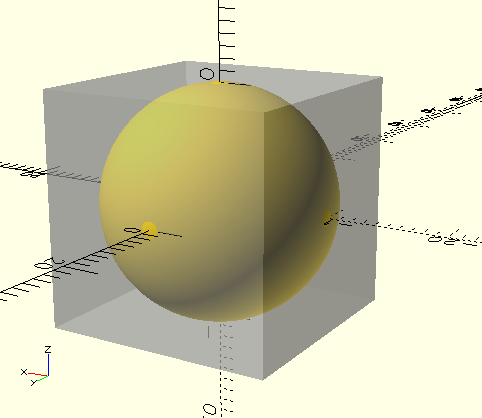

I have often wondered why, when I render something that should be
centred, the bounding box shows it to be non-centred.
This discussion seems to show me why that is.
Just because of the way I think, I wrote it this way.
I purposely made the sphere 0.025 larger for better visualization.
$fn=$preview ? 60 : 360;
%left(10) fwd(10) down(10)
cube(20);
sphere(10.025,$fn=360);

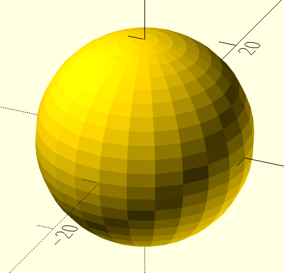

OpenSCAD built-in spheres always have their +Z and -Z poles truncated.
If $fn is a multiple of 2 but not a multiple of 4, they also have their
+Y and -Y poles truncated.
If $fn is not even a multiple of 2, it also has its -X pole truncated.
(And the +Y/-Y poles are truncated differently.)
There are better strategies for constructing spheres, that ensure that
all eight poles are in the right place, but alas OpenSCAD doesn't use
them, and there's a backward compatibility argument against improving
the algorithm.

Larry, I don't understand what you mean about objects coming out
non-centered.  Your example appears centered to me, with exactly equal
circles sticking out from the cube at each face.
Revar, it doesn't look like _make_octa_sphere depends deeply on library
code---really just one cumsum call.
On Thu, Jul 2, 2026 at 12:02 AM larry via Discuss <
On Mon, 2026-06-29 at 19:31 -0400, Adrian Mariano via Discuss wrote:
The right solution is to use the octahedron based sphere.  If you do
that, then for $fn=4, it always works.  The octahedron based sphere
is also much more symmetric and doesn't have extra triangles at poles
somewhere so it's more spherical for the same triangle count.  You
can go implement it yourself if you're a masochist.  You can get it
from BOSL2.  You can, I think, find BOSL2-free code in the discussion
of an openscad issue about this very problem, or actually on the
linked PR, where there was a lengthy discussion about how to
implement this.  It's not the simplest thing to implement.  There is
some subtlety in exactly how the triangles of the octahedron get
subdivided.
https://github.com/openscad/openscad/issues/1983
cube(20);
On Mon, Jun 29, 2026 at 7:21 PM Leonard Martin Struttmann via Discuss
Raymond,
Your solution, just pushes points out at the appropriate places to
make the sphere look like it fits the box.
Yes, I agree.  However, for my current design, that is sufficient.
I need an approximate sphere and for there to be vertices on each
of the axes.  Using $fn=48 for the sphere(), what I normally render
at, the differences are minimal.
If the $fn is a multiple of four, it always fits.
Yes, I could certainly use that constraint.  But, that only works
for circles.  That still leaves the flat spots at the poles of
sphere.
Len
