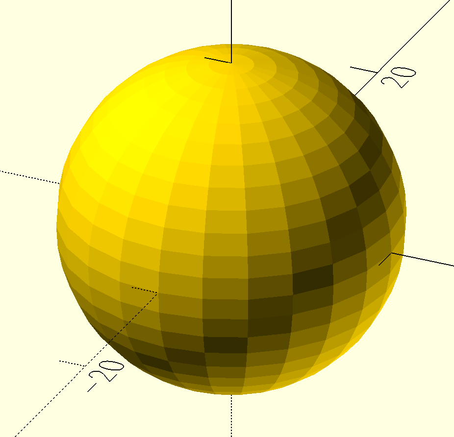

Wow!  The octahedron based sphere would be complicated.  I think that I’ll
try something simpler:
module MYsphere( r=1, d = undef)
function MYfn(f) = floor((f + 2) / 4) * 4;
F = MYfn($fn);
R = is_undef(d) ? r : d / 2;
p = [ for (a=[-90:180/F:90]) polar_to_rectangular([ R, a ] ) ];
rotate_extrude(angle = 360, convexity = 10, $fn=F )
polygon( p );
Len

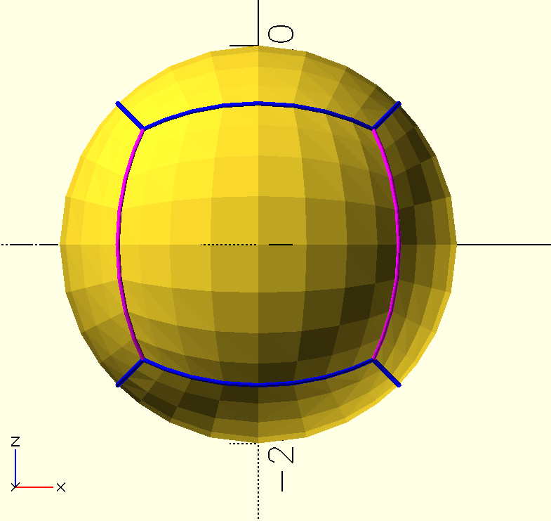

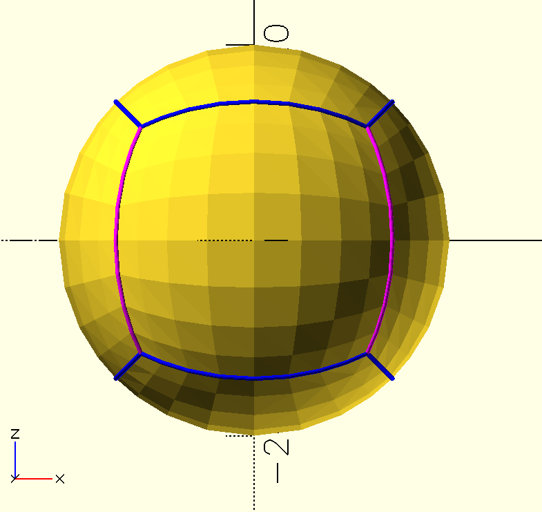

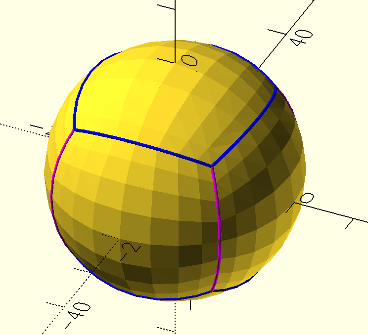

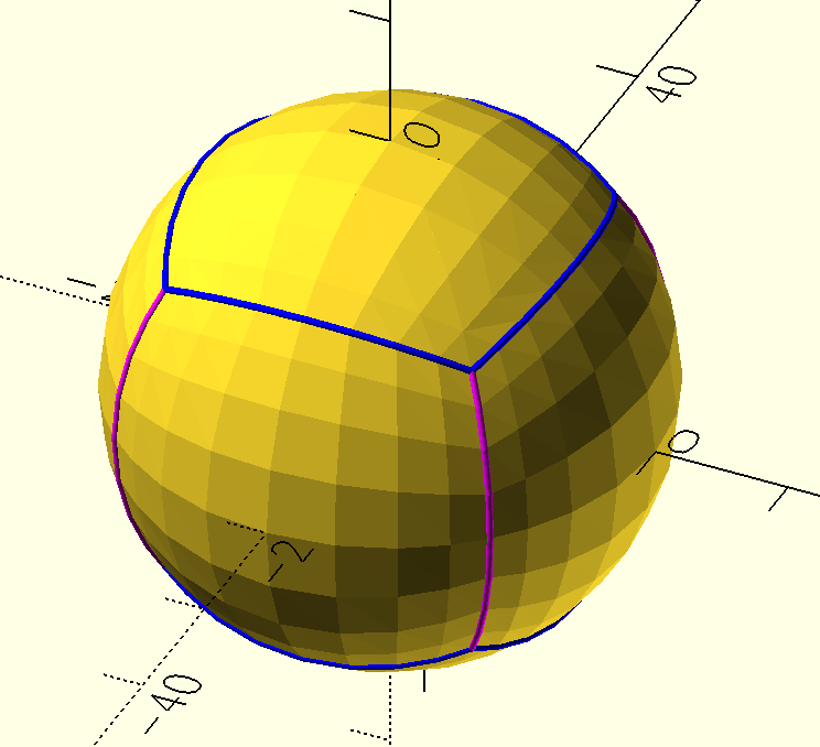

Tue, Jun 30, 2026 6:50 AM
I have read the first few pages of this cube sphere and the idea is that
you create a cube with multiple points centered at origin.
Then when you normalise all the points of that cube and multiply by some
distance, say 'r', it will create a sphere with radius 'r'.
This I think is a good idea and should not be very difficult to implement.

I have read the first few pages of this cube sphere and the idea is that you create a cube with multiple points centered at origin. Then when you normalise all the points of that cube and multiply by some distance, say 'r', it will create a sphere with radius 'r'. This I think is a good idea and should not be very difficult to implement. On Tue, 30 Jun 2026 at 07:36, Leonard Martin Struttmann via Discuss < discuss@lists.openscad.org> wrote: > Wow! The octahedron based sphere would be complicated. I think that > I’ll try something simpler: > > module MYsphere( r=1, d = undef) > > { > > function MYfn(f) = floor((f + 2) / 4) * 4; > > F = MYfn($fn); > > R = is_undef(d) ? r : d / 2; > > p = [ for (a=[-90:180/F:90]) polar_to_rectangular([ R, a ] ) ]; > > rotate_extrude(angle = 360, convexity = 10, $fn=F ) > > polygon( p ); > > } > > Len > > For $fn = 24 > [image: image.png] > _______________________________________________ > OpenSCAD mailing list > To unsubscribe send an email to discuss-leave@lists.openscad.org
Tue, Jun 30, 2026 7:56 AM
[image: Screenshot 2026-06-30 at 1.23.43 PM.png][image: Screenshot
2026-06-30 at 1.24.44 PM.png]
On Tue, 30 Jun 2026 at 12:20, Sanjeev Prabhakar sprabhakar2006@gmail.com

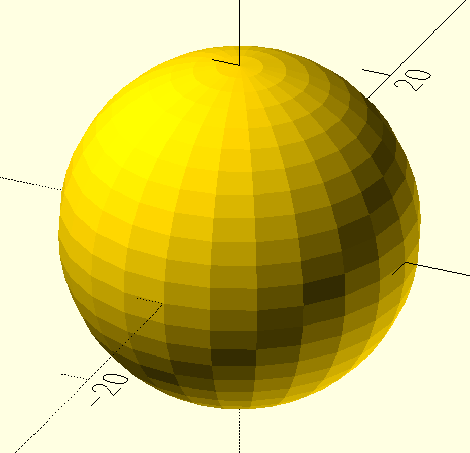

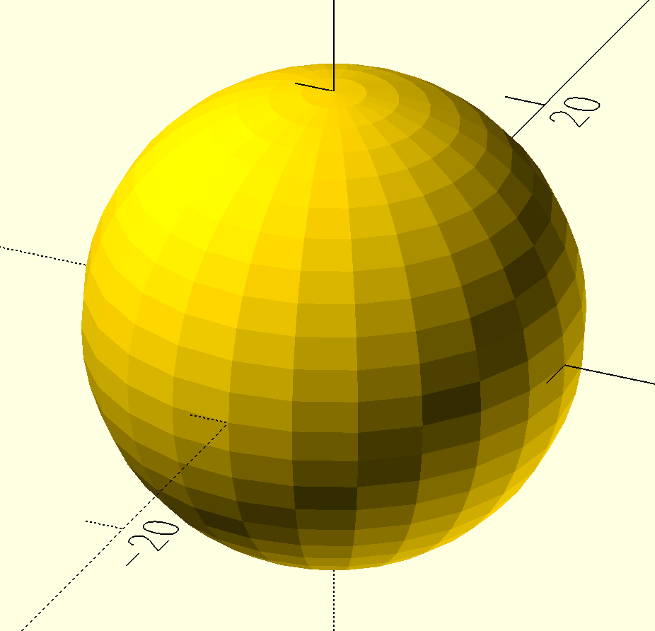

Tue, Jun 30, 2026 9:18 AM
I replaced sphere with my own version that rotate_extrudes a semicircle
that has a multiple of 4 points on the original circle.
