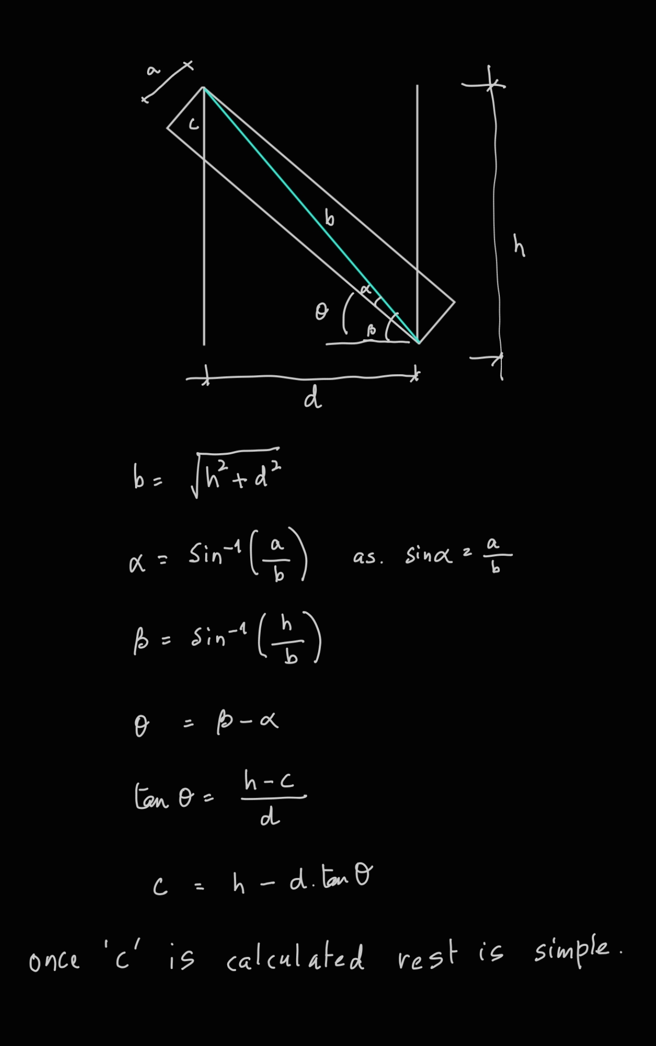

Here's what Claude came up with:
module test( S, L, W )
inner = sqrt(S * S + L * L - W * W);
factor = (S * inner - L * W) / (S * S - W * W);
face_length  = S * factor;  // d: long diagonal sides
stud_contact = W * factor;  // h: short vertical sides
points = [ [ 0,0 ],
[ 0, stud_contact ],
[ S, L ],
[ S, L-stud_contact ]] ;
rotate( [ 90, 0, 0 ])
rotate( [ 0, 90, 0 ])
linear_extrude(height = 2, center = false, convexity = 10, twist = 0,
slices = 20, scale = 1.0)
polygon(points = points);
T=96;  //ggb: how tall is the framing
S=28;  //ggb: spacing between the framing members
translate([0,-2,0])cube([4,2,T]);
translate([0,S,0]) cube([4,2,T]);
#v2x4_diagonal(S, T);
test( S, T, 4 );

Talking about the math, there seems to not be enough information in the
parameters to which I've constrained the problem, for the parallelogram
that would be its height (the 4" board dimension), and the diagonal length
(sqrt(SS + TT)).  Or, am I just too ill-informed to see it.

On 4/14/2026 3:10 PM, Leonard Martin Struttmann via Discuss wrote:
And, on top of that, it doesn't seem to be correct.  When I ran that
code, the diagonal brace turned out to be 2x4.63 instead of the specified
2x4.

Disclaimer: I'm not a math person.
I'm building a CAD model of a vintage railroad baggage car, to help
with
the visualization of design for a restoration project. In modeling the
framing internal to the walls, I need diagonal members between the
verticals; my first module to do that was 'carpenter style', where I
laid the diagonal between two vertical members and used difference() to
cut it.  This required an angle parameter that I had to 'scooch' around
to get the right angle.
What I wanted was a module that just took the height and spacing
numbers
and made a parallelogram to fit and extruded it to the right
thickness.
So, I spent a few forays into the internets, searching for the math to
do that.  And, I just couldn't find it, even the AI search summaries
didn't complete the solution.  I finally gave in to the vibe coding
thing, and took the problem to Microsoft CoPilot, with which I had some
success building an OpenGL renderer.  To describe the problem I used
compass cardinal points to lay out the space, NE, NW, SE, SW to define
the four corners of the parallelogram.  Took 5 iterations to get it
close, and it still was plotting the NE corner on the wrong side of the
Y axis.  I finally just told it to negate that corner's vertical
component, ta-da, works.
Thing is, I do not understand the methodology.  I've inspected the
intermediate variables and I just don't have the math chops to
understand how the vectors yield the parallelogram sides.  Here's the
code:

I offer this in the public domain, use as you see fit.  All I'd like to
get is some sort of explanation as to how it works...

Nice visualization! On 4/15/2026 1:29 PM, Sanjeev Prabhakar via Discuss wrote: > I would prefer to do this by hand > > > > > > On Wed, 15 Apr 2026, 00:40 Glenn Butcher via Discuss, > <discuss@lists.openscad.org> wrote: > > Disclaimer: I'm not a math person. > > I'm building a CAD model of a vintage railroad baggage car, to > help with > the visualization of design for a restoration project. In modeling > the > framing internal to the walls, I need diagonal members between the > verticals; my first module to do that was 'carpenter style', where I > laid the diagonal between two vertical members and used > difference() to > cut it.  This required an angle parameter that I had to 'scooch' > around > to get the right angle. > > What I wanted was a module that just took the height and spacing > numbers > and made a parallelogram to fit and extruded it to the right > thickness. > So, I spent a few forays into the internets, searching for the > math to > do that.  And, I just couldn't find it, even the AI search summaries > didn't complete the solution.  I finally gave in to the vibe coding > thing, and took the problem to Microsoft CoPilot, with which I had > some > success building an OpenGL renderer.  To describe the problem I used > compass cardinal points to lay out the space, NE, NW, SE, SW to > define > the four corners of the parallelogram.  Took 5 iterations to get it > close, and it still was plotting the NE corner on the wrong side > of the > Y axis.  I finally just told it to negate that corner's vertical > component, ta-da, works. > > Thing is, I do not understand the methodology.  I've inspected the > intermediate variables and I just don't have the math chops to > understand how the vectors yield the parallelogram sides. Here's > the code: > > //algorithm courtesy Microsoft CoPilot: > module v2x4_diagonal(S, T) { >      //ggb: diagonal member dimensions >      w=4;  //ggb: height of the parallelogram >      t=2; > >      // Upper edge endpoints >      NW = [0, T]; >      SE = [S, 0]; > >      // Diagonal direction >      dx = S; >      dy = -T; >      L  = sqrt(dx*dx + dy*dy); > >      // Perpendicular unit vector (points downward) >      px = -T / L; >      py = -S / L; > >      // Offset vector for lower edge >      ox = w * px; >      oy = w * py; > >      // Lower edge parametric line: P(t) = NW + (ox, oy) + t*(dx, dy) > >      // Intersection with x = 0 → SW >      t0 = -ox / dx; >      SW = [0, >            T + oy + t0 * dy]; > >      // Intersection with x = S → NE >      t1 = (S - ox) / dx; >      NE = [S, >            -(T + oy + t1 * dy)];  //ggb: I had to negate the Y > coordinate > >      // Correct winding order: NW → NE → SE → SW >      // ggb: extrude works in xy plane, rotate and translate to > make it > 'vertical', >      //        along the wall frame axis, Y. >      rotate([90,0,-90]) >          translate([-S,0,-2]) >              linear_extrude(height = t) >                  polygon(points=[NW, NE, SE, SW]); > } > > T=96;  //ggb: how tall is the framing > S=28;  //ggb: spacing between the framing members > > translate([0,-2,0])cube([4,2,T]); > translate([0,S,0]) cube([4,2,T]); > > color("green") v2x4_diagonal(S, T); > > I offer this in the public domain, use as you see fit.  All I'd > like to > get is some sort of explanation as to how it works... > > Thanks, > Glenn Butcher > > > > _______________________________________________ > OpenSCAD mailing list > To unsubscribe send an email to discuss-leave@lists.openscad.org > > > _______________________________________________ > OpenSCAD mailing list > To unsubscribe send an email todiscuss-leave@lists.openscad.org -- This email has been checked for viruses by AVG antivirus software. www.avg.com
Wed, Apr 15, 2026 6:03 PM
I did it myself by hand using similar triangles to directly obtain c for
the solution I posted without any trig and without introducing so many
extra parameters. I think this approach is unnecessarily complicated.
On Wed, Apr 15, 2026 at 13:30 Sanjeev Prabhakar via Discuss <
On Wed, 15 Apr 2026, 00:40 Glenn Butcher via Discuss, <

I'm building a CAD model of a vintage railroad baggage car, to help with
What I wanted was a module that just took the height and spacing numbers
and made a parallelogram to fit and extruded it to the right thickness.
code:
