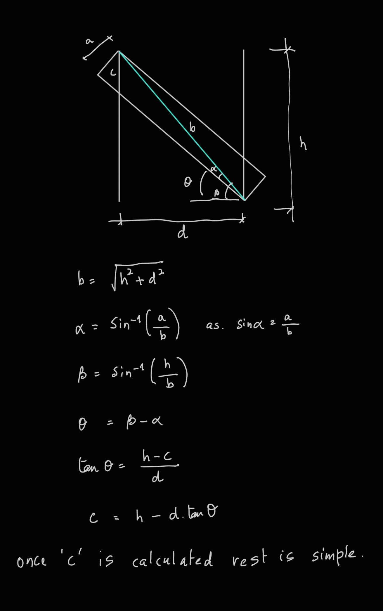

Ah, an approach I can understand, thanks, Sanjeev.  This is not a diss
on the non-trig approaches, it just reflects my limited knowledge of
math.  Ironically, it's the trig that I understand, given I flunked that
in high school, which set me off on a long, ill-advised path of math
avoidance.  Yes, you can get a doctorate in computer science with only
four math courses, total...  :D
No, I spent hours trying to divine relevant angles, and I kept
constraining myself to the parallelogram.  Didn't think to just extend
the bottom edge out to make a right triangle with the board width.
I want to thank everyone who pitched in an algorithm.  I was just going
to use what CoPilot gave me, but that felt unsatisfying. And, turned out
to be not that right.  This bit of discourse poignantly demonstrates a
fundamental concept in engineering, multiple sets of eyes on a a
problem.  Human eyes, IMHO...

Ah, an approach I can understand, thanks, Sanjeev.  This is not a diss on the non-trig approaches, it just reflects my limited knowledge of math.  Ironically, it's the trig that I understand, given I flunked that in high school, which set me off on a long, ill-advised path of math avoidance.  Yes, you can get a doctorate in computer science with only four math courses, total...  :D No, I spent hours trying to divine relevant angles, and I kept constraining myself to the parallelogram.  Didn't think to just extend the bottom edge out to make a right triangle with the board width. I want to thank everyone who pitched in an algorithm.  I was just going to use what CoPilot gave me, but that felt unsatisfying. And, turned out to be not that right.  This bit of discourse poignantly demonstrates a fundamental concept in engineering, multiple sets of eyes on a a problem.  Human eyes, IMHO... Regards, Glenn Butcher On 4/15/2026 11:29 AM, Sanjeev Prabhakar wrote: > I would prefer to do this by hand > > > > > > On Wed, 15 Apr 2026, 00:40 Glenn Butcher via Discuss, > <discuss@lists.openscad.org> wrote: > > Disclaimer: I'm not a math person. > > I'm building a CAD model of a vintage railroad baggage car, to > help with > the visualization of design for a restoration project. In modeling > the > framing internal to the walls, I need diagonal members between the > verticals; my first module to do that was 'carpenter style', where I > laid the diagonal between two vertical members and used > difference() to > cut it.  This required an angle parameter that I had to 'scooch' > around > to get the right angle. > > What I wanted was a module that just took the height and spacing > numbers > and made a parallelogram to fit and extruded it to the right > thickness. > So, I spent a few forays into the internets, searching for the > math to > do that.  And, I just couldn't find it, even the AI search summaries > didn't complete the solution.  I finally gave in to the vibe coding > thing, and took the problem to Microsoft CoPilot, with which I had > some > success building an OpenGL renderer.  To describe the problem I used > compass cardinal points to lay out the space, NE, NW, SE, SW to > define > the four corners of the parallelogram.  Took 5 iterations to get it > close, and it still was plotting the NE corner on the wrong side > of the > Y axis.  I finally just told it to negate that corner's vertical > component, ta-da, works. > > Thing is, I do not understand the methodology.  I've inspected the > intermediate variables and I just don't have the math chops to > understand how the vectors yield the parallelogram sides. Here's > the code: > > //algorithm courtesy Microsoft CoPilot: > module v2x4_diagonal(S, T) { >      //ggb: diagonal member dimensions >      w=4;  //ggb: height of the parallelogram >      t=2; > >      // Upper edge endpoints >      NW = [0, T]; >      SE = [S, 0]; > >      // Diagonal direction >      dx = S; >      dy = -T; >      L  = sqrt(dx*dx + dy*dy); > >      // Perpendicular unit vector (points downward) >      px = -T / L; >      py = -S / L; > >      // Offset vector for lower edge >      ox = w * px; >      oy = w * py; > >      // Lower edge parametric line: P(t) = NW + (ox, oy) + t*(dx, dy) > >      // Intersection with x = 0 → SW >      t0 = -ox / dx; >      SW = [0, >            T + oy + t0 * dy]; > >      // Intersection with x = S → NE >      t1 = (S - ox) / dx; >      NE = [S, >            -(T + oy + t1 * dy)];  //ggb: I had to negate the Y > coordinate > >      // Correct winding order: NW → NE → SE → SW >      // ggb: extrude works in xy plane, rotate and translate to > make it > 'vertical', >      //        along the wall frame axis, Y. >      rotate([90,0,-90]) >          translate([-S,0,-2]) >              linear_extrude(height = t) >                  polygon(points=[NW, NE, SE, SW]); > } > > T=96;  //ggb: how tall is the framing > S=28;  //ggb: spacing between the framing members > > translate([0,-2,0])cube([4,2,T]); > translate([0,S,0]) cube([4,2,T]); > > color("green") v2x4_diagonal(S, T); > > I offer this in the public domain, use as you see fit.  All I'd > like to > get is some sort of explanation as to how it works... > > Thanks, > Glenn Butcher > > > > _______________________________________________ > OpenSCAD mailing list > To unsubscribe send an email to discuss-leave@lists.openscad.org >
Wed, Apr 15, 2026 8:48 PM
Here's the similar triangle approach.

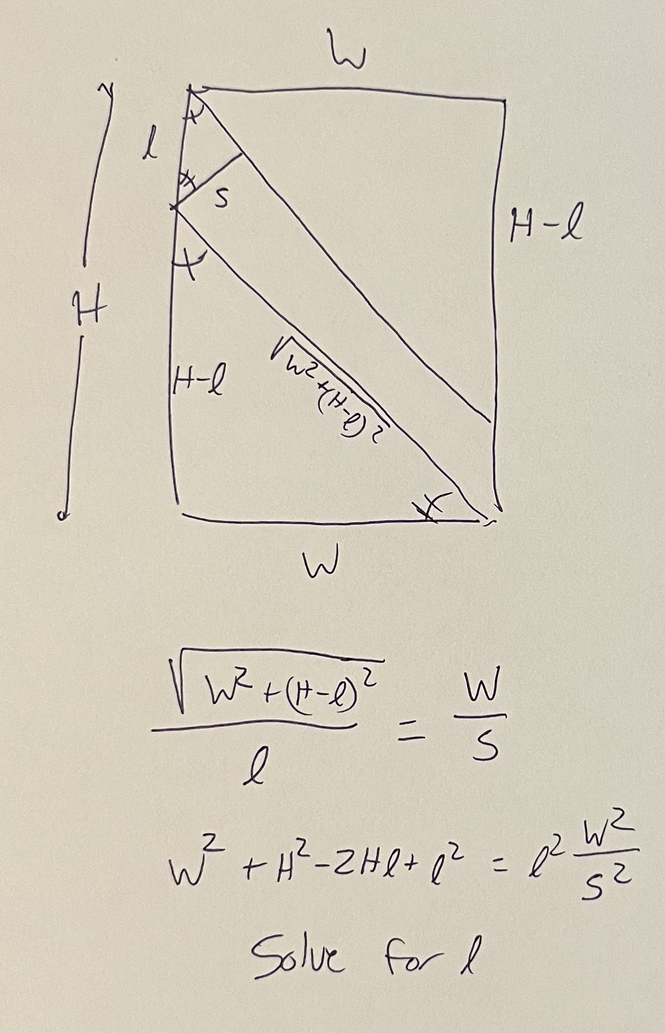

Here's the similar triangle approach. On Wed, Apr 15, 2026 at 3:08 PM Glenn Butcher via Discuss < discuss@lists.openscad.org> wrote: > Ah, an approach I can understand, thanks, Sanjeev. This is not a diss on > the non-trig approaches, it just reflects my limited knowledge of math. > Ironically, it's the trig that I understand, given I flunked that in high > school, which set me off on a long, ill-advised path of math avoidance. > Yes, you can get a doctorate in computer science with only four math > courses, total... :D > > No, I spent hours trying to divine relevant angles, and I kept > constraining myself to the parallelogram. Didn't think to just extend the > bottom edge out to make a right triangle with the board width. > > I want to thank everyone who pitched in an algorithm. I was just going to > use what CoPilot gave me, but that felt unsatisfying. And, turned out to > be not that right. This bit of discourse poignantly demonstrates a > fundamental concept in engineering, multiple sets of eyes on a a problem. > Human eyes, IMHO... > > Regards, > Glenn Butcher > On 4/15/2026 11:29 AM, Sanjeev Prabhakar wrote: > > I would prefer to do this by hand > > > > > > On Wed, 15 Apr 2026, 00:40 Glenn Butcher via Discuss, < > discuss@lists.openscad.org> wrote: > >> Disclaimer: I'm not a math person. >> >> I'm building a CAD model of a vintage railroad baggage car, to help with >> the visualization of design for a restoration project. In modeling the >> framing internal to the walls, I need diagonal members between the >> verticals; my first module to do that was 'carpenter style', where I >> laid the diagonal between two vertical members and used difference() to >> cut it. This required an angle parameter that I had to 'scooch' around >> to get the right angle. >> >> What I wanted was a module that just took the height and spacing numbers >> and made a parallelogram to fit and extruded it to the right thickness. >> So, I spent a few forays into the internets, searching for the math to >> do that. And, I just couldn't find it, even the AI search summaries >> didn't complete the solution. I finally gave in to the vibe coding >> thing, and took the problem to Microsoft CoPilot, with which I had some >> success building an OpenGL renderer. To describe the problem I used >> compass cardinal points to lay out the space, NE, NW, SE, SW to define >> the four corners of the parallelogram. Took 5 iterations to get it >> close, and it still was plotting the NE corner on the wrong side of the >> Y axis. I finally just told it to negate that corner's vertical >> component, ta-da, works. >> >> Thing is, I do not understand the methodology. I've inspected the >> intermediate variables and I just don't have the math chops to >> understand how the vectors yield the parallelogram sides. Here's the >> code: >> >> //algorithm courtesy Microsoft CoPilot: >> module v2x4_diagonal(S, T) { >> //ggb: diagonal member dimensions >> w=4; //ggb: height of the parallelogram >> t=2; >> >> // Upper edge endpoints >> NW = [0, T]; >> SE = [S, 0]; >> >> // Diagonal direction >> dx = S; >> dy = -T; >> L = sqrt(dx*dx + dy*dy); >> >> // Perpendicular unit vector (points downward) >> px = -T / L; >> py = -S / L; >> >> // Offset vector for lower edge >> ox = w * px; >> oy = w * py; >> >> // Lower edge parametric line: P(t) = NW + (ox, oy) + t*(dx, dy) >> >> // Intersection with x = 0 → SW >> t0 = -ox / dx; >> SW = [0, >> T + oy + t0 * dy]; >> >> // Intersection with x = S → NE >> t1 = (S - ox) / dx; >> NE = [S, >> -(T + oy + t1 * dy)]; //ggb: I had to negate the Y coordinate >> >> // Correct winding order: NW → NE → SE → SW >> // ggb: extrude works in xy plane, rotate and translate to make it >> 'vertical', >> // along the wall frame axis, Y. >> rotate([90,0,-90]) >> translate([-S,0,-2]) >> linear_extrude(height = t) >> polygon(points=[NW, NE, SE, SW]); >> } >> >> T=96; //ggb: how tall is the framing >> S=28; //ggb: spacing between the framing members >> >> translate([0,-2,0])cube([4,2,T]); >> translate([0,S,0]) cube([4,2,T]); >> >> color("green") v2x4_diagonal(S, T); >> >> I offer this in the public domain, use as you see fit. All I'd like to >> get is some sort of explanation as to how it works... >> >> Thanks, >> Glenn Butcher >> >> >> >> _______________________________________________ >> OpenSCAD mailing list >> To unsubscribe send an email to discuss-leave@lists.openscad.org > > _______________________________________________ > OpenSCAD mailing list > To unsubscribe send an email to discuss-leave@lists.openscad.org
Thu, Apr 16, 2026 12:56 AM
Thanks
Initially i did the same, but to explain majority of people would be
difficult as i am not sure how many here would know how to solve quadratic
equations.
On Wed, 15 Apr 2026, 23:33 Adrian Mariano via Discuss, <
I did it myself by hand using similar triangles to directly obtain c for
the solution I posted without any trig and without introducing so many

Thanks Initially i did the same, but to explain majority of people would be difficult as i am not sure how many here would know how to solve quadratic equations. On Wed, 15 Apr 2026, 23:33 Adrian Mariano via Discuss, < discuss@lists.openscad.org> wrote: > I did it myself by hand using similar triangles to directly obtain c for > the solution I posted without any trig and without introducing so many > extra parameters. I think this approach is unnecessarily complicated. > > On Wed, Apr 15, 2026 at 13:30 Sanjeev Prabhakar via Discuss < > discuss@lists.openscad.org> wrote: > >> I would prefer to do this by hand >> >> >> >> >> >> On Wed, 15 Apr 2026, 00:40 Glenn Butcher via Discuss, < >> discuss@lists.openscad.org> wrote: >> >>> Disclaimer: I'm not a math person. >>> >>> I'm building a CAD model of a vintage railroad baggage car, to help with >>> the visualization of design for a restoration project. In modeling the >>> framing internal to the walls, I need diagonal members between the >>> verticals; my first module to do that was 'carpenter style', where I >>> laid the diagonal between two vertical members and used difference() to >>> cut it. This required an angle parameter that I had to 'scooch' around >>> to get the right angle. >>> >>> What I wanted was a module that just took the height and spacing numbers >>> and made a parallelogram to fit and extruded it to the right thickness. >>> So, I spent a few forays into the internets, searching for the math to >>> do that. And, I just couldn't find it, even the AI search summaries >>> didn't complete the solution. I finally gave in to the vibe coding >>> thing, and took the problem to Microsoft CoPilot, with which I had some >>> success building an OpenGL renderer. To describe the problem I used >>> compass cardinal points to lay out the space, NE, NW, SE, SW to define >>> the four corners of the parallelogram. Took 5 iterations to get it >>> close, and it still was plotting the NE corner on the wrong side of the >>> Y axis. I finally just told it to negate that corner's vertical >>> component, ta-da, works. >>> >>> Thing is, I do not understand the methodology. I've inspected the >>> intermediate variables and I just don't have the math chops to >>> understand how the vectors yield the parallelogram sides. Here's the >>> code: >>> >>> //algorithm courtesy Microsoft CoPilot: >>> module v2x4_diagonal(S, T) { >>> //ggb: diagonal member dimensions >>> w=4; //ggb: height of the parallelogram >>> t=2; >>> >>> // Upper edge endpoints >>> NW = [0, T]; >>> SE = [S, 0]; >>> >>> // Diagonal direction >>> dx = S; >>> dy = -T; >>> L = sqrt(dx*dx + dy*dy); >>> >>> // Perpendicular unit vector (points downward) >>> px = -T / L; >>> py = -S / L; >>> >>> // Offset vector for lower edge >>> ox = w * px; >>> oy = w * py; >>> >>> // Lower edge parametric line: P(t) = NW + (ox, oy) + t*(dx, dy) >>> >>> // Intersection with x = 0 → SW >>> t0 = -ox / dx; >>> SW = [0, >>> T + oy + t0 * dy]; >>> >>> // Intersection with x = S → NE >>> t1 = (S - ox) / dx; >>> NE = [S, >>> -(T + oy + t1 * dy)]; //ggb: I had to negate the Y coordinate >>> >>> // Correct winding order: NW → NE → SE → SW >>> // ggb: extrude works in xy plane, rotate and translate to make it >>> 'vertical', >>> // along the wall frame axis, Y. >>> rotate([90,0,-90]) >>> translate([-S,0,-2]) >>> linear_extrude(height = t) >>> polygon(points=[NW, NE, SE, SW]); >>> } >>> >>> T=96; //ggb: how tall is the framing >>> S=28; //ggb: spacing between the framing members >>> >>> translate([0,-2,0])cube([4,2,T]); >>> translate([0,S,0]) cube([4,2,T]); >>> >>> color("green") v2x4_diagonal(S, T); >>> >>> I offer this in the public domain, use as you see fit. All I'd like to >>> get is some sort of explanation as to how it works... >>> >>> Thanks, >>> Glenn Butcher >>> >>> >>> >>> _______________________________________________ >>> OpenSCAD mailing list >>> To unsubscribe send an email to discuss-leave@lists.openscad.org >> >> _______________________________________________ >> OpenSCAD mailing list >> To unsubscribe send an email to discuss-leave@lists.openscad.org > > _______________________________________________ > OpenSCAD mailing list > To unsubscribe send an email to discuss-leave@lists.openscad.org
equations.
