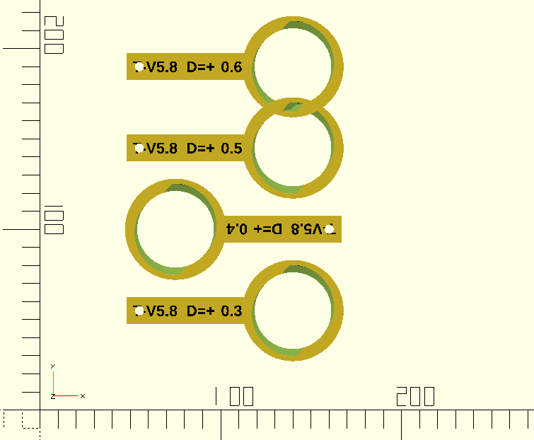

Greetings all;
Attempting to get a true/false in an if statement, I used the ( i % .2)
construct to cause a 180 degree rotation in order to fit more on the
printers plate. But its not working as expected. is the % supposed to
yield a remainder of a division?
This code works for i=.3 to .5 step .1
but fails for i=.3 to .6 or higher
module test_nuts() // will print the first 3 on the e5-s1
{  yofs=15;
for(i=[.30:.10:.50])
echo(184,i,(i % .20));
tsz=str(i);
echo(186,tsz);
yloc=(i-.3)*450;
if(i %
.20)translate([20,yofs+yloc-60,0])short_test_newnut(nozzle,3,tsz);
else
translate([195,yofs+yloc+140,0])rotate([0,0,180])short_test_newnut(nozzle,3,tsz);
test_nuts();
word wrap in tbird can't be turned off, the if/else are really just 2 lines.
from the log window:
ECHO: 184, 0.3, 0.1
ECHO: 184, 0.4, 0
ECHO: 184, 0.5, 0.1
but if I goto .60, it gets this
ECHO: 184, 0.6, 5.55112e-17 and from there on, where it s/b 0, its not.
Help, if there is any.
this is linux AppImage 2023.09.10.ai16125 (git dcaf25f0e)
Cheers, Gene Heskett.

You are correct, but floating point causes inaccuracy so 0.6%0.2 is not
exactly 0. You can either accept the error and do something like abs(x %
0.2) > c where c is a small constant, or used fixed-precision arithmetic
(basically multiply everything with a factor to make them integers).

The mathematics behind the % operation applies only to the set of
integers.  When applied to floating point numbers, things get weird.  And
small.
The decimal arithmetic remainder at the precision you specified in the data
would be what you expect, but the representation of the numbers as binary
fractions is more frequently rounded as many numbers we would expect to be
perfectly representable in 64 bits when converted to base 2 are an infinite
number of digits long.
0.1 is a famous example:
0.0001100110011001100110011001100110011001100110011001100110011001100110011001100110011001100110011001100110011001100110011001100110011001100110011001100110011001100110011001100110011001100110011001100110011001100110011001100110011001100110011001100110011001100110011001100110011001100110011001100110011001100110011001100110011001100110011001100110011001100110011001100110011001100110011001100110011001100110011001100110011001100110011001100110011001100110011001100110011001100110011001100110011
I could keep going, but you get the idea.  Definitely not representable in
64 bits.
Most fractions represented as decimals (0.1, 0.2, 0.3, 0.11, 3.14159 etc.)
are not exactly representable in 64 bits.  Floating point numbers should
be treated as approximations always.
After you perform a floating point operation on any number and convert it
back to decimal, you may or may not see the same number you expect.
It's that "feature" of floating point operations that causes small deltas
in any number produced by the FDM during stable flight.

I wouldn't say so.  mod(a,b) = a - floor(a/b)*b.  Behaves perfectly
sensibly for non-integers.
But I agree that Gene's problem is that many decimal fractions are
infinite repeating fractions in binary, and so cannot be represented
precisely.
In general, you can't do floating point arithmetic and expect exact
results.  It's very likely that you will get an error somewhere around
one part in 10^16 .
Similarly, in "for (i=[.30:.10:.50])" I wouldn't be surprised if you
didn't see 0.50.  I don't happen to remember how OpenSCAD does ranges,
but if it does them by adding up the increment it might end up with that
last one being 0.50000000001 and so past the end, or if it does it by
subtracting, dividing, flooring, and then counting and multiplying, it
might end up with the division saying there are 2.9999999999 steps and
flooring to 2.  (There would really be more zeroes and nines than that,
but I figured you'd get bored.)  I think it uses the
divide/count/multiply strategy.

The take home message here is that it's a mistake to use an equality test
with floating point numbers.  You always need to test something like
abs(x-y)<1e-15 or whatever threshold you like there if you want robust
behavior to check if x and y are equal floating point values.  (Note, the
correct threshold depends on the precision of the calculations that gave
rise to x and y but also the complexity of those calculations.  In a
complex calculation, round-off errors accumulate and so a larger threshold
would be appropriate.)
Ok, I've done that and it works up to a final target of .90 but fails
for target values of 1.0 and up.  So what I and going to do is use that
basic code and add an offset to the var i to make the rest of this up to
about 4.0. What I'm making is a gauge set, with the buttress thread
increasing from a starter value to that + the amount printed on the tab.
Screws vary because of sawing errors, bandsaws wander and are reduced in
diameter until the flat side of a 2x2 disappears. The variation can be
as much as a millimeter, maybe more. And it appears I need to size the
OD of the ring just to maintain solidarity to the print when the threads
grow. Is there a function that makes a numerical value from a string
"3.5". This will allow me to make the OD autosize according to the
thread size.  Or I could add i+d to the make nut call. Unexplored
territory for me. I'll probably get it, that's how I learn, by doing.
Thanks for the help, its appreciated.
Take care & stay well.

On 11/10/23 09:39, Chun Kit LAM via Discuss wrote: > You are correct, but floating point causes inaccuracy so 0.6%0.2 is not > exactly 0. You can either accept the error and do something like abs(x % > 0.2) > c where c is a small constant, or used fixed-precision arithmetic > (basically multiply everything with a factor to make them integers). > Ok, I've done that and it works up to a final target of .90 but fails for target values of 1.0 and up. So what I and going to do is use that basic code and add an offset to the var i to make the rest of this up to about 4.0. What I'm making is a gauge set, with the buttress thread increasing from a starter value to that + the amount printed on the tab. Screws vary because of sawing errors, bandsaws wander and are reduced in diameter until the flat side of a 2x2 disappears. The variation can be as much as a millimeter, maybe more. And it appears I need to size the OD of the ring just to maintain solidarity to the print when the threads grow. Is there a function that makes a numerical value from a string "3.5". This will allow me to make the OD autosize according to the thread size. Or I could add i+d to the make nut call. Unexplored territory for me. I'll probably get it, that's how I learn, by doing. Thanks for the help, its appreciated. Take care & stay well. > On 10/11/2023 22:34, gene heskett via Discuss wrote: >> Greetings all; >> >> Attempting to get a true/false in an if statement, I used the ( i % >> .2) construct to cause a 180 degree rotation in order to fit more on >> the printers plate. But its not working as expected. is the % supposed >> to yield a remainder of a division? >> >> This code works for i=.3 to .5 step .1 >> but fails for i=.3 to .6 or higher >> module test_nuts() // will print the first 3 on the e5-s1 >> {   yofs=15; >>     for(i=[.30:.10:.50]) >>     { >>         echo(184,i,(i % .20)); >>         tsz=str(i); >>         echo(186,tsz); >>         yloc=(i-.3)*450; >>         if(i % >> .20)translate([20,yofs+yloc-60,0])short_test_newnut(nozzle,3,tsz); >>         else >> translate([195,yofs+yloc+140,0])rotate([0,0,180])short_test_newnut(nozzle,3,tsz); >>     } >> } >> test_nuts(); >> >> word wrap in tbird can't be turned off, the if/else are really just 2 >> lines. >> from the log window: >> ECHO: 184, 0.3, 0.1 >> ECHO: 184, 0.4, 0 >> ECHO: 184, 0.5, 0.1 >> but if I goto .60, it gets this >> ECHO: 184, 0.6, 5.55112e-17 and from there on, where it s/b 0, its not. >> >> Help, if there is any. >> this is linux AppImage 2023.09.10.ai16125 (git dcaf25f0e) >> >> Cheers, Gene Heskett. >> >> _______________________________________________ >> OpenSCAD mailing list >> To unsubscribe send an email to discuss-leave@lists.openscad.org > _______________________________________________ > OpenSCAD mailing list > To unsubscribe send an email to discuss-leave@lists.openscad.org Cheers, Gene Heskett. -- "There are four boxes to be used in defense of liberty: soap, ballot, jury, and ammo. Please use in that order." -Ed Howdershelt (Author, 1940) If we desire respect for the law, we must first make the law respectable. - Louis D. Brandeis
Sat, Nov 11, 2023 4:12 AM
if accuracy up to 10 decimal points is acceptable, this should work in most
of the cases
function rnd(v,n)=round(v*10^n)/10^n;
function mod(a,b)=rnd(a-b*floor(rnd(a/b,10)),10);
echo(mod(.6,.2));

Sat, Nov 11, 2023 7:09 AM
correction (this takes care of sign of 'a' and 'b') :
// function to do rounding a number up to n decimal points
function mod(a,b)=rnd(a-sign(a)/sign(b)bfloor(rnd(abs(a/b),10)),10);
printed on the tab.
In openscad it might be better to just structure your loops with an
integer as a loop parameter if you want to do this kind of stuff.
So instead of:
for (x=[.10:.10:1.5])
for (y=[.15:.15:1.5]) {
if (x % .20) ...
you do:
for (ix=[1:1:15])
for (iy=[1:1:10]) {
x = ix * .10;
y = iy * .15
if (ix % 2) ...
