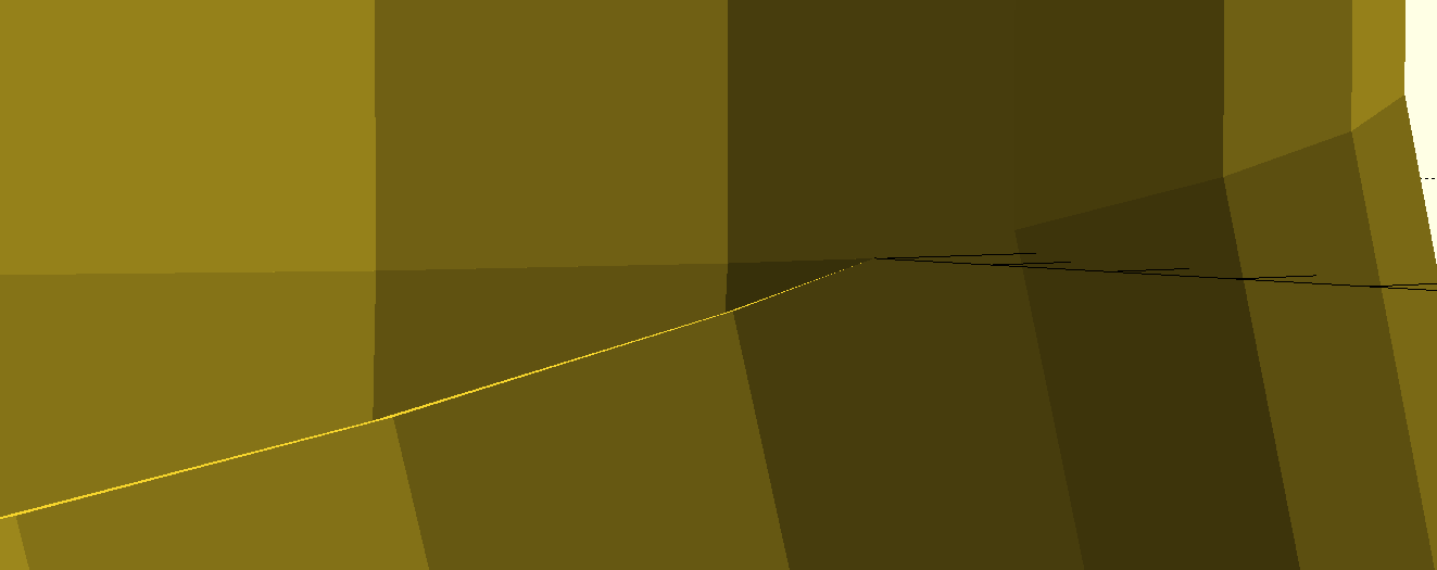

Fri, Apr 9, 2021 8:28 AM
That STL is badly broken.
http://forum.openscad.org/file/t359/Capture-td32604-bad-stl.jpg
Those white lines are holes, ie gaps in the 3D shell.
Multiple copies throws the error
Yes you need more than one to cause a union, that calls CGAL, checks the
geometry, it's bad, error.
That doesn't look like to many triangles, it is probably that badness
causing problems.

Fri, Apr 9, 2021 9:09 AM
That image was from Netfabb, it says it's bad 77 shells (ie discrete separate
parts) and 138 holes.
This is meshlab
http://forum.openscad.org/file/t359/Capture-td32604-bad-stl-meshlab.jpg
We can't help if you don't share the complete scad code.
