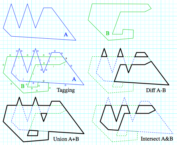

Roughly, boolean 2D geometry works as follows:
First, we have the concept of a region, which is a list of closed paths.  You are inside a region if you can draw a line from that point out to an arbitrarily distant outside point and you cross an odd number of the region paths.
A boolean operation like a union, difference, or intersection can be performed upon more than two regions at a time, but you can simplify them all to being successive operations on only two regions at a time. All boolean operations use a similar method to calculate:
  1. Split each region's paths up into path segments where they cross the paths of the other region.
  2. Tag each path segment of one region as being inside, outside, or coincident with the edge of the other region. Coincident segments come in two varieties, shared and unshared.  If a point infinitesimally to one side of the middle of the segment is inside both regions, then it is shared.  If it is only inside one, then it is unshared. This tagging is done for both regions separately.
  3. Filter the tagged path segments for the specific operation: (See image below.)
    a) union() needs the outside and shared segments from the first region, and the outside segments from the other.
    b) difference() needs the outside and unshared segments from the first region, and the inside segments from the other.
    c) intersection() needs the inside and unshared segments from the first region, and the inside segments from the other.
  4. Assemble all of the filtered segments from both regions into closed paths. There's some fiddly bits here where you assure the shortest closed paths by checking for path self-intersection as you assemble it, and put the trailing bits back into the segments pool.
  5. Calculate how many other paths that each resultant path is inside of.
  6. Sort the paths from most-outside to most inside. You now have the result region.
  • Revar
