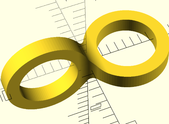

complex fillet
Sun, Dec 17, 2023 11:17 AM
difficult to make in openscad as per me.
[image: Screenshot 2023-12-17 at 4.25.16 PM.png]
file can be downloaded from here:
https://github.com/sprabhakar2006/openSCAD/blob/main/complex_fillet.scad
difficult to make in openscad as per me. [image: Screenshot 2023-12-17 at 4.25.16 PM.png] file can be downloaded from here: https://github.com/sprabhakar2006/openSCAD/blob/main/complex_fillet.scad
CK
Chun Kit LAM
Sun, Dec 17, 2023 12:12 PM
Interesting, this is indeed difficult to make and makes my firefox hang
when trying to view the github page, probably some weird css issue due
to long lines.
I got something much simpler but not as nice:
$fn = 100;
module part() {
translate([-9, 0, -5])
linear_extrude(10, convexity=10)
offset(-2) offset(2) union() {
translate([-2, -1]) square([12, 2]);
translate([14, 0]) circle(5);
translate([14, 0]) circle(3.5);
part();
rotate([90, 0, 180]) part();
No idea how to round the edges without using minkowski.
Best,
John

Btw how did you compute the coordinates? Is there a script that can
automatically compute fillet?

Sun, Dec 17, 2023 12:47 PM
Here is the python code to compute in case you are interested (you need to
download "openscad1.py" file from the github page and need to keep in the
same folder):
from openscad1 import *
c1=circle(20)
c2=circle(5,[25,0])
f_1=two_cir_tarc(c1,c2,10)
f_2=two_cir_tarc(c1,c2,10,1)
p0,p1,p2,p3,p4,p5=f_1[0],f_1[-1],[60,-5],[60,5],f_2[0],f_2[-1]
sec=[p3]+arc_2p(p4,p5,10,1)+arc_long_2p(p5,p0,20,-1,s=50)+arc_2p(p0,p1,10,1)+[p2]
sec=remove_extra_points(array(sec).round(5))
sec=equidistant_path(sec,1000)
sol=slice_sol(translate([0,0,-21],linear_extrude(sec,42)),2)
sol1=translate([40-.1,0,0],q_rot(['x90','z180'],sol))
ip_1=ip_sol2sol(sol1,sol)
ip_a=[p[0] for p in ip_1]
ip_b=[p[-1] for p in ip_1]
ip_c=ip_a+flip(ip_b)
f_1=i_line_fillet(sol,sol1,ip_c,-2,2)
f_1=cpo(f_1)[:-1]
f_1=[equidistant_pathc(p,400)  for p in f_1]
f_2=surface_offset(f_1,4)
sol3=swp_prism_h(f_2,f_1)
sol4=o_solid([0,0,1],circle(15),20,-10)
sol5=o_solid([0,1,0],circle(15),20,-10,40,0)
with open('trial.scad','w+')as f:
f.write(f'''
difference(){{
intersection(){{
{swp(sol)}
{swp(sol1)}
{swp_c(sol3)}
{swp(sol4)}
{swp(sol5)}
Apart from that in case you want to learn all the functions I wrote. You
can download this pdf file:
https://github.com/sprabhakar2006/openSCAD/blob/main/explanation%20of%20approaches/examples_of_various_functions.pdf

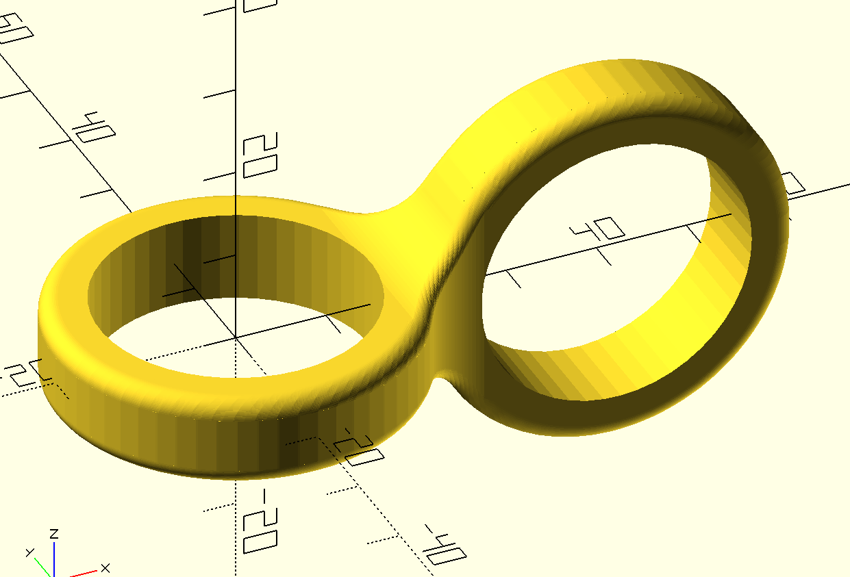

Few months back I circulated an approach to create fillets.
That is the process used here as well.
I personally feel this can be used in pure openscad.
What is required is a method to compute intersection points between 2
solids or surfaces.
When you have these intersection lines, these could be manipulated to get
the fillets.
Although this may not work in 100% of the cases, but will work in most of
the complex cases.
Here you can download the explanation:
https://github.com/sprabhakar2006/openSCAD/blob/main/explanation%20of%20approaches/explanation%20of%20creating%20fillet.pdf

The version of OpenSCAD being used here has Python enabled w/in it, so can do rendering from Python files, or working from Python commands/data structures:
http://pythonscad.org/
There is work on-going to integrate it into OpenSCAD directly:
https://github.com/openscad/openscad/issues/4880
and for folks who aren't good at Python, it is workable to just use it as a project warrants --- for example in the work I have been doing:
