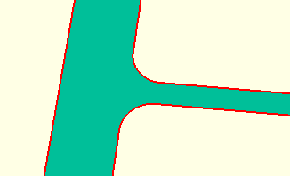

I'm using the SVG export capability of OpenSCAD to create laser-cuttable
objects (attached as an STL file - I don't know how to export anything more
useful for troubleshooting this issue).
My workflow looks like this.  I create a model that is similar to a cut
sheet of acrylic for visualization purposes.  Then I take a projection of
the object:
            projection(cut = false)
            keyguard();
I render the result and then perform a File > Export as SVG.    The
resulting SVG file is used to perform the laser cutting step.  This has
normally worked well for me.
Then I ran into a problem with unexpected lines appearing in the SVG file
(attached).  There are no indications of a problem after the projection is
made, but here's what it looks like after the Render step:
Those lines are followed by the laser cutter which severs the rail
separating the openings.
If I move the upper opening 0.1 mm more to the right, the issue goes away.
I have no idea why this would work - it seems totally arbitrary.
Do you have any idea why this is happening and what I can do to prevent it
in the future?
Thanks,
Ken

@khackbarth, maybe you can make a small example code that demonstrates this
(both before and after the change).  It will allow people to one day test
it.

This method seems excessively complicated to me.  Why not draw what you want cut with 2D shapes?  Are you attempting to both engrave and cut?  In that case, I would make 2 shapes and export them separately so you can get different colors for the laser to know what to cut and what to engrave.  If you aren't projecting, then I don't think you'll get those extra lines.
Lenore

This method seems excessively complicated to me. Why not draw what you want cut with 2D shapes? Are you attempting to both engrave and cut? In that case, I would make 2 shapes and export them separately so you can get different colors for the laser to know what to cut and what to engrave. If you aren't projecting, then I don't think you'll get those extra lines. Lenore > On Oct 26, 2024, at 23:19, khackbarth via Discuss <discuss@lists.openscad.org> wrote: > > I’m using the SVG export capability of OpenSCAD to create laser-cuttable objects (attached as an STL file – I don’t know how to export anything more useful for troubleshooting this issue). > > My workflow looks like this. I create a model that is similar to a cut sheet of acrylic for visualization purposes. Then I take a projection of the object: > projection(cut = false) > keyguard(); > > I render the result and then perform a File > Export as SVG. The resulting SVG file is used to perform the laser cutting step. This has normally worked well for me. > > Then I ran into a problem with unexpected lines appearing in the SVG file (attached). There are no indications of a problem after the projection is made, but here’s what it looks like after the Render step: > <image001.png> > > Those lines are followed by the laser cutter which severs the rail separating the openings. > > If I move the upper opening 0.1 mm more to the right, the issue goes away. > <image002.png> > > I have no idea why this would work – it seems totally arbitrary. > > Do you have any idea why this is happening and what I can do to prevent it in the future? > > Thanks, > Ken > > > <extra lines.svg><STL version.stl><extra lines gone.svg>_______________________________________________ > OpenSCAD mailing list > To unsubscribe send an email to discuss-leave@lists.openscad.org <mailto:discuss-leave@lists.openscad.org>
K
ken@volksswitch.org
Sun, Oct 27, 2024 3:04 PM
That’s an interesting idea.  It’s just me being lazy – kind of.  99.9% of the time the object will be 3D-printed.  This approach is my way to support laser-cutting as well with the least amount of new code.
But that raises the question – why would projecting result in these extra lines unless there’s an issue with the projection function.  Right?
Ken

I’ll see what I can do.  This is a large base of code that I’ll need to parse through and remove all irrelevant code.
Ken

@ken, yea.  Writing good test harnesses and examples can be more work than
the original project.  From personal experience, I will tell you that
having a small bit of code that I can run and rerun when debugging can
easily make the difference from me (or someone else) picking it up and
poking at it in a spare hour, than the daunting prospect of weeding through
1,000's of lines of code and trying to debug.
Best of luck!

I did some more testing just by simplifying the inputs (not the code) and I can tell you that the results are very unstable - introducing a shape somewhere else or changing the radius of a corner can have profound differences in where lines appear and their number.  I do see one fundamental difference.  The issue only shows up when the object has curved elements (i.e., radii on corners) somewhere.
My gut tells me that it is going to be a huge job to create a minimal test harness at this point.  I think it will be a better use of my time and better for the future of my program to take Lenore’s advice and abandon the projection command (which I think is flawed) all together by building a model comprised directly of 2D shapes when a laser-cut design is requested rather than a 3D-printed version.  My program builds most things from extruded 2D shapes anyway.
Thanks,
Ken
            keyguard();
Thanks,
Ken
