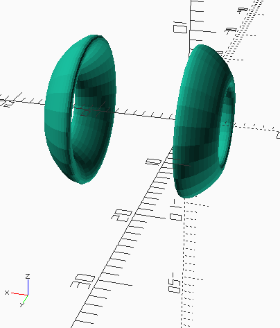

A newbie is here.  I created this little program below, which works.  Some
parameters are not shown, their value is some real numbers.  However when I
uncomment the commented out 3 lines and put in the needed '}', then it does
not work.  F5 does not give any message, but does not draw the
airdirector().  F6 report errors:
"The given mesh is not closed! Unable to convert to CGAL_Nef+Polyhedron.
and then it also does not draw the airdiryctor()
I do not want it as a solid.  I wanted to hollow it out.  That is why I
create the difference of tho ellipses.  Why it is a not supported operation?
Any good tip how I can achieve what I want?  Any tip how I can copy and
paste from the error log?  I am using a Mac wit Catalina and OpenSCAD is the
latest stabil version.
codiamo = 16;
codiami = 6;
// Parameters of the airdirector
aidelpsl = codiamo;  //longer axis of the ellipse
aidelpss = codiami;    //shorter axis of the ellipse
aidthick = 0.2;    //Thickness of the airdirector
// Module of the airdirector
module airdirector(){
translate([-2.3,0,0])
rotate([0,90,0])
rotate_extrude(convexity=10)
translate([aidelpsl/2-1.8,0,0])
rotate(45)
/* difference(){
resize([aidelpsl/3,aidelpss/3]);
circle(r=(aidelpsl-aidelpss)); */
resize([(aidelpsl-aidthick)/3,(aidelpss-aidthick)/3])
// Draw the airdirectors
color("Teal",0.5) render()
translate([pairdirector1,0,0])
airdirector();
translate([pairdirector2,0,0])
mirror([1,0,0])
airdirector();

Maybe I'm missing it, but I don't see the closing brace for the difference.

He explained that, Difference is commented out.
But I don't see the closing brace for module airdirector
rotate([0,90,0])
rotate(45)
resize([aidelpsl/3,aidelpss/3])  // <== removed semi-colon

Any tip how I can copy and paste from the error log?
Those error are also in the console, where you can drag-select/right-click(whatever the Mac thing
is)/copy.

pairdirector1 and pairdirector2 are not defined. If I give them values of 0
and 10 I get no errors and it draws this:
What values are you using?

pairdirector1 and pairdirector2 are not defined. If I give them values of 0 and 10 I get no errors and it draws this: [image: image.png] What values are you using? On Thu, 18 Mar 2021 at 10:46, Baerdric via Discuss < discuss@lists.openscad.org> wrote: > Ah, sorry. I'll keep it to myself going forward. > > > Sent with ProtonMail Secure Email. > > ‐‐‐‐‐‐‐ Original Message ‐‐‐‐‐‐‐ > On Thursday, March 18, 2021 1:01 AM, Lee A <683lee@337lee.com> wrote: > > > He explained that, Difference is commented out. > > But I don't see the closing brace for module airdirector > > > > On 3/17/2021 11:52 PM, Baerdric via Discuss wrote: > > > > > Maybe I'm missing it, but I don't see the closing brace for the > > > difference. > > > Sent with ProtonMail https://protonmail.com Secure Email. > > > ‐‐‐‐‐‐‐ Original Message ‐‐‐‐‐‐‐ > > > On Thursday, March 18, 2021 12:49 AM, infocean via Discuss > > > discuss@lists.openscad.org wrote: > > > > > > > Hi, > > > > A newbie is here. I created this little program below, which works. > > > > Some parameters are not shown, their value is some real numbers. > > > > However when I uncomment the commented out 3 lines and put in the > > > > needed '}', then it does not work. F5 does not give any message, but > > > > does not draw the airdirector(). F6 report errors: > > > > "The given mesh is not closed! Unable to convert to > CGAL_Nef+Polyhedron. > > > > "The given mesh is not closed! Unable to convert to > CGAL_Nef+Polyhedron. > > > > and then it also does not draw the airdiryctor() > > > > I do not want it as a solid. I wanted to hollow it out. That is why > > > > I create the difference of tho ellipses. Why it is a not supported > > > > operation? Any good tip how I can achieve what I want? Any tip how > > > > I can copy and paste from the error log? I am using a Mac wit > > > > Catalina and OpenSCAD is the latest stabil version. > > > > codiamo = 16; > > > > codiami = 6; > > > > // Parameters of the airdirector > > > > aidelpsl = codiamo; //longer axis of the ellipse > > > > aidelpss = codiami; //shorter axis of the ellipse > > > > aidthick = 0.2; //Thickness of the airdirector > > > > // Module of the airdirector > > > > module airdirector(){ > > > > translate([-2.3,0,0]) > > > > rotate([0,90,0]) > > > > rotate_extrude(convexity=10) > > > > translate([aidelpsl/2-1.8,0,0]) > > > > rotate(45) > > > > /* difference(){ > > > > resize([aidelpsl/3,aidelpss/3]); > > > > circle(r=(aidelpsl-aidelpss)); */ > > > > resize([(aidelpsl-aidthick)/3,(aidelpss-aidthick)/3]) > > > > circle(r=(aidelpsl-aidelpss)); > > > > // Draw the airdirectors > > > > color("Teal",0.5) render() > > > > translate([pairdirector1,0,0]) > > > > airdirector(); > > > > color("Teal",0.5) render() > > > > translate([pairdirector2,0,0]) > > > > mirror([1,0,0]) > > > > airdirector(); > > > > > > > > Sent from the OpenSCAD mailing list archive > > > > http://forum.openscad.org/ at Nabble.com. > > > > > > OpenSCAD mailing list > > > To unsubscribe send an email to discuss-leave@lists.openscad.org > > > > OpenSCAD mailing list > > To unsubscribe send an email to discuss-leave@lists.openscad.org > > _______________________________________________ > OpenSCAD mailing list > To unsubscribe send an email to discuss-leave@lists.openscad.org >
