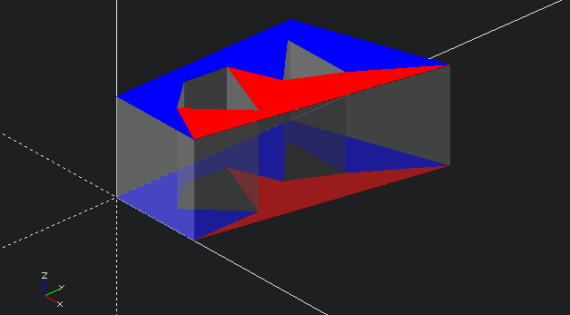

It is possible to manipulate the initial runsun model in such way the
polyhedron is acceptable by CGAL and faces with hole do not need to be
triangulated. If enough well placed bridges are added (the number of holes
plus one) a polygon with holes is split in two polygons meeting at the
bridges. The following example, based on the runsun model, illustrates the
principle.
pts = [[0, 0, 0], [0, 4, 0], [3, 5, 0], [2, 0, 0],
[0, 0, 2], [0, 4, 2], [3, 5, 2], [2, 0, 2],
[1, 0.5, 0], [0.4, 1.2, 0], [0.5, 2.1, 0], [2, 1.5, 0],
[1, 0.5, 2], [0.4, 1.2, 2], [0.5, 2.1, 2], [2, 1.5, 2],
[1.5, 2.5, 0], [0.5, 3.5, 0], [2, 3.5, 0],
[1.5, 2.5, 2], [0.5, 3.5, 2], [2, 3.5, 2]];
faces = [[7, 4, 5, 6, 21, 20, 19, 14, 13, 12],  // top blue
[7, 12, 15, 14, 19, 21, 6],            // top red
[3, 2, 18, 16, 10, 11],                // bottom red
[2, 1, 0, 3, 11, 8, 9, 10, 16, 17, 18], // bottom blue
[0, 1, 5, 4], [1, 2, 6, 5], [2, 3, 7, 6],
[3, 0, 4, 7], [9, 8, 12, 13], [10, 9, 13, 14],
[11, 10, 14, 15], [8, 11, 15, 12], [17, 16, 19, 20],
[18, 17, 20, 21], [16, 18, 21, 19]];
The following image of the polyhedron(pts, faces) enhances the top and
bottom partition:
[image: polyWithHoles.PNG]
Intentionally the top and bottom partitions are differents. Note that each
of the faces with holes has 3 bridges that are common to the two polygons
of the partition.

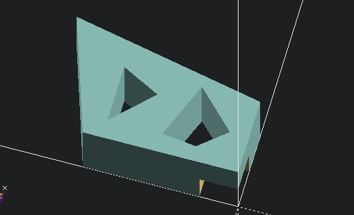

The image bellow shows the render of difference between the polyhedron and
a cube.
[image: polyRendered.PNG]

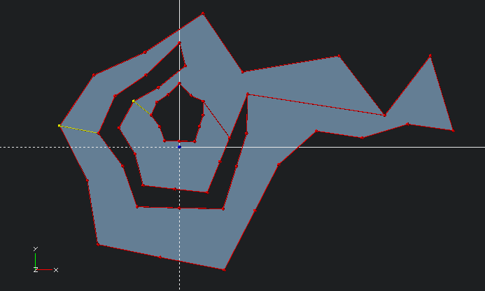

In the picture bellow, the main polygon border is white. There are 3 holes,
filled by the colors green, red and blue. One possible set of bridges to
subdivide the polygon in simple polygons are represented in yellow.
[image: spiraledHoles.PNG]
The polygon partition has 6 parts. It is possible to add a fourth spiraled
hole squeezed between all previous holes that will require to double the
number of bridges and will produce the double of parts in the partition.
And so on...
