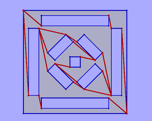

Parkinbot rudolf@digitaldocument.de wrote:
Ronaldo wrote
A bipartition with m+1 bridges is assured when the main polygon
and the holes are convex.
I doubt that, see this arrangement
http://forum.openscad.org/file/t887/bis.png
Of course, some n-partion (or a triangulation in the limit) can be found.
You are right. Nice counterexample. My present code was successful in
finding a partition:
[image: RudolfExample.PNG]
A total of 2.m bridges (for m holes) was found by my partition code but 4
bridges might be discarded in that solution. There are 10 polygons in the
partition and it seems that a minimal partition would have 6 parts. A
partition in triangles would require something as 37 bridges.
Although it is conceptually simple the algorithm is showing to be hard to
code and debug. Harder seems to prove that it works! :(

Mon, Jan 21, 2019 10:54 AM
Ronaldo wrote
There are 10 polygons in the partition and it seems that a minimal
The example has a bipartion.
Ronaldo wrote > There are 10 polygons in the partition and it seems that a minimal > partition would have 6 parts. The example has a bipartion. -- Sent from: http://forum.openscad.org/
Mon, Jan 21, 2019 4:45 PM
Yes, you are right: the solution of an Eulerian cycle through all possible
bridges. It will require m+1 bridges for m holes.
Yes, you are right: the solution of an Eulerian cycle through all possible bridges. It will require m+1 bridges for m holes.

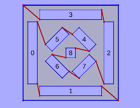

I cannot assure it is always possible but I could find a bipartition of
Parkinbot's convex hole case by judiciously deleting bridges found by my
present code.
[image: biPartition.PNG]
Interestingly, the symmetry of the polygon with holes is somewhat reflected
in two congruent parts.

Parkinbot wrote
The example has a bipartition.
Sorry I didn't finish this post for some reason. I wanted to write that the
example has a bipartition (many indeed), but I doubt that the algorithm will
find it, unless it uses a backtracking scheme.
