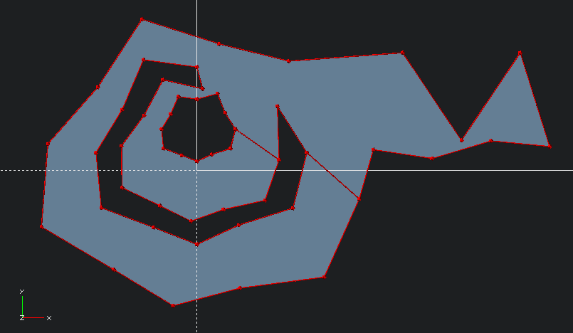

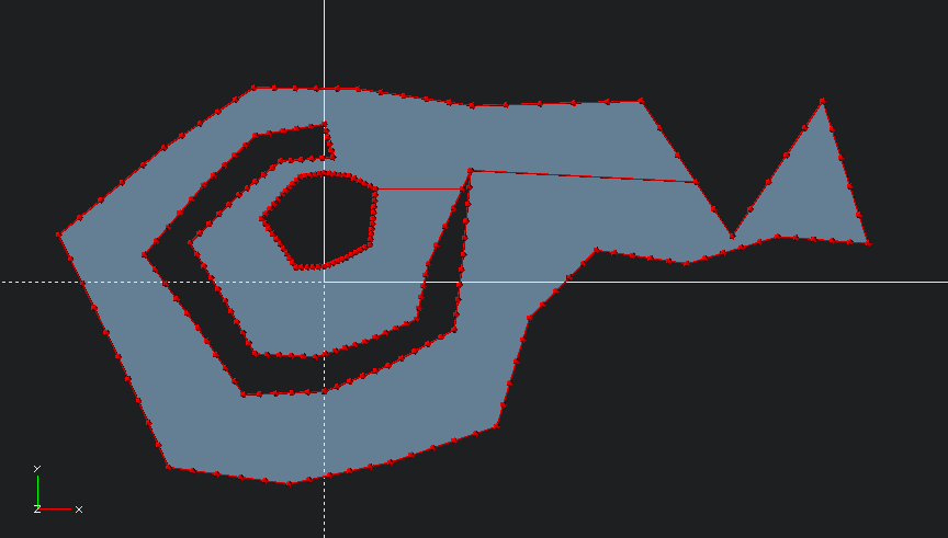

The earcut method works fine with polygons with holes expressed as a unique
polygonal by bridging the holes and outer polygon by two-way bridges fully
inside the polygon interior. We just need to relax the ear test by
restricting it to the candidate ear interior. I have tested it with my
implementation of the ear method and it worked like a charm.
The remaining problem is to find the two-way bridges that connect all the
borders. The bridges in the runsun example are not allowed because they
cross other polygonal edges. I have found a paper (
https://www.geometrictools.com/Documentation/TriangulationByEarClipping.pdf)
that proposes a method to find those bridges. I have implemented the method
with good results. Here are two of them:
[image: PolyHoles2.PNG]
[image: PolyHoles1.PNG]
Find attached my implementation of the bridging method.
