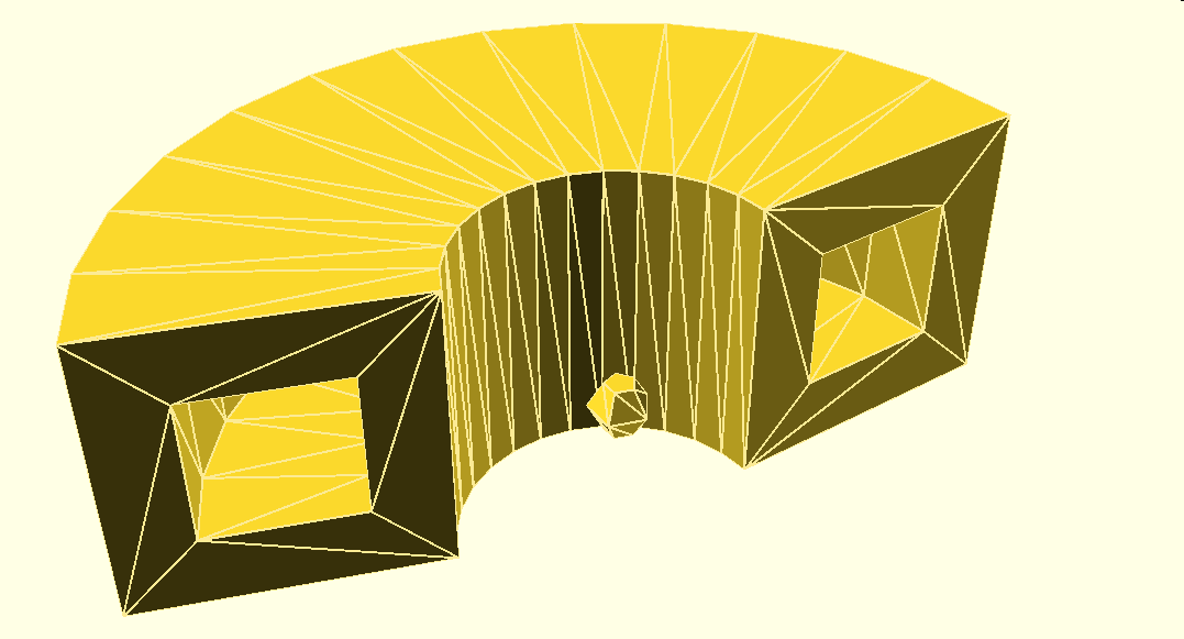

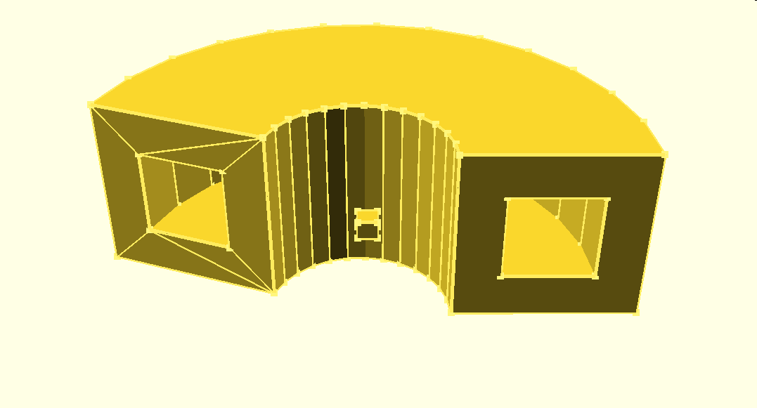

nophead wrote > It nearly can with the keyhole method but they are not acceptable to CGAL > in that format > as they are not manifold. Simply removing the connections between loops > and > ensuring the correct winding order should fix that. This would imply that linear_extrude will not have to recourse to a tesselation for F5. There is a lot change of involved. -- Sent from: http://forum.openscad.org/
Mon, Dec 17, 2018 1:00 PM
see what happens to an almost planar face created by an rotate_extrude.
http://forum.openscad.org/file/t887/rot.png
rotate_extrude(angle = 160)
translate([10, 0])
square(10, center = true);
square(5, center = true);
cube(1);
see what happens to an almost planar face created by an rotate_extrude. <http://forum.openscad.org/file/t887/rot.png> rotate_extrude(angle = 160) { translate([10, 0]) difference() { square(10, center = true); square(5, center = true); } } cube(1); -- Sent from: http://forum.openscad.org/
Mon, Dec 17, 2018 2:01 PM

Mon, Dec 17, 2018 2:08 PM
Oddly F5 triangulates everything except the sqquare faces of the cube. I
noticed with a sphere F5 does everything except the polar caps, they remain
polygons, wierd!

Mon, Dec 17, 2018 2:51 PM
CGAL anyway tesselates and retesselates faces on its will. linear_extrude()
and rotate_extrude() obviously don't use more complex faces respectively use
tesselation. Even sphere and cylinder at least for cones (r1, r2) construct
their faces mostly with triags and not with quads. What, beside a bunch of
options for implementation changes, would you gain by improving polyhedron()
to accept this kind of polygons with holes?
