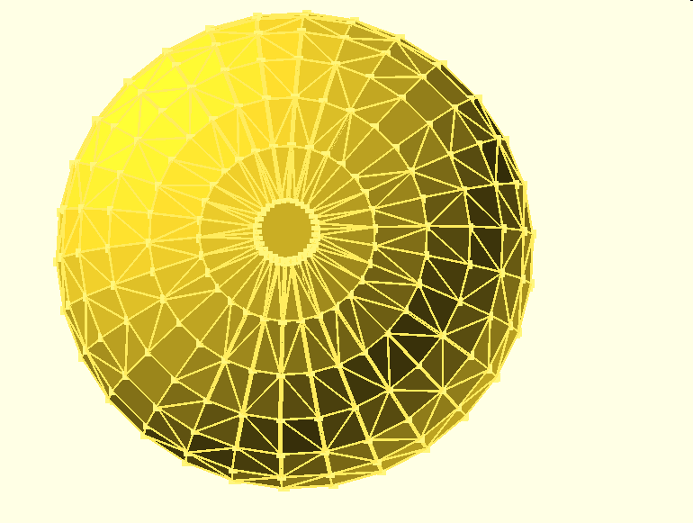

I meant that I can see that F5 tessellates a polygon with holes for use with
linear_extrude and we could use the underlying functionality to provide a
function that tesselates a 2D polygon given as list.
Btw, I see a F5 tesselation but not a F6 tesselation for
sphere(10);
Maybe OpenSCAD just doesn't display it?
sphere(10);
It looks like it is only displayed when a boolean operation is involved
translate([20, 0, 0])
cube(5);
sphere(10);
Parkinbot wrote > Btw, I see a F5 tesselation but not a F6 tesselation for > > sphere(10); > > Maybe OpenSCAD just doesn't display it? It looks like it is only displayed when a boolean operation is involved translate([20, 0, 0]) cube(5); sphere(10); -- Sent from: http://forum.openscad.org/
Mon, Dec 17, 2018 12:05 AM
If you just have sphere(10) without any CSG ops CGAL is not involved.
OpenScad has its own 3D representation and when that is displayed show
edges does not work.
If you add a unit cube then CGAL generates the union and the final result
is then a CGAL object and show edges works.
It is mostly tesselated with triangles but there are some quads and
polgonal poles. Wierd, but that is probably just how it is constructed, not
by using a tessalator.
When you do F5 the tessalation is totally different. I think OpenCSG
tesselates everything to triangles when it displayes.

Ronaldo had noticed it some time ago that CGAL changes tesselation on its own
will.
I created a cube by means of sweep(). So I am sure that it is tesselated in
triags. See how it is displayed by F6 with a unit cube unioned.
http://forum.openscad.org/file/t887/sweep.png
Ronaldo had noticed it some time ago that CGAL changes tesselation on its own will. I created a cube by means of sweep(). So I am sure that it is tesselated in triags. See how it is displayed by F6 with a unit cube unioned. <http://forum.openscad.org/file/t887/sweep.png> -- Sent from: http://forum.openscad.org/
Mon, Dec 17, 2018 12:28 AM
Looks like CGAL de-tesselates triangles in the same plane to make pologons.
That makes it hard to know what the internal representation of anything is.
It used to always be CGAL nef_polyhreda I think but now it switches back
and forth to polysets. When the result is a polyset you don't get all the
vertex / edge info and show edges does not work. Also I think it switches
from rationals to doubles for the vertices.

Clearly, CGAL is only called when a Boolean operation is present. Thus the
polyset to nef_polyhreda conversion is not necessary for primitives like a
polyhedron and can't be displayed.
When CGAL is called, it seems to try to reduce faces.
Nevertheless there is a tesselation of polygon with holes for F5 and this
one could be exposed to the user.
Clearly, CGAL is only called when a Boolean operation is present. Thus the polyset to nef_polyhreda conversion is not necessary for primitives like a polyhedron and can't be displayed. When CGAL is called, it seems to try to reduce faces. Nevertheless there is a tesselation of polygon with holes for F5 and this one could be exposed to the user. -- Sent from: http://forum.openscad.org/
