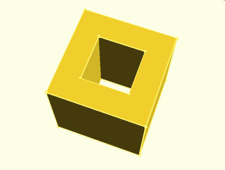

Since the following code is accepted by CGAL
pts =  [[0, 0], [6, 0], [6, 5], [0, 5], [0, 0], [2, 1], [5, 2], [3, 4], [2,
1]];
linear_extrude(2)
polygon(pts);
cube(1);
and obviously uses triangulation
http://forum.openscad.org/file/t887/hole.png
it shouldn't be too difficult to provide a built-in triangulate2D() function
that uses clipper and returns a [verts, triags] list.
vertsfaceslist = triangulate2D(pts);  // builtin call using clipper
returning a [verts, triags] list
// ... use vertsfaceslist
the prototype could be:
function triangulate2D(polygon, z=undef) = ...
If provided z would add the given value as z coordinate to the verts (vec3
conversion) for intended polyhedron usage. Doesn't this sound like a nice
feature request?

Sun, Dec 16, 2018 9:21 PM
What makes you think that? It is definitely tesilated with F5
But not with F6, unless it hides it better.
On Sun, 16 Dec 2018 at 21:08, Parkinbot rudolf@digitaldocument.de wrote:

Sun, Dec 16, 2018 9:26 PM
Save it to STL or any other format requiring triangles.
On 2018-12-16 22:21, nop head wrote: > What makes you think that? It is definitely tesilated with F5 > > But not with F6, unless it hides it better. > Save it to STL or any other format requiring triangles. Carsten Arnholm
Sun, Dec 16, 2018 9:36 PM
Yes but I beleive CGAL objects get tesilated when they are converted to
STL. The can have single facets that are pologons. They aren't triangle
meshes.
