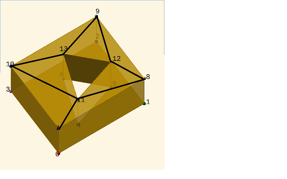

I wanna make some tube-like shape with irregular sides, similar like one
below:
http://forum.openscad.org/file/n13813/20150914_irregular_tube_by_extrude.png
This is made with a polygon + linear_extrude out of
pts_out =  [ [0,0],[6,0],[6,5],[0,5] ];
pts_in =  [ [2,1],[5,2], [3,4]];
To make a polyhedron, I convert pts to 3D:
pts =  [[0, 0, 0], [6, 0, 0], [6, 5, 0], [0, 5, 0], [2, 1, 0], [5, 2, 0],
[3, 4, 0], [0, 0, 3], [6, 0, 3], [6, 5, 3], [0, 5, 3], [2, 1, 3], [5, 2,
3], [3, 4, 3]];
Their indices are placed on the extruded shape as follow:
http://forum.openscad.org/file/n13813/150914_irregular_tube_marked.png
I tried several combinations of faces but couldn't get a polyhedron. Here
are two tries:
faces1= [[0, 7, 8, 1], [1, 8, 9, 2], [2, 9, 10, 3], [3, 10, 7, 0], [4, 5,
12, 11], [5, 6, 13, 12], [6, 4, 11, 13], [0, 1, 2, 3], [4, 5, 6], [7, 8,
9, 10], [11, 12, 13]];
polyhedron( points = pts, faces = faces1  );
faces2 = [[0, 7, 8, 1], [1, 8, 9, 2], [2, 9, 10, 3], [3, 10, 7, 0], [4, 5,
12, 11], [5, 6, 13, 12], [6, 4, 11, 13], [0, 1, 2, 3, 4, 5, 6], [7, 8, 9,
10, 11, 12, 13]];
color(undef,0.8)
polyhedron( points = pts , faces = faces2 );

​I guess you need to tesselate the face properly.

polyhedron() cannot do "faces with holes" currently as far as i know.
However there is a work-around. It is called the Keyhole Polygon...
Basically you take any polygon with a single hole... and pretend you
slice a knife down from the outside of the polygon, straight down, until
you cut into the hole. What you end up with is a single polygon without
any holes. Here is a picture
https://sozvyezdami.files.wordpress.com/2013/04/11.png?w=640
The caveat that the new edges you create by cutting will be coincident
with each other.... and the 'points' or 'nodes' of those new edges will
also be coincident, which can be a problem for some polygon processing
algorithms. However it appears to work on your basic example in
OpenSCAD. Here is your code rewritten to have two 'keyhole' polygons on
top and bottom.
0],
3], [3, 4, 3]];
[4, 5,12, 11], [5, 6, 13, 12], [6, 4, 11, 13],
[0, 1, 2, 3, 4, 6, 5, 4, 3],
[10, 9, 8, 7, 11, 12, 13, 11, 7]];
Also i had to re-order some of the vertices, as viewable in
'View/ThrownTogether' mode within OpenSCAD to make sure there were no
naughty purples. Hope this helps!

[1, 0.5, 2], [0.4, 1.2, 2], [0.5, 2.1, 2], [2, 1.5, 2], [1.5, 2.5, 0], [0.5,
3.5, 0], [2, 3.5, 0], [1.5, 2.5, 2], [0.5, 3.5, 2], [2, 3.5, 2]];faces =
[[4, 5, 6, 7, 4, 15, 14, 13, 12, 15, 4, 21, 20, 19, 21], [3, 2, 1, 0, 3, 8,
9, 10, 11, 8, 3, 16, 17, 18, 16], [0, 1, 5, 4], [1, 2, 6, 5], [2, 3, 7, 6],
[3, 0, 4, 7], [9, 8, 12, 13], [10, 9, 13, 14], [11, 10, 14, 15], [8, 11, 15,
12], [17, 16, 19, 20], [18, 17, 20, 21], [16, 18, 21,
19]];polyhedron(pts,faces);
http://forum.openscad.org/file/t602/20181209_runsun_multi_hole_surface_1.png
In this case, the top face uses pts[4] as the starting point to cut into the
two holes:
[ 4, 5, 6, 7, 4, 15, 14, 13, 12, 15, 4, 21, 20, 19, 21]
as shown in this figure:
http://forum.openscad.org/file/t602/20181209_runsun_multi_hole_surface_2.png
What surprises me is that the 2 cut lines, 4~15 and 4~21,  go across the
entire holes.Is this normal?
It seems that this approach works in more holes, too:
pts = [[0, 0, 0], [0, 4, 0], [3, 5, 0], [2, 0, 0], [0, 0, 1], [0, 4, 1], [3,
5, 1], [2, 0, 1], [1, 0.5, 0], [0.4, 1.2, 0], [2, 1.5, 0], [1, 0.5, 1],
[0.4, 1.2, 1], [2, 1.5, 1], [0.5, 1.8, 0], [0.5, 2.1, 0], [1.8, 2.2, 0],
[1.5, 2, 0], [0.5, 1.8, 1], [0.5, 2.1, 1], [1.8, 2.2, 1], [1.5, 2, 1], [1,
2.75, 0], [0.5, 3.5, 0], [2, 3.5, 0], [1, 2.75, 1], [0.5, 3.5, 1], [2, 3.5,
1]];faces = [[4, 5, 6, 7, 4, 13, 12, 11, 13, 4, 21, 20, 19, 18, 21, 4, 27,
26, 25, 27], [3, 2, 1, 0, 3, 8, 9, 10, 8, 3, 14, 15, 16, 17, 14, 3, 22, 23,
24, 22], [0, 1, 5, 4], [1, 2, 6, 5], [2, 3, 7, 6], [3, 0, 4, 7], [9, 8, 11,
12], [10, 9, 12, 13], [8, 10, 13, 11], [15, 14, 18, 19], [16, 15, 19, 20],
[17, 16, 20, 21], [14, 17, 21, 18], [23, 22, 25, 26], [24, 23, 26, 27], [22,
24, 27, 25]];polyhedron(pts,faces);
http://forum.openscad.org/file/t602/20181209_runsun_multi_hole_surface_3.png
The top face:
[ 4, 5, 6, 7, 4, 13, 12, 11, 13, 4, 21, 20, 19, 18, 21, 4, 27, 26, 25, 27]
I'd like to know what you experts think about this.
